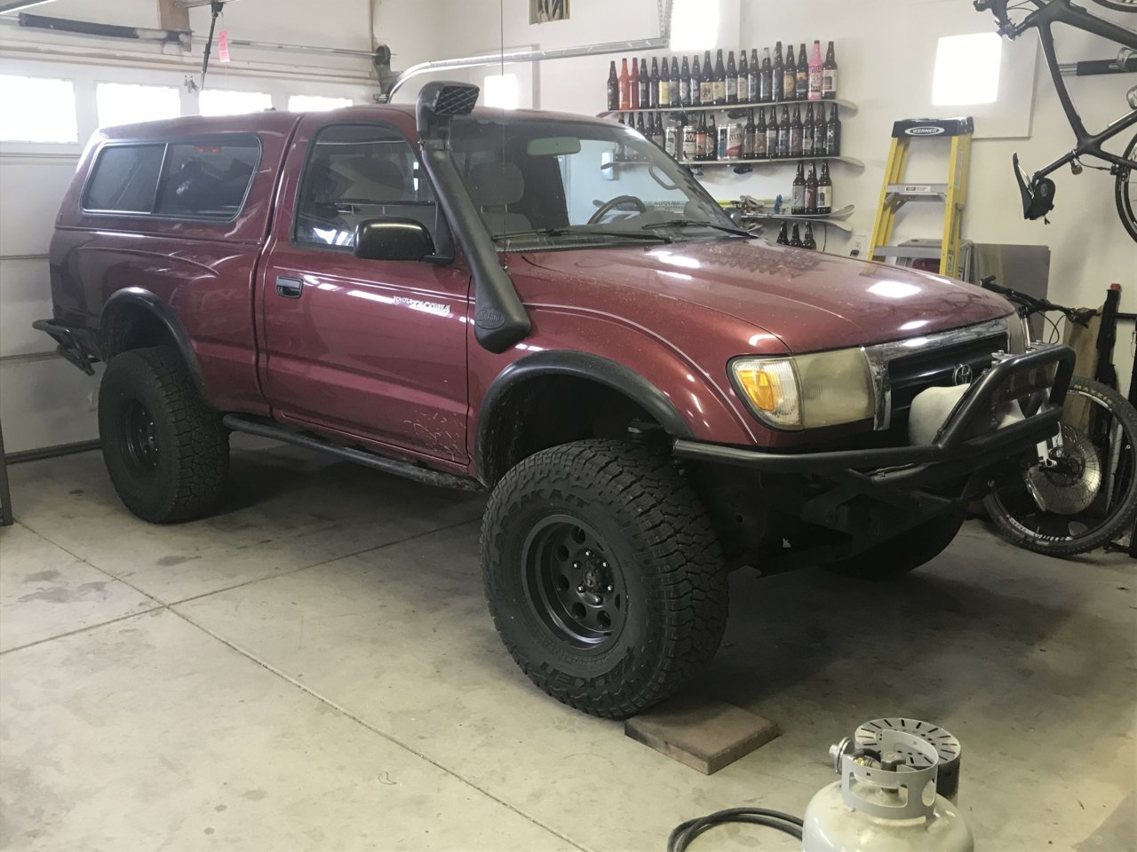

    I sold my Turbo'd Ext cab 2000 Tacoma to buy this single cab. It has been very well taken care of and very modded by the previous owner, another member on here. I'm mostly just doing some things to it to make it my own and functional for what I have in mind.
    I'm mostly doing this thread to provide information for others that may want to do similar things to their trucks. Like many of us know, searching for info and pics can sometimes be a PIA so hopefully some of what I post in this thread will be helpful to a few people out there.
    Below are the mods that were already on the truck when I bought it. There are probably more as Evan (PO) put in a ton of work to this truck.
    I'll try to catch up with some of the things I've done so far. Hopefully I can keep it more up to date after that.
    Highlighted in Green are the things that I've added/swapped out since I've had the truck.

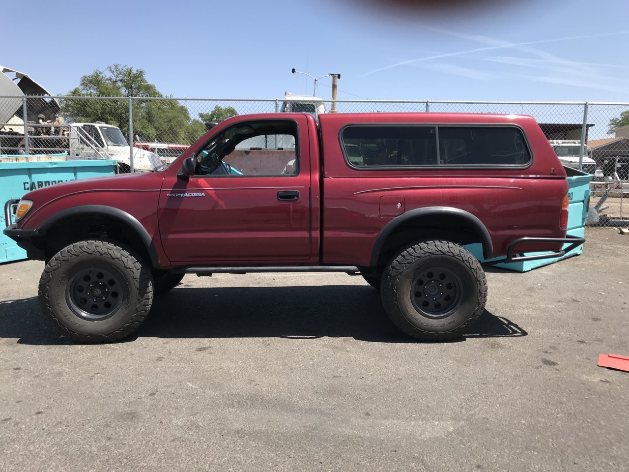

    Current Pic:

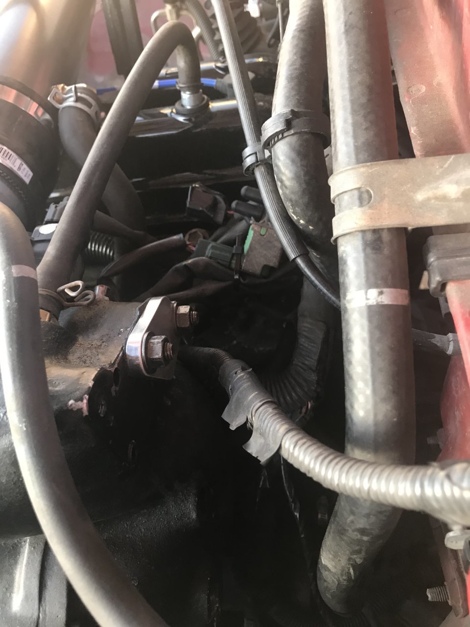

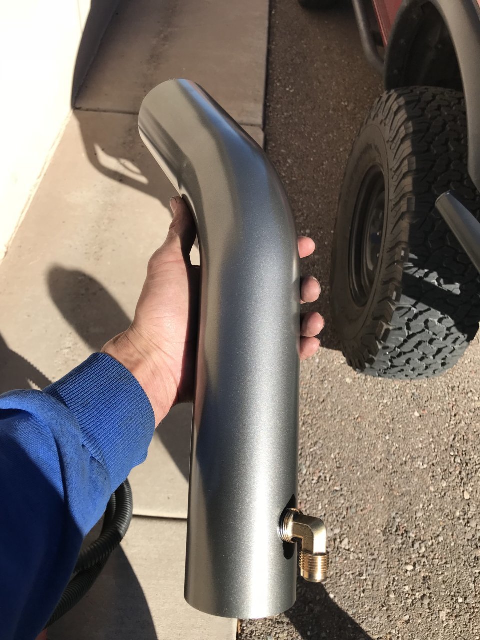

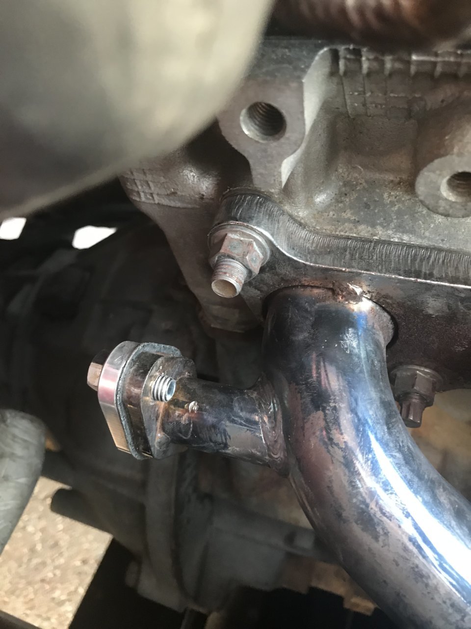

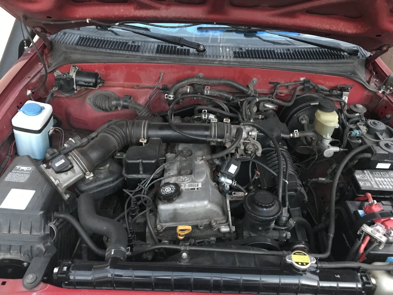

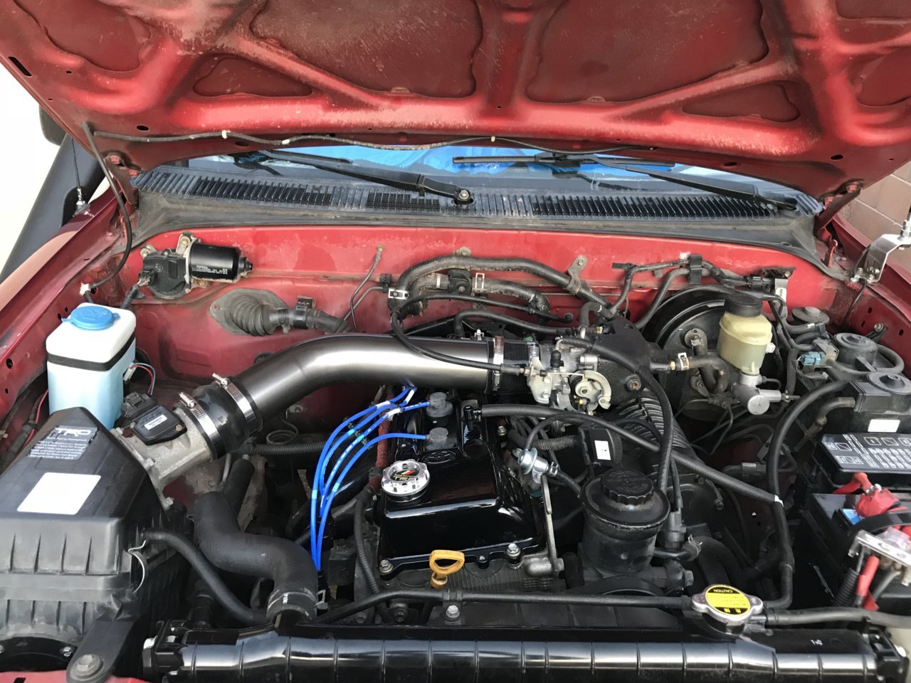

    First I started with some things in the engine bay. I needed the EGR to put on my 2000 to sell it, which worked out well since I planned on deleting the EGR off this truck. So I pulled it off and installed some block off plates from LCE.
    I also needed to use the intake tube to put my old truck back to stock so I made a new intake tube that deleted all the factory restrictions.
    I also installed some NGK plug wires and swapped over the powder coated valve cover from the other truck as well.
    Some pics...before and after of the engine bay.

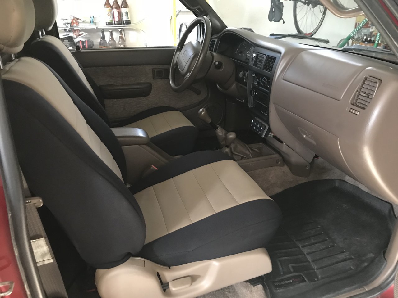

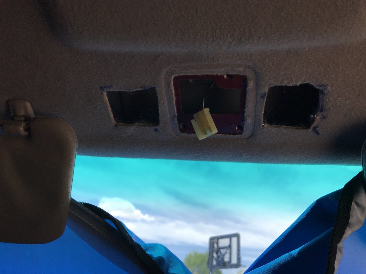

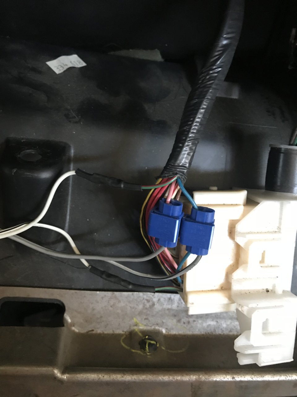

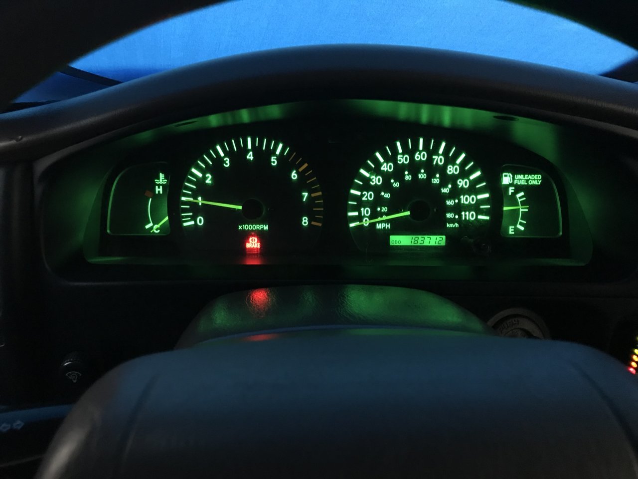

    Next I did a few things to the interior. All of the previous Tacomas I've owned had a tach in the stock gauge cluster. I didn't really like not having one in this truck and I had a hard time seeing the aftermarket one that was installed. So I did some research and found out that you can simply swap in an OEM cluster with a tach and it will work with no other modifications. So I found a used cluster on here with a tach, ordered some green LED's for it and plugged it in hoping it would work...and it did! So now the truck has an OEM tach. The only issue is that the ODO does not match with what the trucks actual mileage is. Not a big deal for me, but for those that try to do this, it's good to know beforehand.

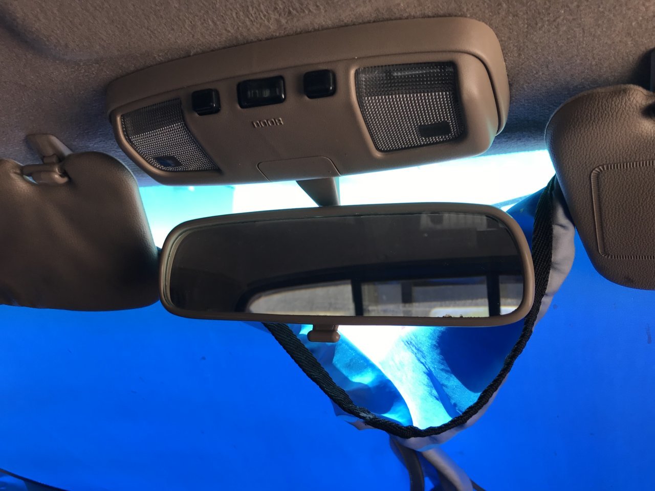

    Also, the dome light that was attached to the rear view mirror is not very bright on these single cabs. So while searching around on here, I noticed that Tacomas and 4Runners with sunroofs use rear view mirrors that have map lights on them that double as a dome light as well. I searched eBay and found one for ~$30 that was pretty much plug and play. I just had to cut a couple of square holes in the headliner for the light housing to recess into. Now I have dual dome lights and map lights as well.

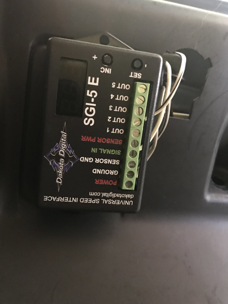

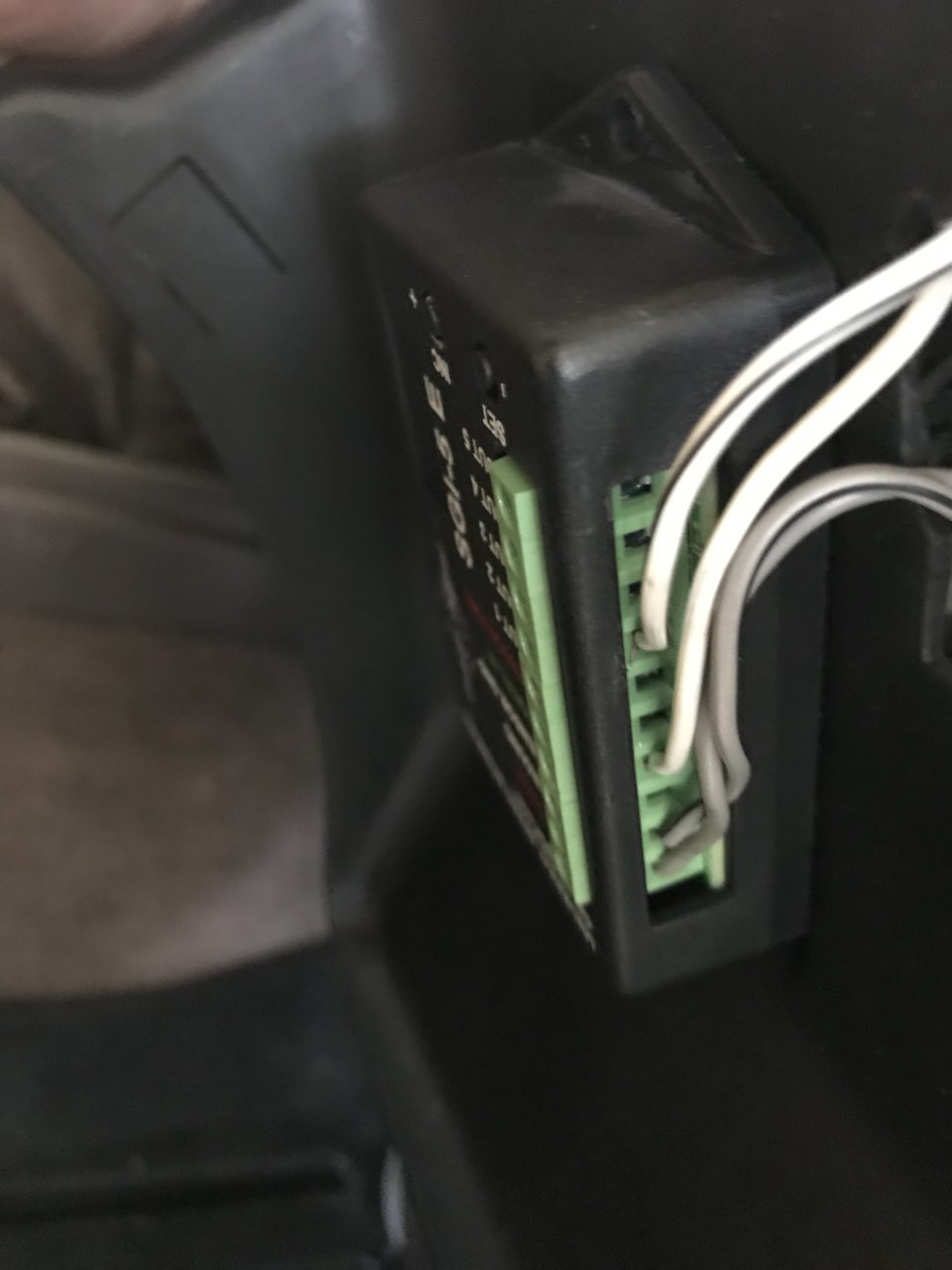

    With the 4.88's and 33's, the speedo was off by close to 10mph at hwy speeds. So I also wired in a Dakota Digital SGI-5E. It is pretty simple...basically 4 wires from the unit splice into 3 wires on the truck just above the glove compartment. Ground, Power, and a speed Input and Output to intercept the signal and correct what the ECU sees as the actual speed. Now it adjusts easily with a few presses of a button. I used 3M two sided stick tape to stick it to the top of the glovebox so it can easily be reached while driving to adjust it on the fly. I downloaded a Speedo app on my phone and simply used the adjustment buttons to match the truck's speedo to that. Now it pretty dead on within ~0.5mph
    DD Wiring:
    Ground to Blue
    Power to Pink
    Signal In to Green/Red (Factory taped up side)
    Out 2 to Green/Red (harness side)

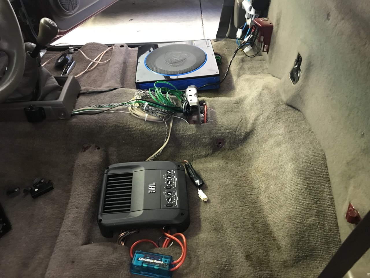

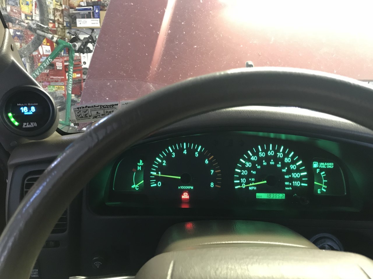

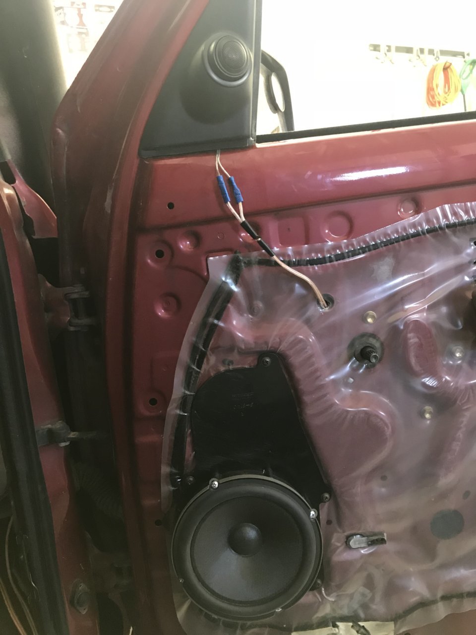

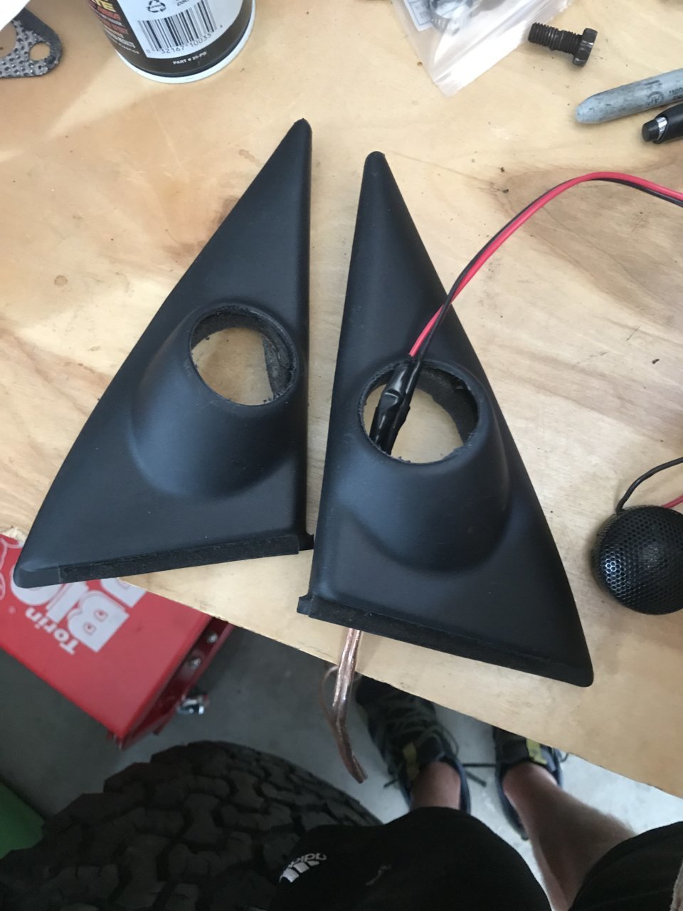

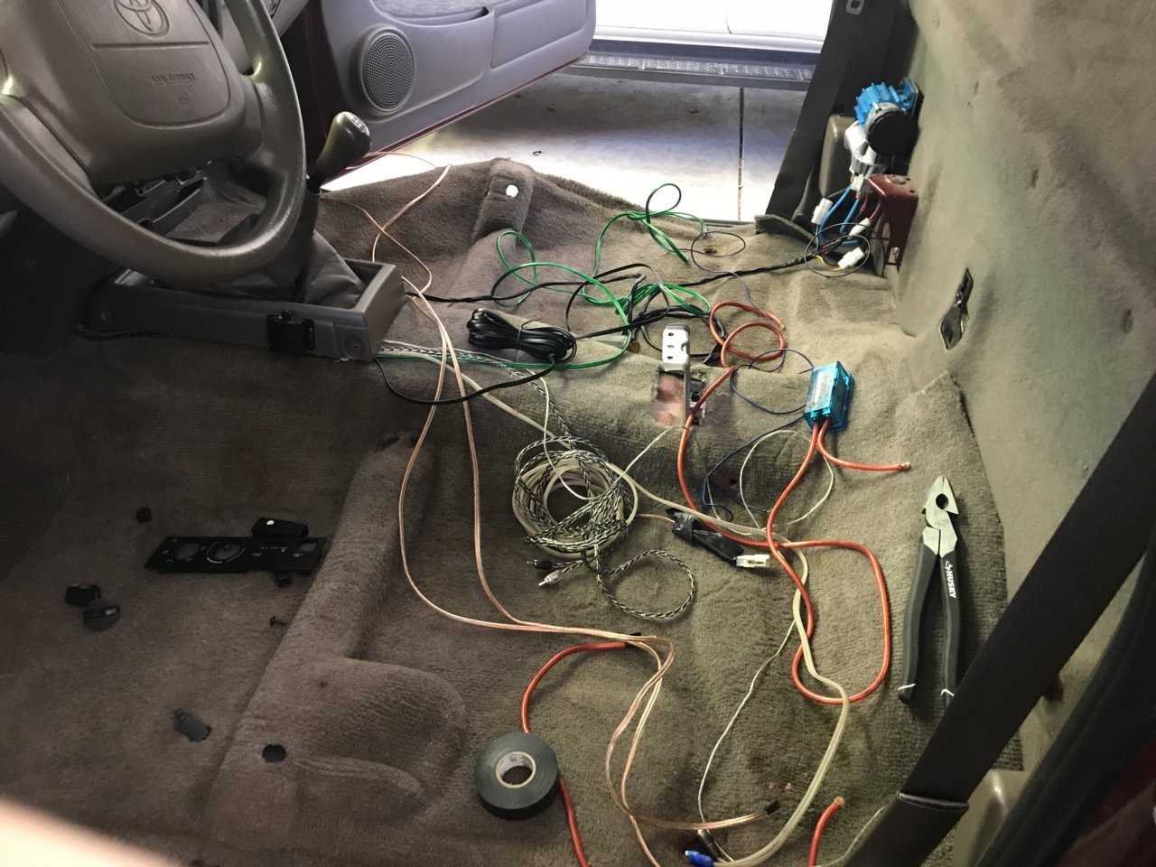

    Next I wanted to take out the smaller aftermarket tach and replace it with a PLX boost and AFR gauge. Also, I wanted to install my stereo as well. So I took out a decent amount of the interior, cleaned everything up as best as I could...vacuumed/shampooed the seats and carpet, wipe down everything with Armoral, ran the wiring for the stereo, and gauges, and installed the Wet Okole seat covers that I kept from my previous truck.
    For the AFR sensor and gauge, I used the PLX feature that allows you to replace the stock narrowband O2 sensor. Basically it is using an adapter plate to install the AFR sensor into the OEM O2 sensor bung. Then you used the supplied wire to run from the AFR sensor module to the truck's ECU. I depinned the Bank 1 O2 sensor wire and inserted the grey wire with a terminal in place of it. Them plugged it back into the ECU. I was hesitant as to whether this would work, but it fired right up. The only issue I need to figure out is I keep getting a CE code for the O2 Sensor heater wires since they are no longer connected. I just clear them with my Ultragauge Blue and it's not really a big deal. Just something to figure out at some point.
    For the tweeter part of the stereo install, I used a set of 3rd gen 4Runner sail panel tweeter pods. I drilled out the grills on them with a hole saw and found some 3/4" JBL tweeters that the flush mount pods threaded right into. This made for a fairly stock look with the ability to still swivel them if needed.

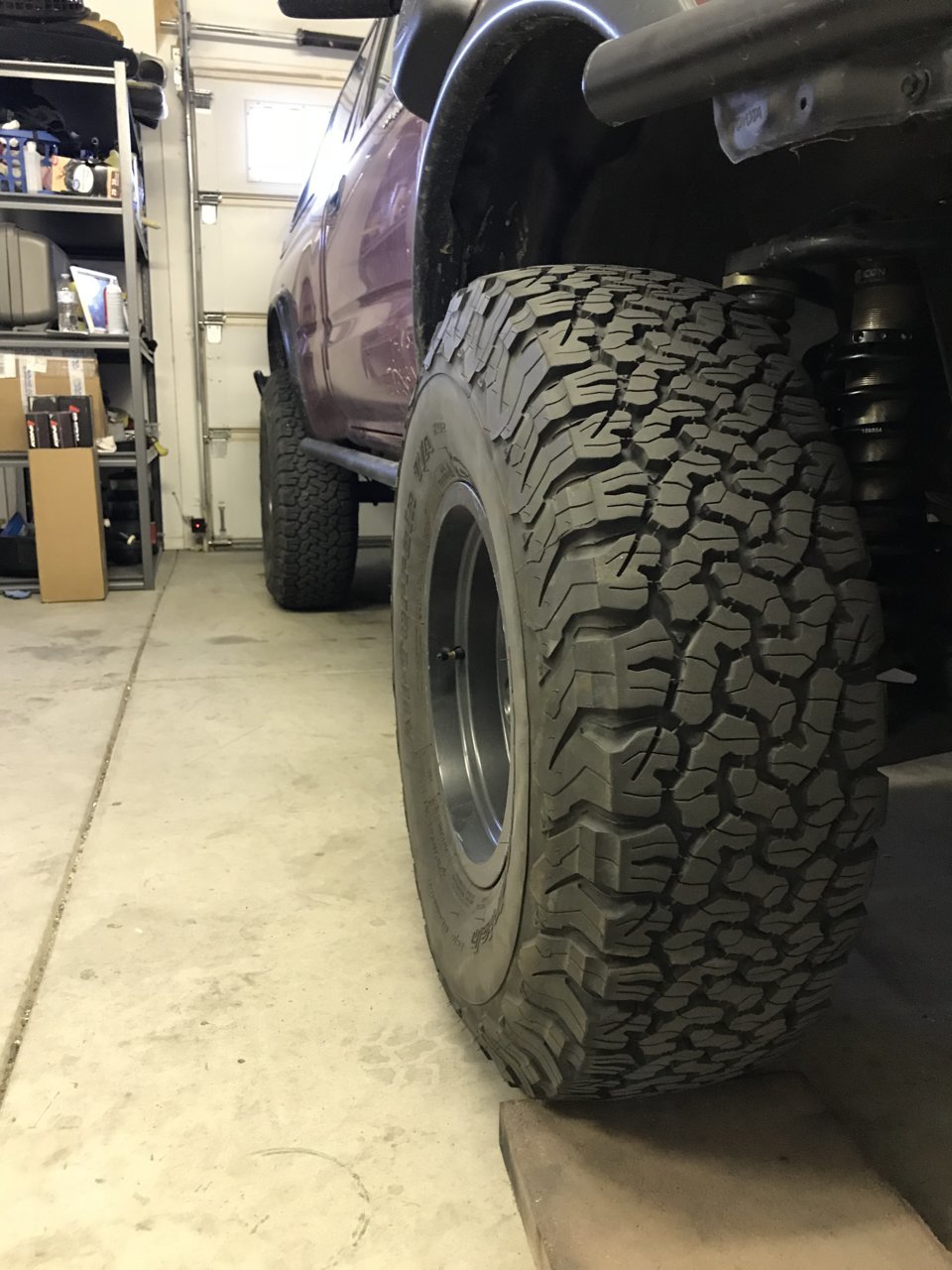

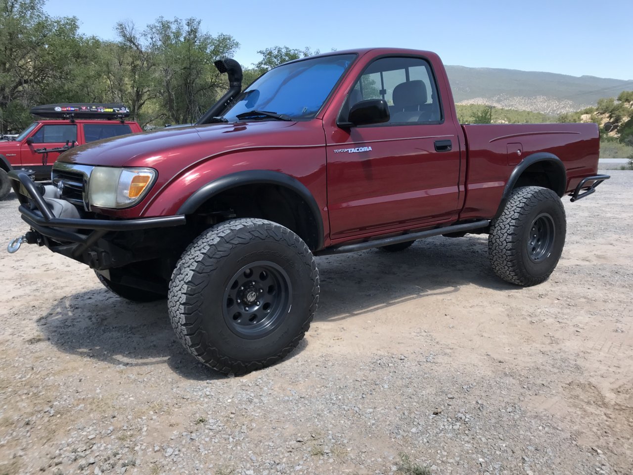

    I swapped over the wheels and tires from the old truck to see how I liked the set up. I like the wheels on the truck but the 32/11.5/15 tires were too small for the 4.88 gearing. So I had the 15x8 American Racing wheels mounted up with the 33x10.5 KO2's that came on the truck. I like the way it came out and I'm looking forward to seeing how this setup does offroad.

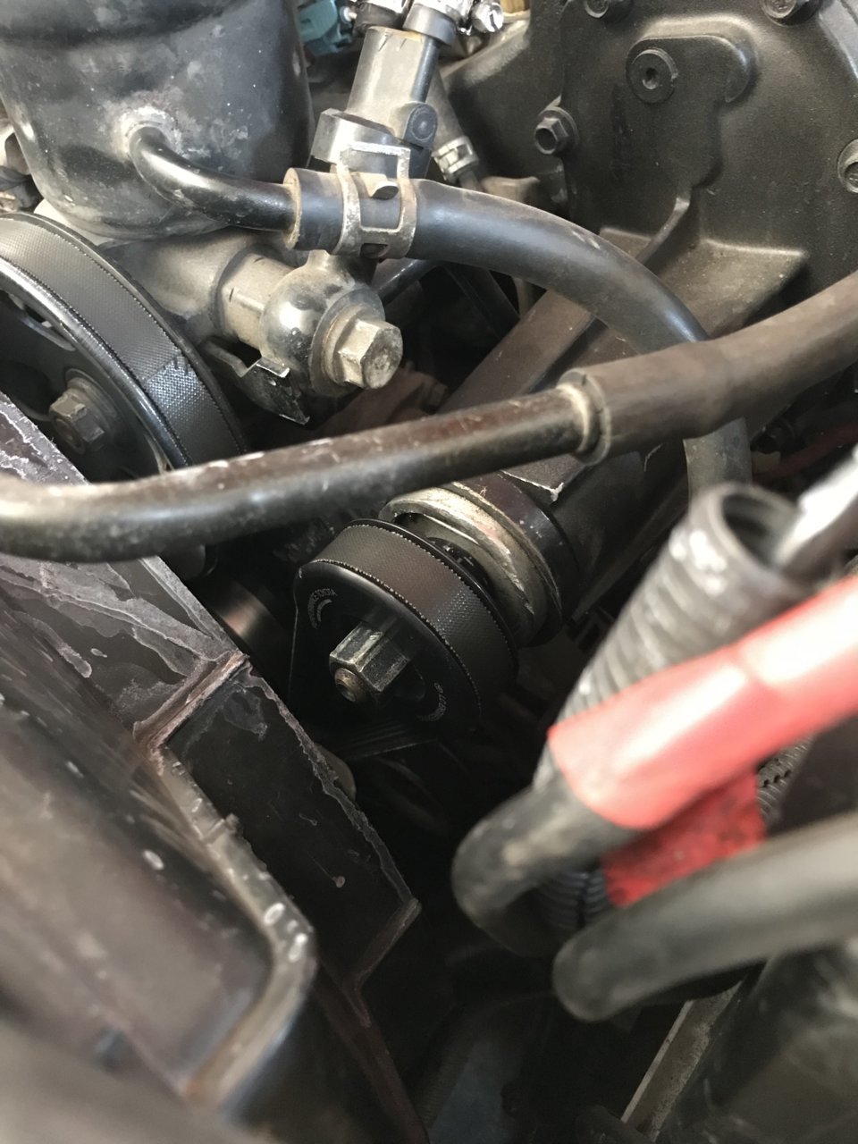

    Then I swapped out the URD pulley for a LCE 58mm pulley to get a couple more pounds of boost out of the supercharger. It definitely added some more responsiveness to the motor. It's a PIA the swap the pulley out on the 3RZ S/C compared to the 5VZ. With the unit set much further down to the side, the radiator and fan shroud make for a very tight space. So the shroud needed to be removed and I was able to just unbolt the radiator and move it enough to get a puller tool in there to remove the URD pulley.
    I also have a Snow Performance Meth Kit that I am looking forward to installing as well to hopefully get a little more HP.
    After that, I took it up to the Jemez mountains for some MTB'ing.

    You have always been really good at sharing details and helping everyone on the forum thank you so much for that !! :thumbsup:
    I would rather have the tach in the stock cluster too. I’ll have to study up on what all is needed and and how difficult that is.

    Thanks Jason. I know when I was turboing my other truck it was a pain trying to find info on certain things so I just try to put something up to help out anyone else that happens to be doing the same thing.
    For that cluster, it was literally a direct swap. There are 3 or 4 plugs on the back of it that just plug right into the tach cluster. The only additional thing I did was swapping the 4 main bulbs on the back with green LED lights. This wasn't necessary but I figured the "hard" part was already done (which really wasn't that hard) and the LED's themselves are cheap. The key thing is finding one that closely matches your mileage if you want it to be the same.
