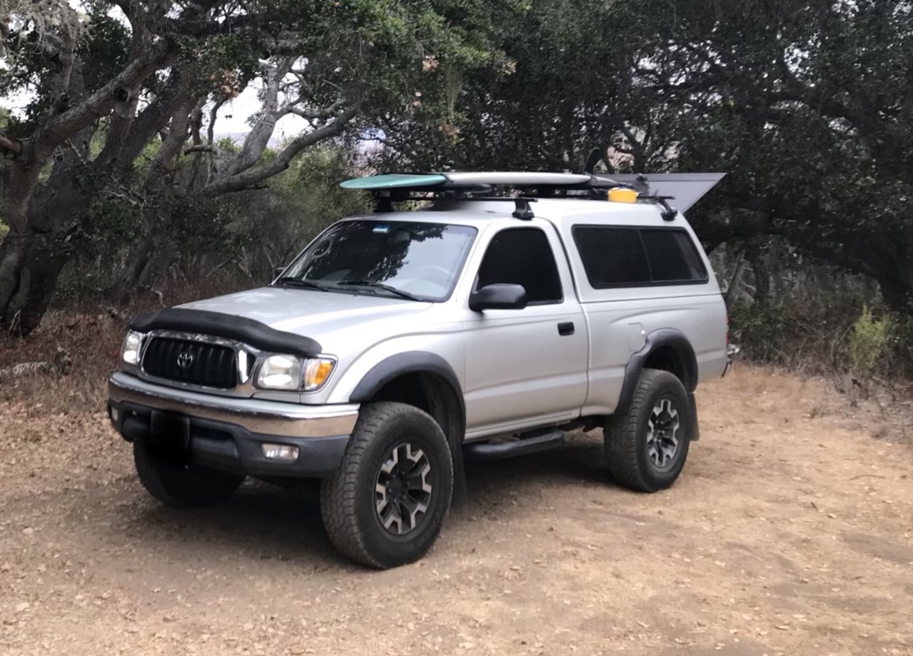

    nice regular cab!

    Thanks! It has the same 4x sliders I linked in the BF thread

    Nice - yeah I messaged them and BAMF as I’m in California so pick up may be easier. I need to get rid of these tubes ASAP

    The slides will definitely be much better. Nice setup in that truck. I like those 3rd gen wheels. They go well with silver
