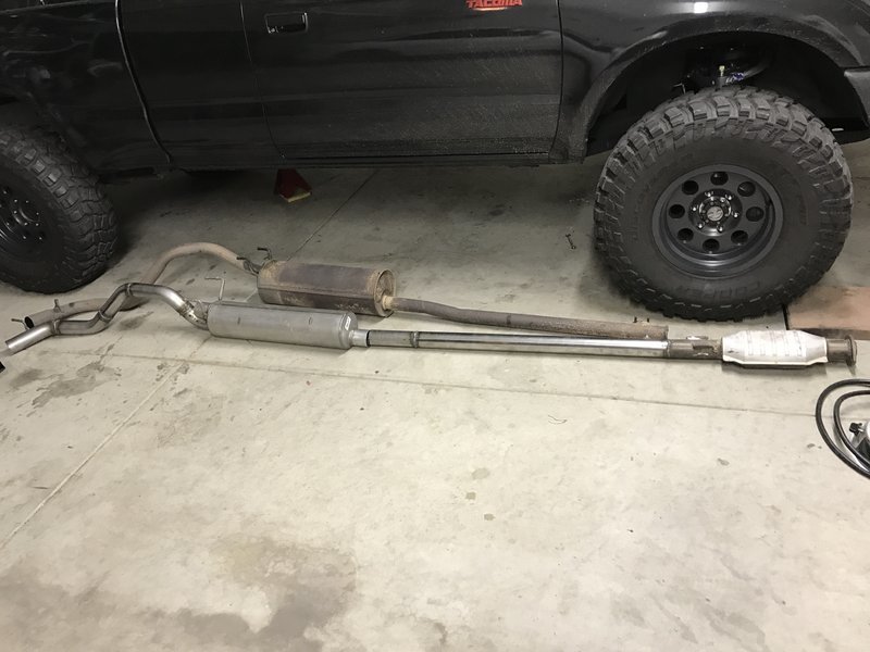

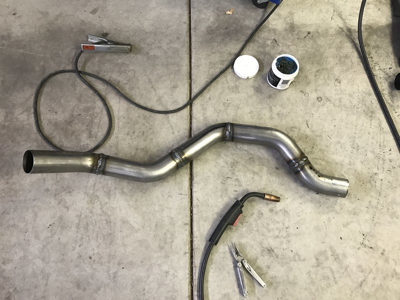

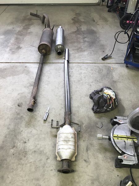

    Not yet. I finally had some time yesterday to pull my stock exhaust off and build a 2.5" catback with a Gibson Muffler. I'll get a vid up once i get that all finished.

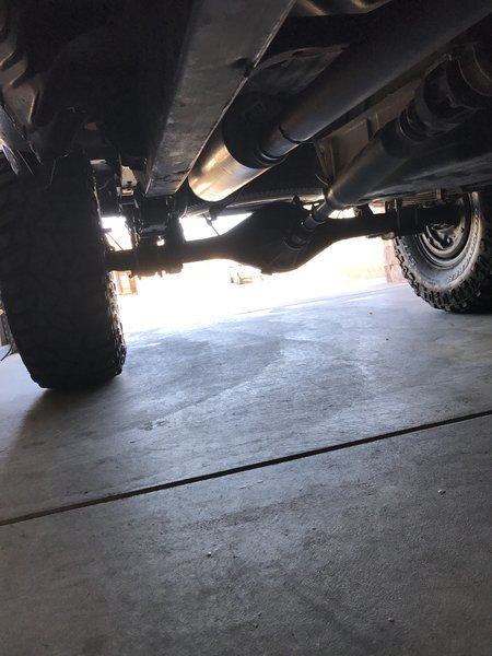

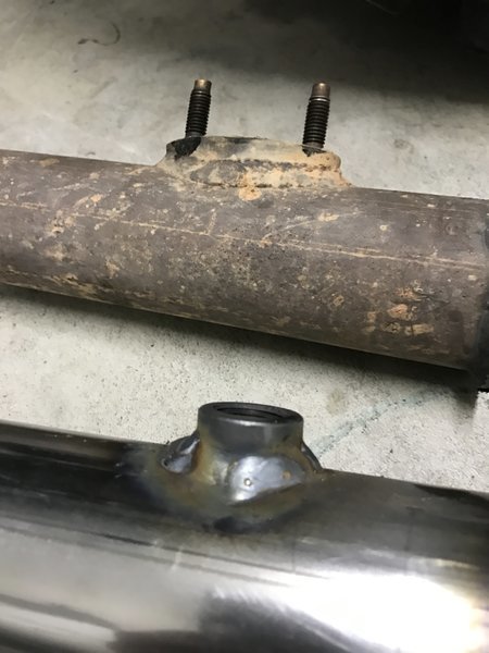

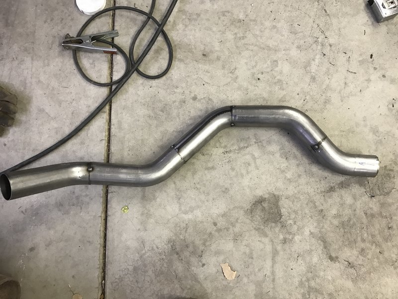

    Here are some pics of what I got done with the exhaust. Hoping to paint it and getting it installed in the next couple days

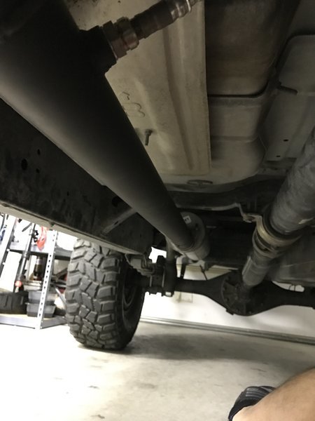

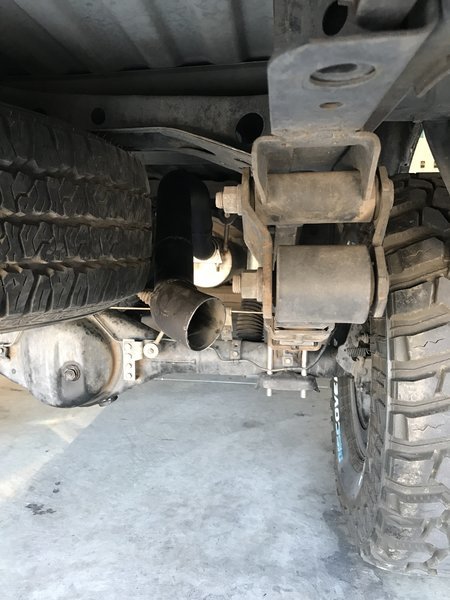

    I Got the exhaust installed today. I painted the piping a couple days ago with VHT header paint just to keep it from rusting. The tail pipe ended up slightly higher once I tightened everything up so I may need to chop off the 45* I added to the end of it since it slightly points at the leaf spring.
    No leaks though which I was stoked about. The Gibson muffler is barley noticeable as far as sound goes. Very quiet especially for a high flow muffler
    Pics:

    Thanks! The tail pipe ended up a little off from what i wanted once everything was actually bolted and hanged in place, but it's not a show truck so it's all good. Hopefully I'll have some time to make a short vid this week now that I finally finished up a bunch of this stuff.
