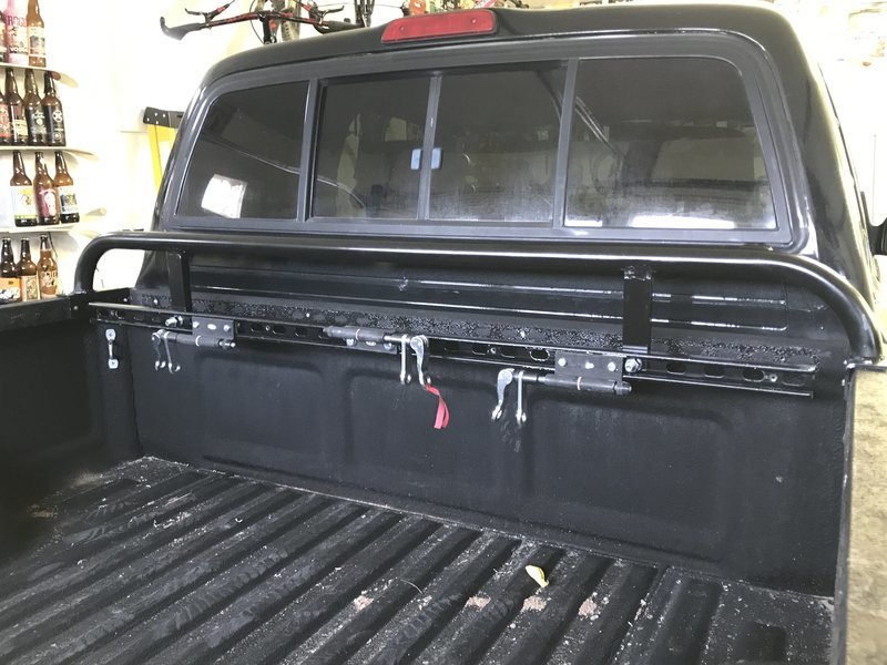

    Added a bed bar from LROR. I welded some mounts to bolt up a piece of unistrut to mount my bikes in the bed more securely.

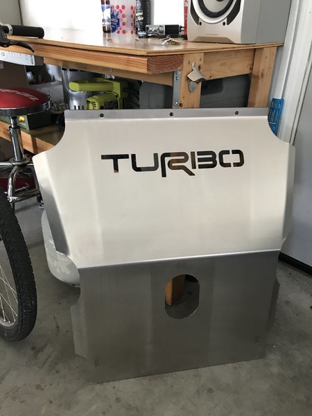

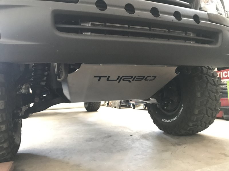

    New custom stainless skid from Ethan:

    skid looks sick man

    Took the words out of my keyboard.

    That looks legit..:eek:

    :cheers: still not sure what a TUR 130 is but it looks cool

    :burnrubber:Turbo bro
