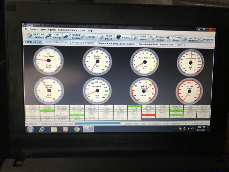

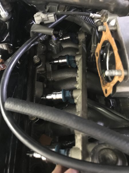

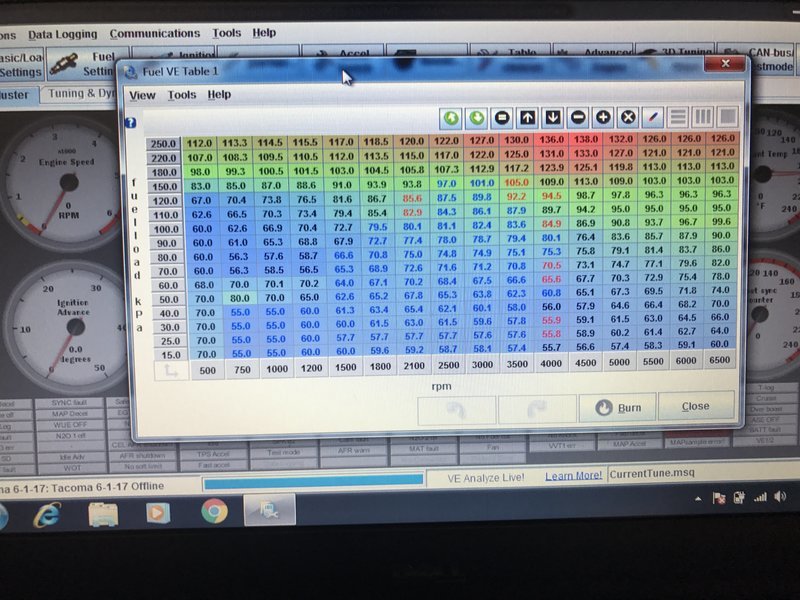

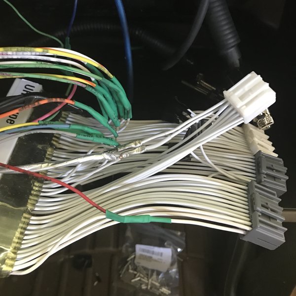

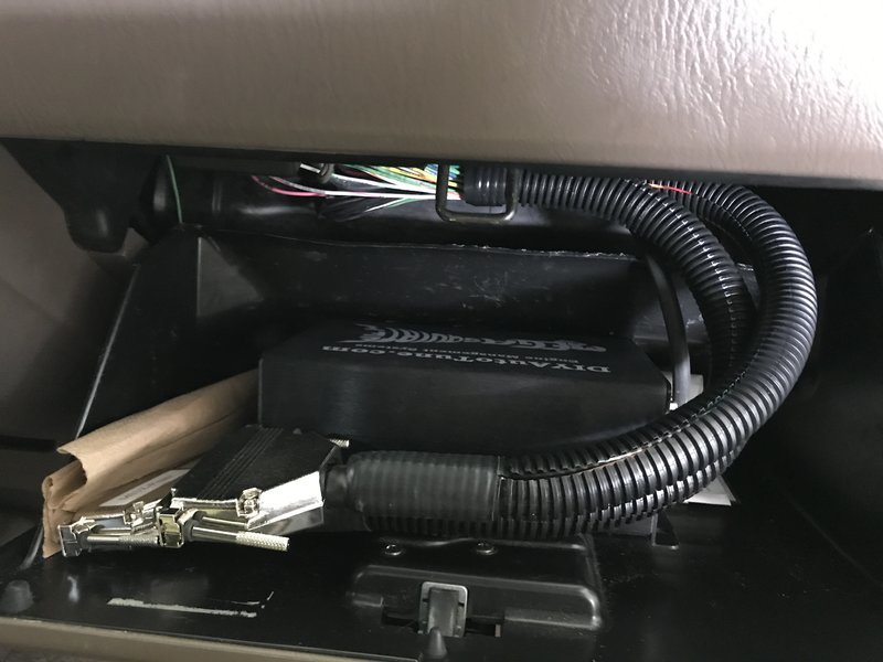

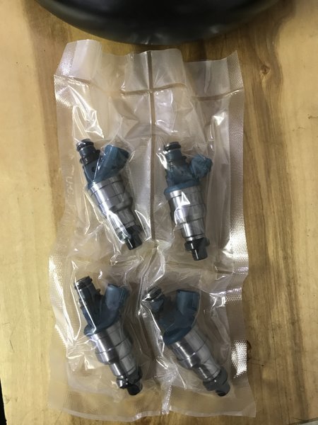

    I finally got everything working correctly with the Megasquirt3 and 550cc injectors. Initially I couldn't get it to start up...turned out I had mixed up the 2 crank VR wires when I was planning out the wiring for the PNP harness :facepalm:. Luckily it was something easy enough to fix. Now I get to focus my attention on tuning my fuel map! :bananadance: Once I can get it decently drivable under boost, I'll wire up and install a 4 port EBC to get the boost up to ~10psi. :transformer:
    I'm attaching a few random pics of the progress for anyone interested. If you want to see pics of something specific, just let me know and I'll see what else I have to post up.

    I suggest finding a steady state dyno if you can, makes it wayyyy easier to tune vs trying to road tune it

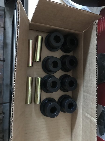

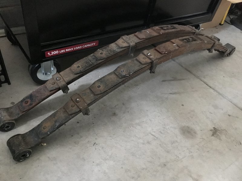

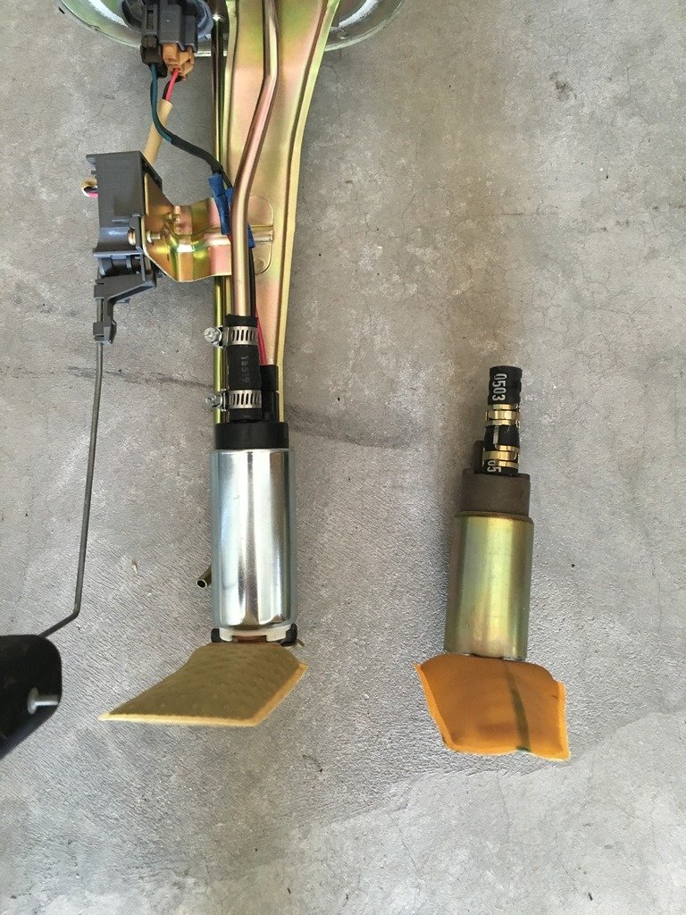

    I got a deal on some used Deaver J59 8 leafs to replace my Icon 3 leaf AAL. Also ordered some new bushings for them as well

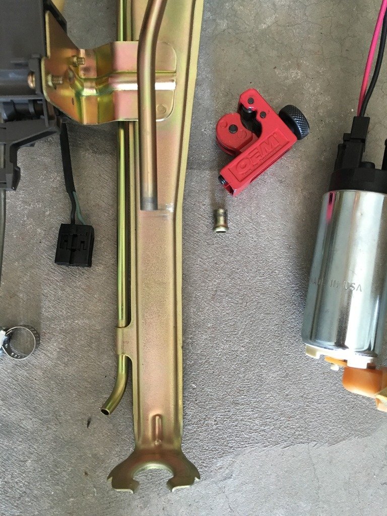

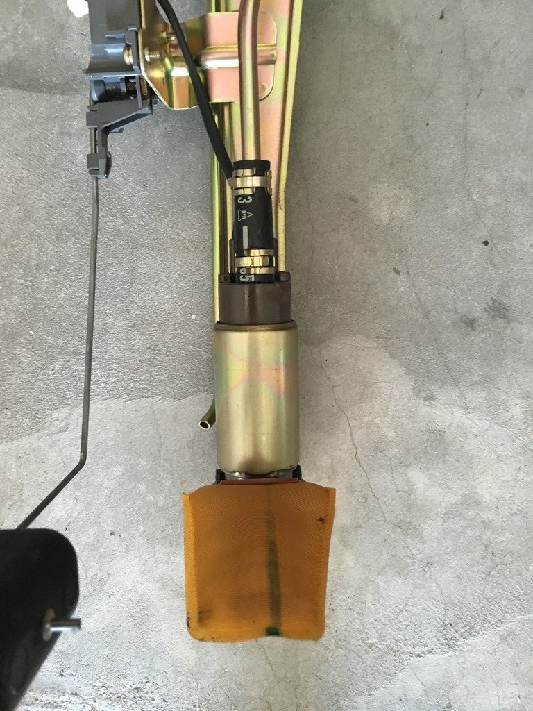

    Did you drop your fuel tank or take off your bed to change the pump. If you just drop the tank that sounds like something I could do.
  17. Jun 18, 2017 at 10:46 AM
    #277
    boostedka
    boostedka [OP] Well-Known Member
    Sep 29, 2011
    #64367
    6,064
    James
    NM
    2013 DCSB 6MT, 2004 4runner
    I did the bed thing but not completely off. I unbolted the drivers side completely and loosened the bolts on the passenger side. Then I just removed the gas cap and lifted the one side of the bed with my shoulder and stuck a jack stand between the frame and the bed. This gave me enough room to remove the pump assembly. From there it was what's in the pics then reinstall. I think the whole process took about 1.5 hours
