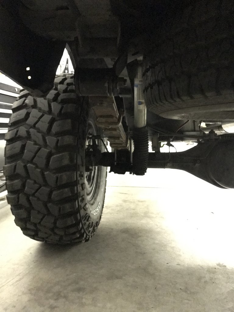

    I got a few things done last week. Installed the Deaver springs with new bushings. They put my rear end abou 1/2" higher than the 180k stock leafs with Icon 3 leaf AAL. They ride much better than before. Soak up the rough stuff well

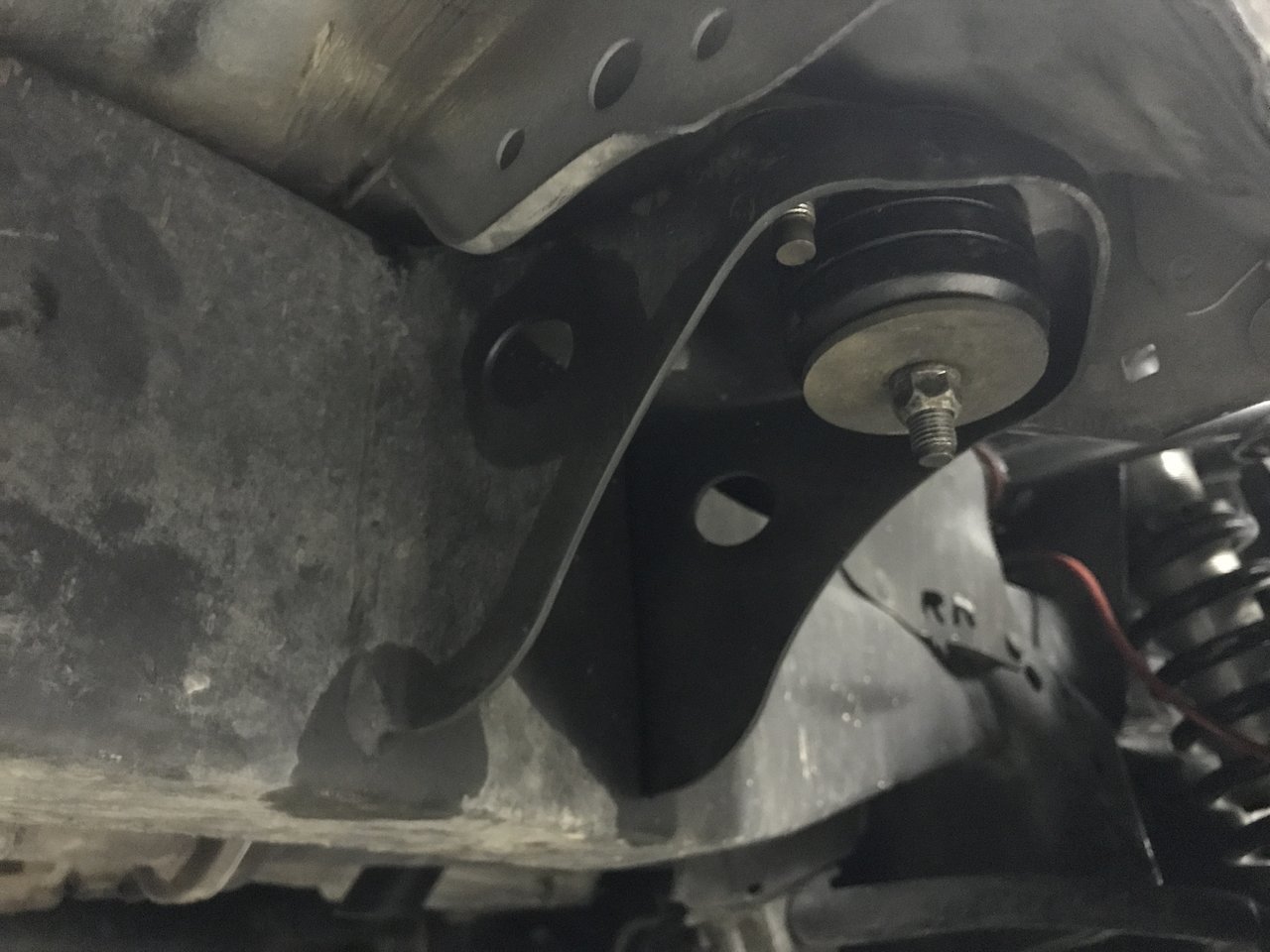

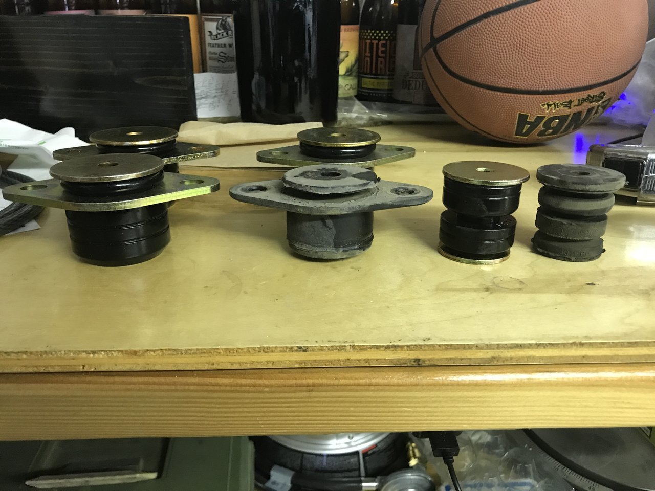

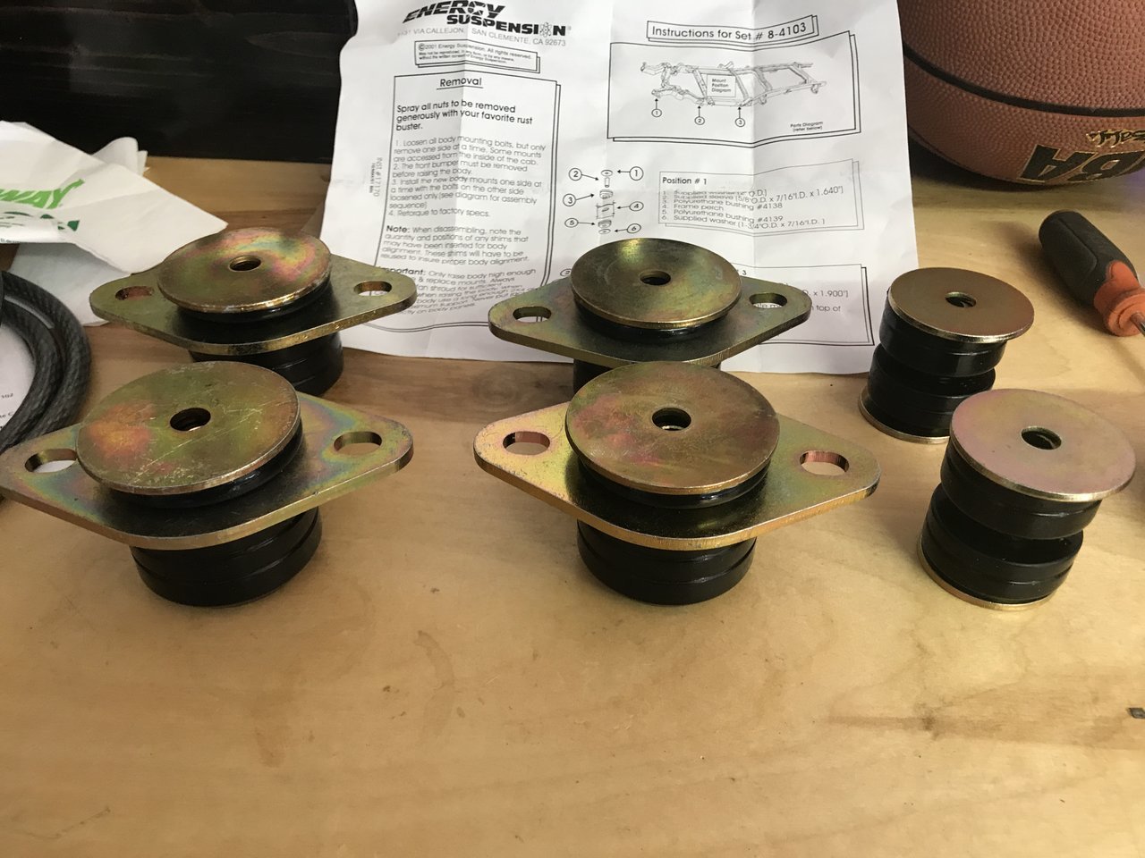

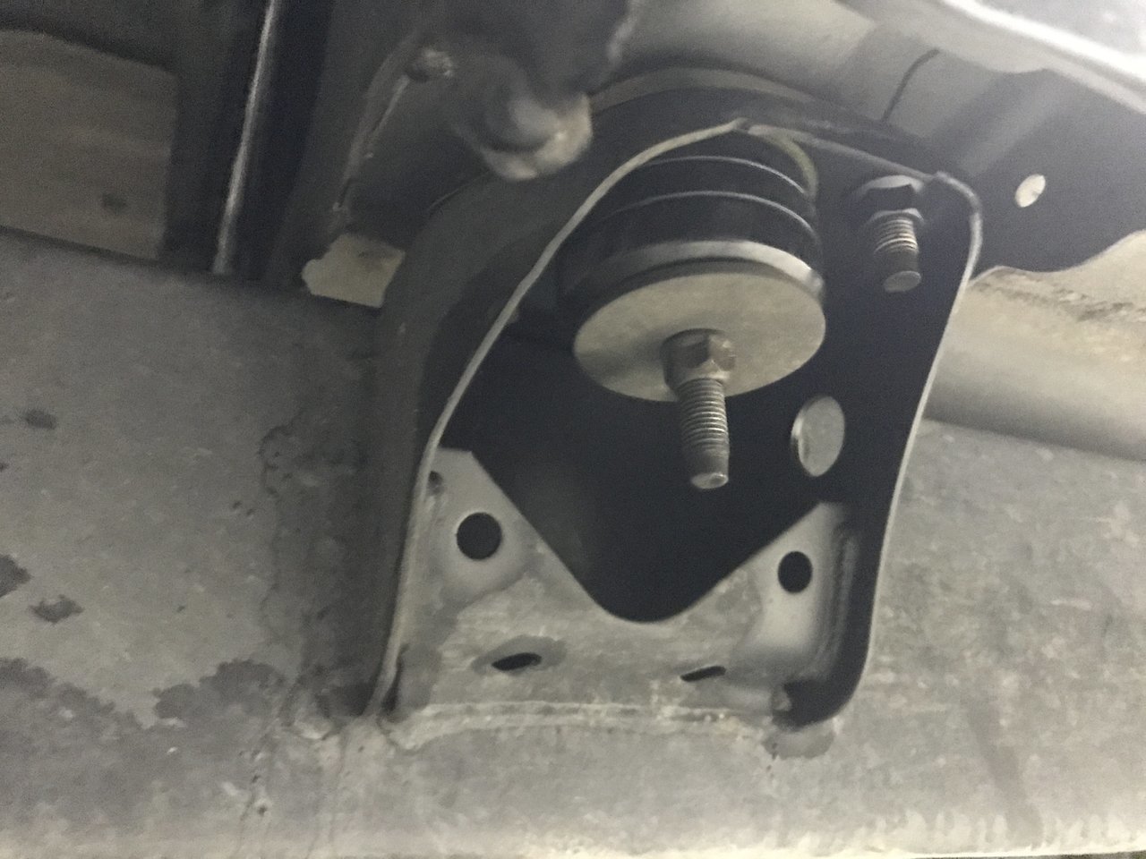

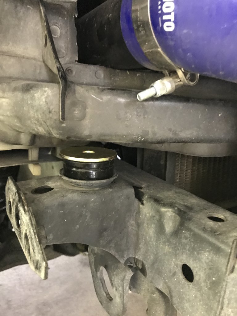

    I also installed an Energy Suspension body mount bushing kit as well. This was kind of a pain accessing the plate mounting bolts. Key is jacking up the cab high enough to get a wrench there. The mount right behind the front tire was the most difficult the others were pretty easy

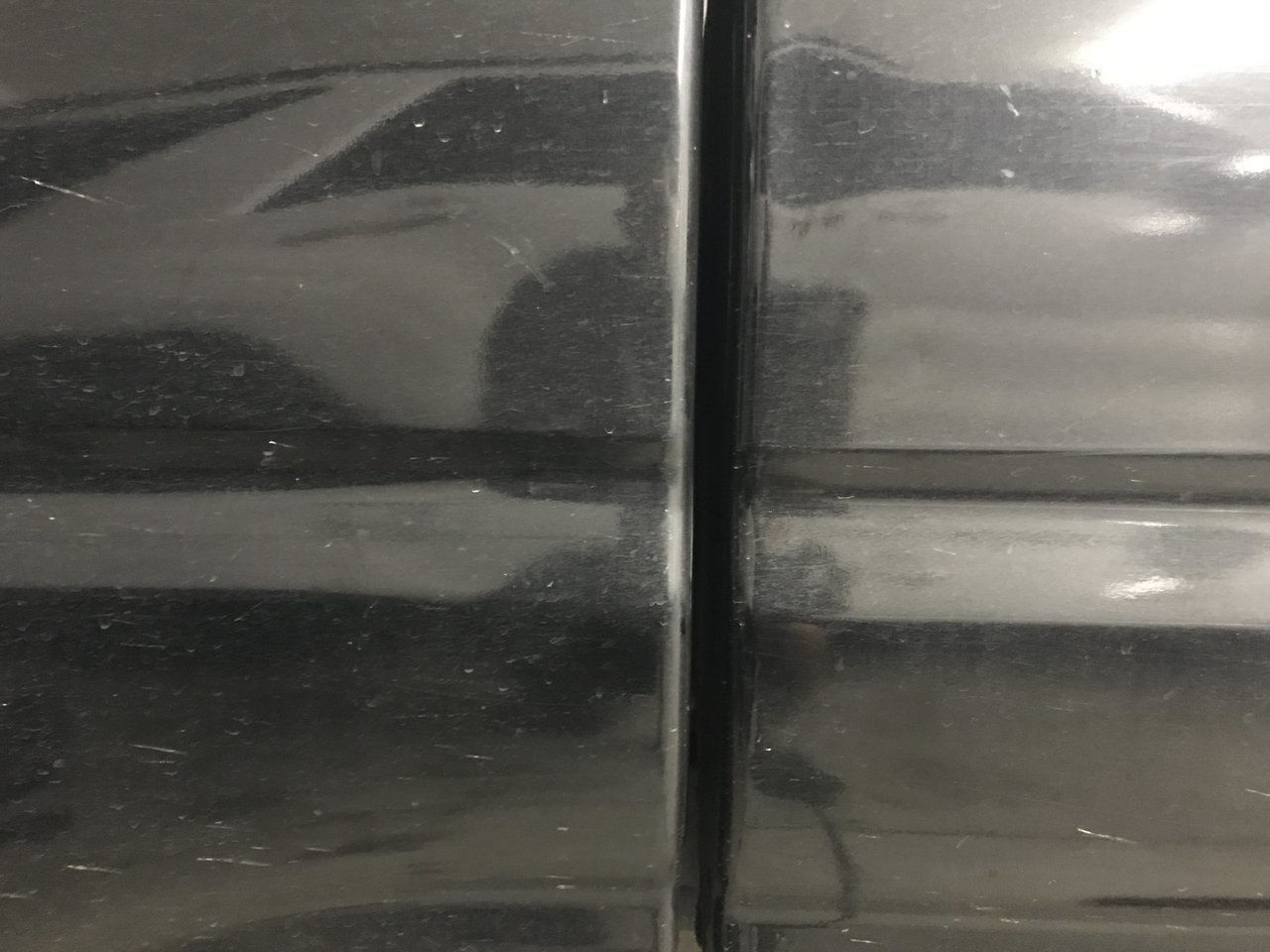

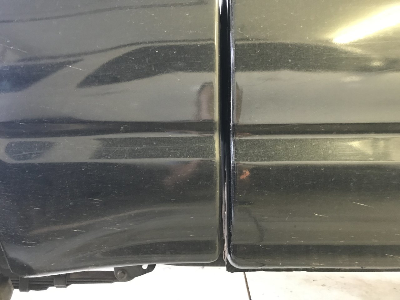

    I don't know if they really made much of a difference. This is a before and after shot of how the body lines line up

    It will be a lasting difference. :thumbsup:
