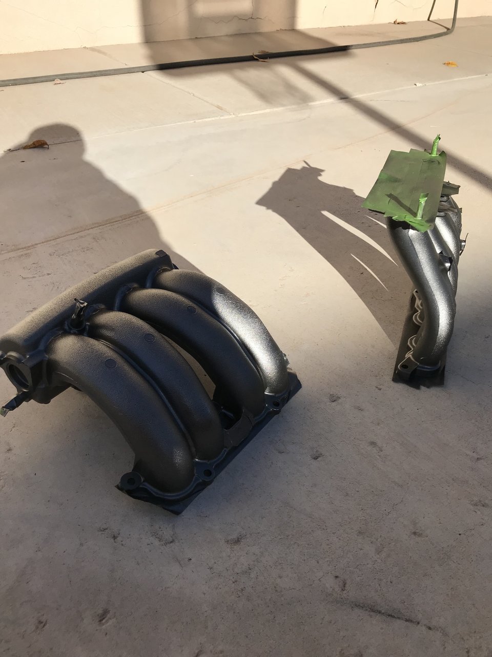

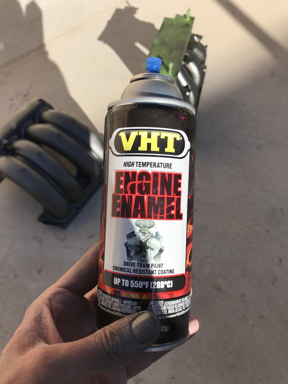

    Pulled my Intake manifold to clean out the carbon build up. I used oven cleaner then sprayed it out with a pressure washer afterwards. It got most of the nastiness off. Also decided to paint it while it is off as well. Hopefully I’ll get it installed later this week
    Jstand and MadTaco461 like this.

    Nice. That enamel will hold up well.
    I had the non enamel, and messed up my paint with a spray of brake clean. :annoyed:
    boostedka[OP] likes this.

    That’s good to hear. I’m hoping it’ll hold up well. I sanded the manifold as well before spraying it.
    You can see in the pic it makes a nice nail polish as well. :facepalm:

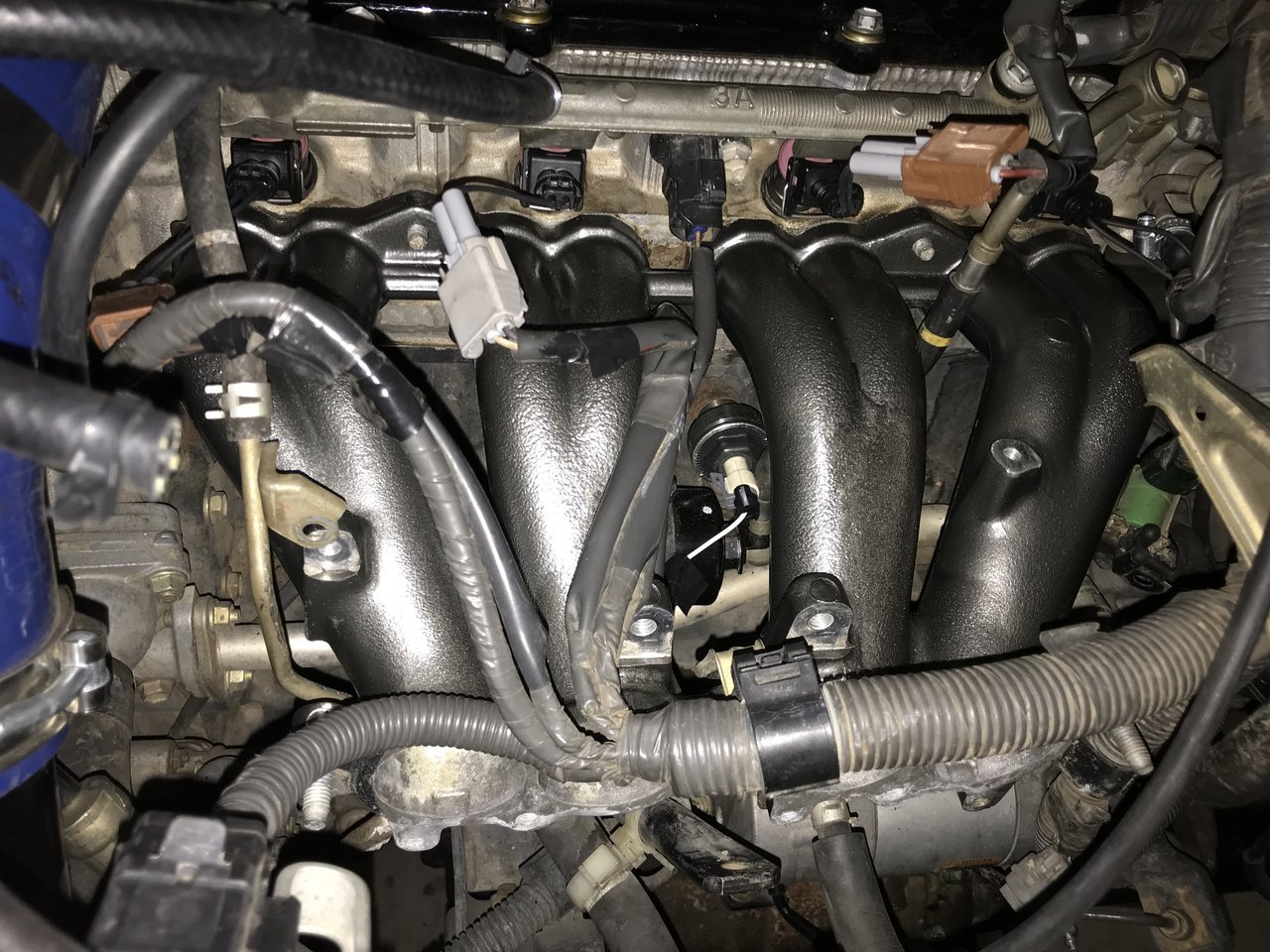

    Re-installed the Intake tonight while drinking some beer. Also put in a GM knock sensor. Hopefully the paint job holds up
    :fingerscrossed:
    ChadsPride, Jstand and Torspd like this.
