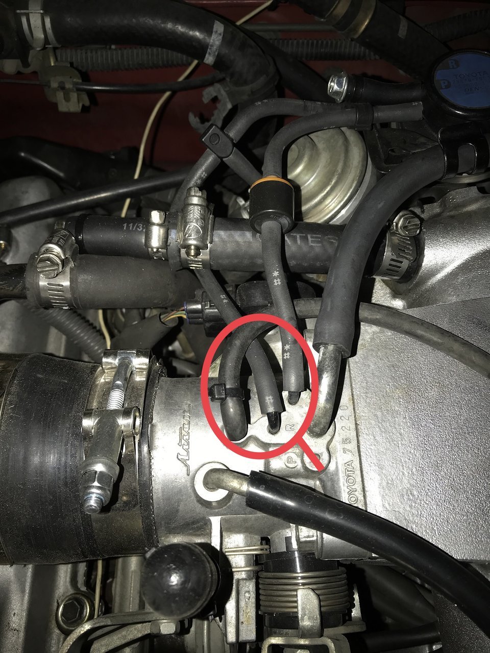

    Is there a difference between these three smaller ports. Which one would be best for the FPR for now until I get the 440cc’s. Right now it’s on the one on the left.A96EE921-9A60-4F23-9550-4443E0F5C232.jpg
  3. Nov 27, 2017 at 4:57 PM
    #343
    boostedka
    boostedka [OP] Well-Known Member
    Sep 29, 2011
    #64367
    5,997
    James
    NM
    2013 DCSB 6MT, 2004 4runner
    They’re all the same. They only see boost, no vac. I hooked up my boost gauge to all three of them and I wasn’t able to get a vac signal from any of them
    Jstand[QUOTED] likes this.
  4. Nov 27, 2017 at 5:04 PM
    #344
    rybern
    rybern Well-Known Member
    Apr 3, 2017
    #215281
    2,449
    N Alabama
    2023 TRD OR & 2000 SR5
    5100's & 3AAL, 265/70r17 Toyo AT3
    That's incorrect. They are going to slightly different places in relationship to the TB plate. I've done vacuum tests on them and they each are slightly different but they all pull a small amount of vacuum. But they all go to either the VSV, Vac modulator or the EGR(all EGR related).

  6. Nov 27, 2017 at 5:53 PM
    #346
    boostedka
    Sep 29, 2011
    #64367
    5,997
    James
    NM
    It must be a very small amount of vac then b/c my gauge didn’t move all when hooked up to any of them at idle.
    Anyhow, I’m no longer using any of those. I replaced the plug on the back of the manifold with a vac nipple and have the FPR and gauge both reading off of that. I assumed that it is essentially the same as the one on the front just with out having to t into the power steering vac line. Am I thinking about it incorrectly?
    Jstand and MadTaco461[QUOTED] like this.
  7. Nov 27, 2017 at 6:14 PM
    #347
    rybern
    Apr 3, 2017
    #215281
    2,449
    N Alabama
    I think they only really pull vac depending on throttle response. I'm not sure about the pwr steering vac line.... that's not one I've removed or researched 4 times in the past few weeks. ;)
    boostedka[QUOTED][OP] likes this.

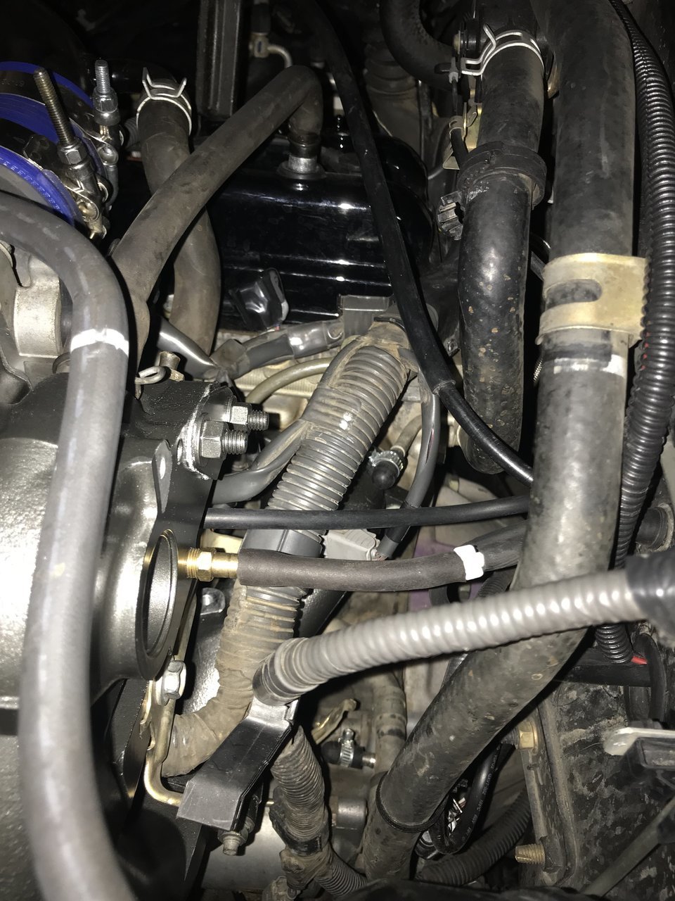

  17. Dec 2, 2017 at 5:40 AM
    #357
    Jstand
    Jstand Well-Known Member
    Jan 24, 2017
    #208506
    1,125
    Jason
    Irving,Tx
    2011 Tacoma DC TRD SR5 4x4
    Just to make sure. Do you have your FPR vac line going to the intake in the back port that usually has a plug and is the FPR stock
  18. Dec 2, 2017 at 6:06 AM
    #358
    boostedka
    Sep 29, 2011
    #64367
    5,997
    James
    NM
    Yeah I have both my FPR and boost gauge sourced there. The added vac that is read there is what lets it trim the extra fuel at idle and lower RPM driving. You could also use the one on the front as well. As long as it’s a source off the plenum not near the Throttle Body

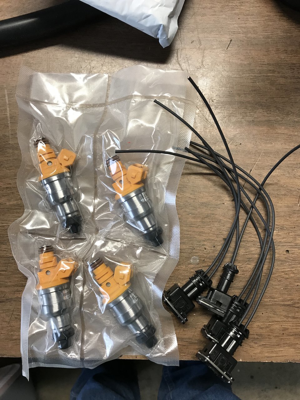

    #359
    Jstand
    Jan 24, 2017
    #208506
    1,125
    Jason
    Irving,Tx
  20. Dec 2, 2017 at 3:30 PM
    #360
    boostedka
    Sep 29, 2011
    #64367
    5,997
    James
    NM
    I’ll have to check my paper work when I get home to compare. I do know that mine were pink on top. But their site does also say colors may vary. Also my 440s came with adapter connectors so I didn’t have to cut the old plugs off. My 550s I ordered from them came like the ones you got now. Not sure why they’d be different
