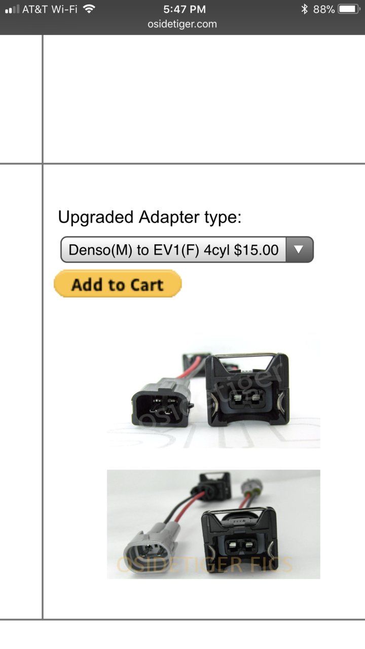

    I think I was supposed to order these too denso male to ev1 female so I ordered them but I didn’t see an option for expedited shipping hopefully I’ll get them before Thursday!!FFE7D5D4-3900-464E-B201-1B57FD1EDE5D.jpgbut i could just cut the ends

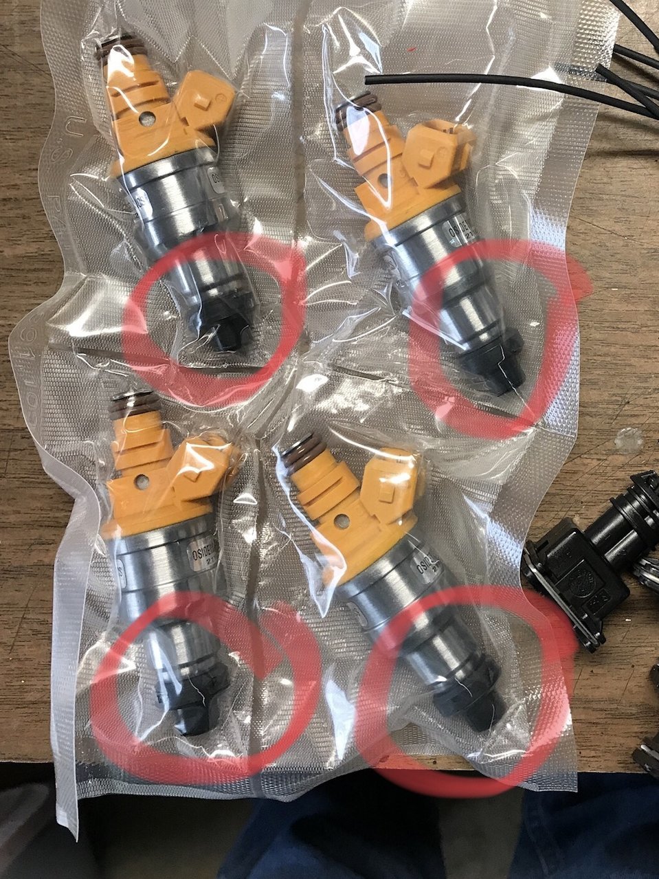

    The 550’s use the same style plug as the stock injectors. But the 440’s have a rectangular shaped plug. I’m not sure why I got those adapters which mine. Maybe they sent me them by accident

    The numbers look the same. Just the PN has a Y after it on yours which I'm guessing means Yellow

    That should work out well then. They usually ship stuff pretty quickly. I’d call them Monday just to ask to make sure they’re the same thing and just yellow on top for whatever random reason

    Since you already ordered the adapters you might as well use those when they come in. I was going to cut mine when I was putting the 550s in until I realized they were the same plug. Then again with the 440s I was going to cut when I saw they were different then I pulled the plugs out of the box and saw they were the adapters. I was like “fuck yeah”. I think I literally said that to myself out loud in the garage.
    I think It was a total mistake on their end. Lucky for me

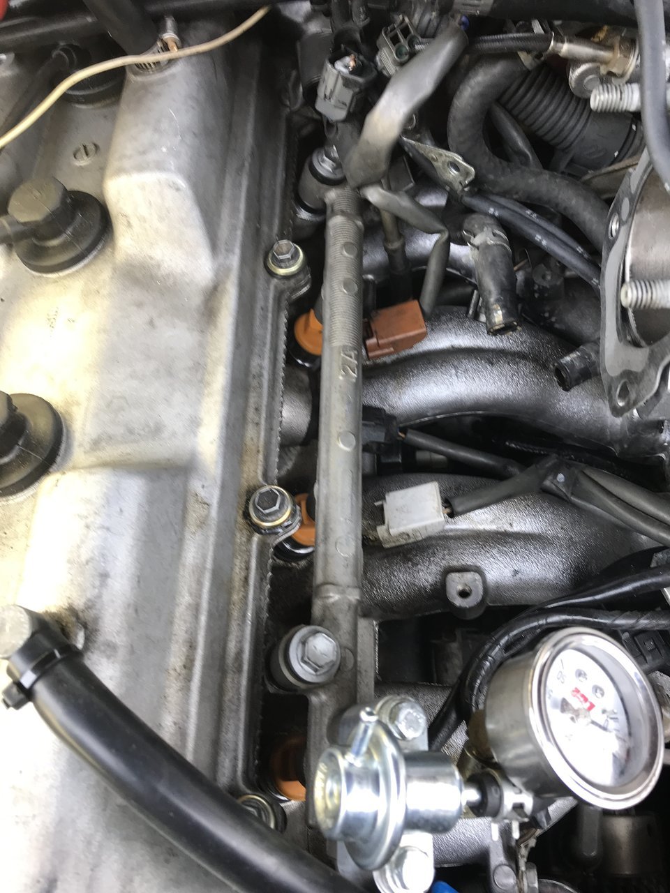

    A@boostedka when you installed your 440cc injectors did they have these same seals ? 854BE7E1-49BF-47D4-83C4-ABC8E6237799.jpg
  12. Dec 7, 2017 at 8:49 AM
    #372
    Torspd
    Torspd Tor-nication
    Sep 18, 2009
    #22958
    26,439
    Tor
    The Great America!
    MMVI 4.4L 4x4 Access Cab
    Torspd Custom Turbo kit [] Borg Warner 9180EFR Turbo [] Haltech Elite 2500 [] TiAL Q BOV [] TiAL V44 Wastegate @ 15psi [] CP Pistons [] CP Carrillo Rods [] ARP Head studs [] ARP Main Studs [] ARP Header - Head Studs [] Ported Heads w/ 1mm oversized valves intake/exhaust [] Brian Crower Forged Stroker Crank [] Darton M.I.D. Sleeved Block [] Kelford Camshafts [] Torspd 160* T-stat mod [] APR Large Fuel Rail [] Walbro 460 LPH E85 Fuel Pump [] FueLab FPR [] APR T56 Conversion Kit [] KP RACING Built T56 [] McLeod Racing Custom Twin Disk Clutch [] One Piece Aluminum Driveshaft [] MGW Shifter [] Custom lowering kit [] Ohlins Front Coilovers [] QA1rear shocks [] Custom Ron Davis Radiator [] Dual SPAL Electric Fans []
    Those are insulators.
    Jstand[QUOTED] likes this.

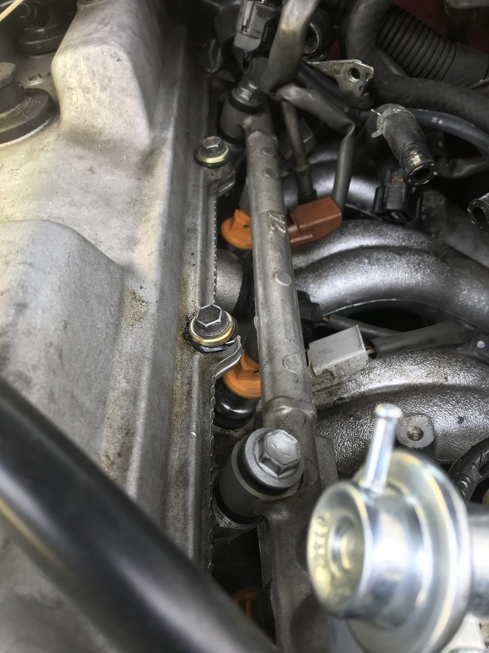

    0D8C8728-7320-458D-8B07-86596DE8B1A6.jpg Should I put washers here on both sides because it gets really tight before I tighten it all the way down.

    Does the fuel rail have to be tightened all the way against the head or do the injector just need to be tight in the rail ?

    You want it to squish a bit to keep the air pressure in the intake plennum with a turbo, but that looks like too much squish. Get another small washer to take up most of that space to get the bolts tight. I cant necessarily see how much space you have there, but yes, the bolts should be tight to the head holding the injectors in.

    It was loosened when I took the pic so it’s about 2 or 3 washers worth when it’s tight but I wonder if @boostedka had this same problem

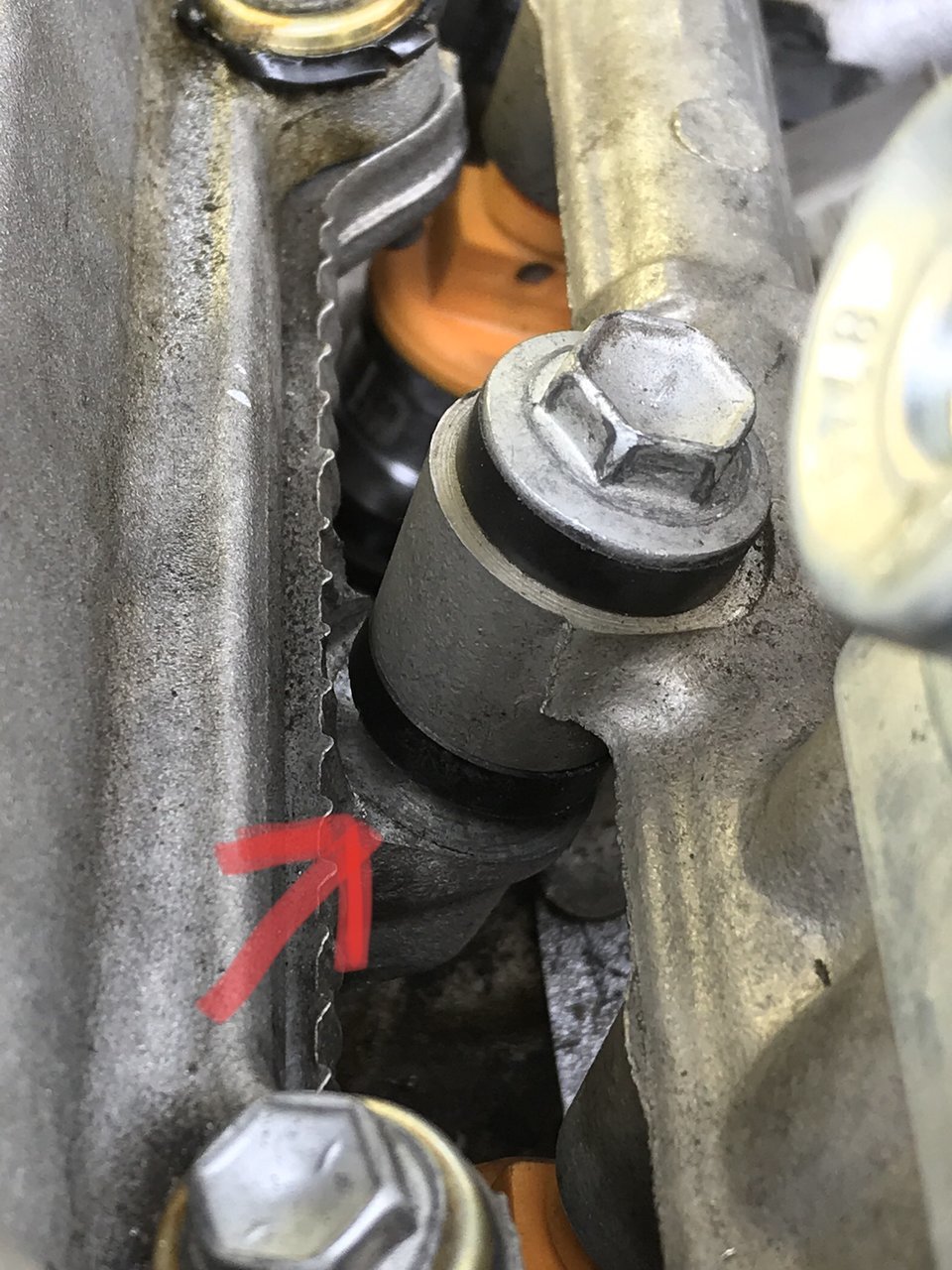

    0E87A855-657D-4141-AF26-D6C9D49A7164.jpg I put 3 washers on each side and it seems ok just tight. Now I need the p&p connectors to get here so I can button it up and test drive.image.jpg

    Mine fit snug all the way down. I lubed them up with a very small amount of oil to help everything slide together on both ends

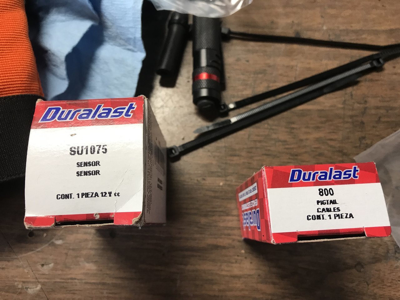

    This is what I got and I’m rechecking everything now :facepalm:0A69DE65-160A-40C1-A56E-C3B5B6FBE76C.jpg
