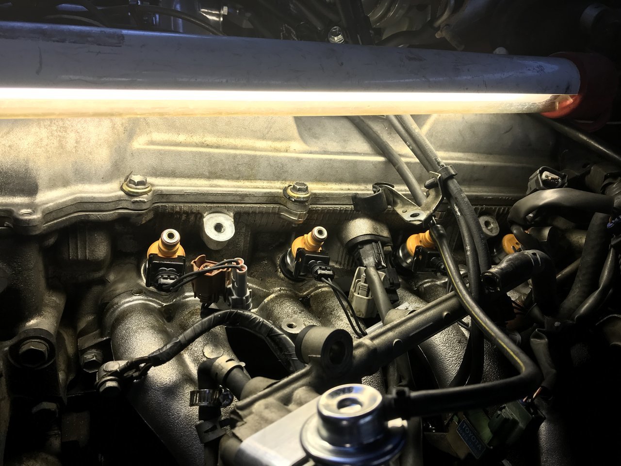

    9B1F19FC-B67C-449B-938F-A883539254C7.jpg This is what the injectors look like. I don’t want to break them by tightening them to tight

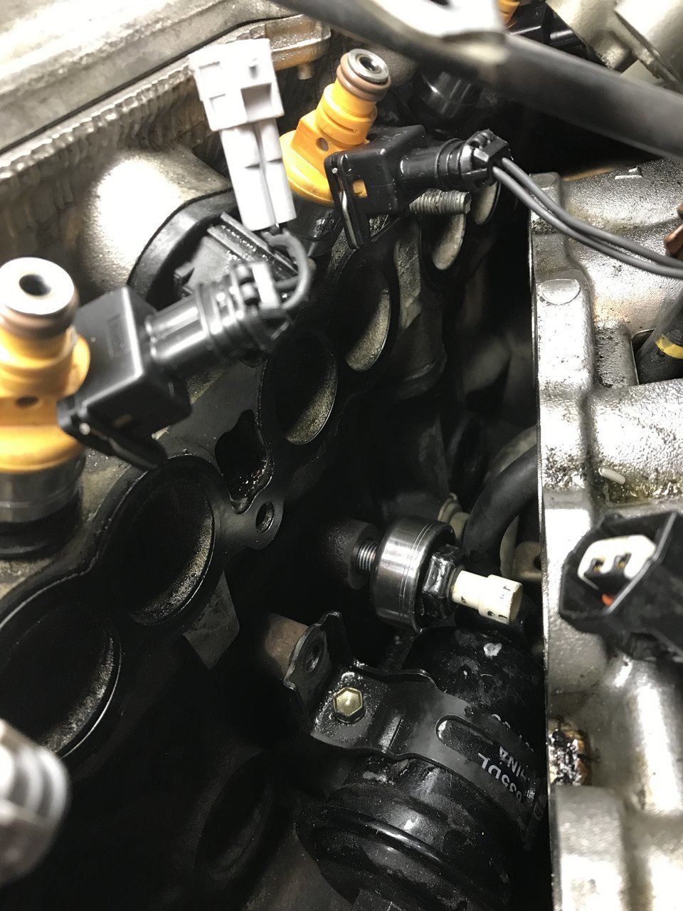

    B8D0C7FA-9320-450C-B7D8-E31E626EA02D.jpg The knock sensor went in a whole lot more I hope that’s what it was.

    @boostedka were your injector really tight when you were tightening them. I don’t want to break them

    @oostedka is it safe to tighten the rail all the way down even if it’s tight enough to hear popping

    Mine were snug but not tight. When i did the 550’s I didn’t lube them and they had a harder time seating into place. Did you lubevthem up before installing them?

    So I’m a big dummy I was trying to put two insolators and the sensor went in a little more just about to test drive again on the way to practice. :fingerscrossed:

    image.jpg F4595B44-97A3-49B0-A9F3-115C37527F4B.jpg Out for a test drive after about 10 miles light came on P0325 knock sensor again then I reset it again and idle is good but it keeps coming on :notsure: I reset it but it came back on quick

    After reading the code P0325 I’ve ether got a bad sensor or something in the wiring. Now if there was a way to figure out which wire at the ecu is the knock sensor wire I could bypass it in the engine compartment to see if that’s it.
