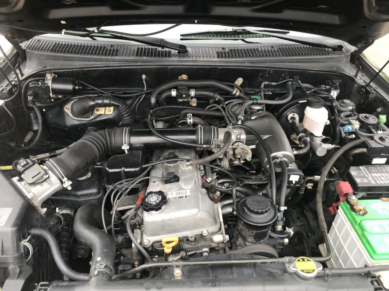

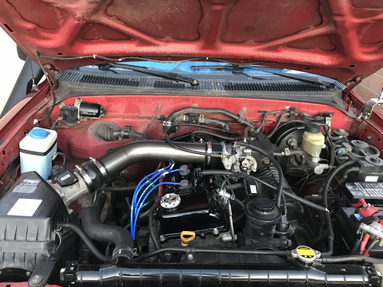

    Here's a pic I showed Zane with the EGR delete and new intake charge pipe I made for it. I also swapped over my PC'd valve cover as well.

    Defintely. The valve cover made a big difference. Getting rid of all the restrictive devices on the intake as well as all that EGR stuff you're pulling out help out quite a bit too.
    On this truck I still sent the coolant through the TB with some "custom" Autozone lines.

    @boostedka I think you have a boost leak on the SC truck, the steering idle up valve should go to the vacuum port on the elbow and then to the port it's on now on the other side. It looks more like it going to boost and then to the TB. Maybe I'm wrong but I dont know where else it would pull vacuum besides the elbow port. Also do you have any clips of the sound of that intake?

    Here’s a side pic of that area. It’s a little different now that I installed a boost gauge last week. The Power Steering vac line is T’d with the FPR and connects to the port on top of the S/C. I can get a more updated pic when I get home from work. How do you have yours hooked up?

    What's the diameter on that IC Pipe?

    It's 3" Mandrel bent. I'm using a 3" hump hose going into the Air box and a 3" to 2.75" going into the Throttle Body.

    Mine is how they recommend it because that switch it basically a through connection when you're turning the wheel. So with boost going to it, it just leaks it back before the rotors. It supposed to be like this...
