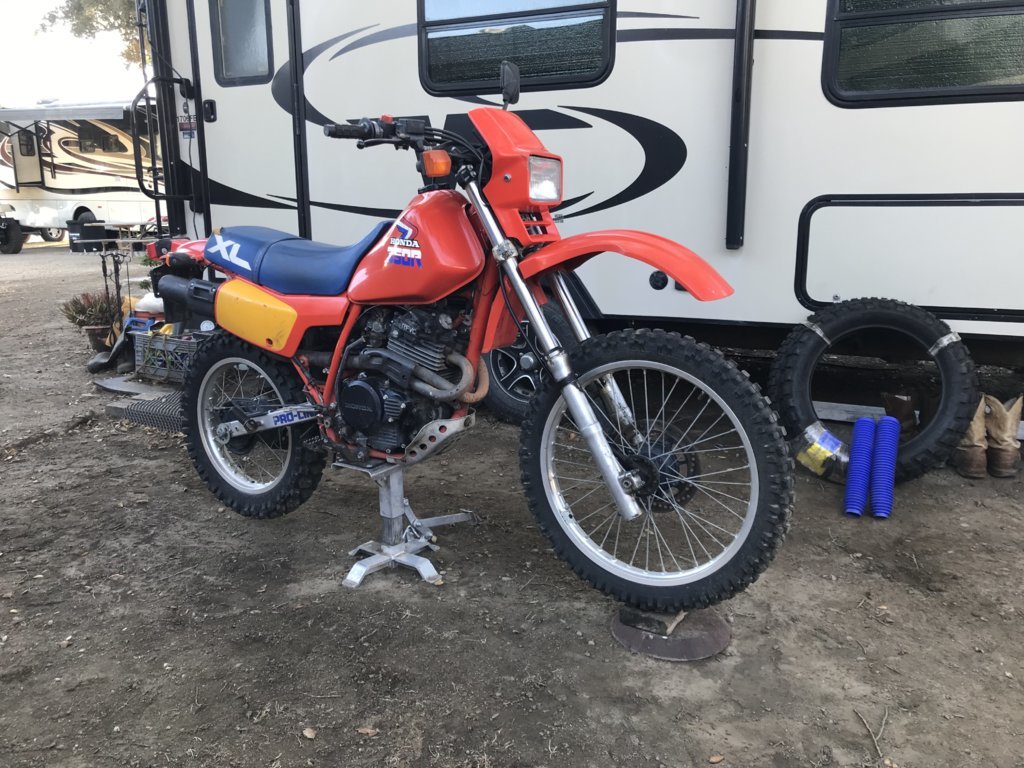

    My main goal is a little more power while occasionally dragging a 17ft Winnebago double axle travel trailer, with a 1985 Honda XL 350R in the back. ~5.5/6K pull and 400lb payload.

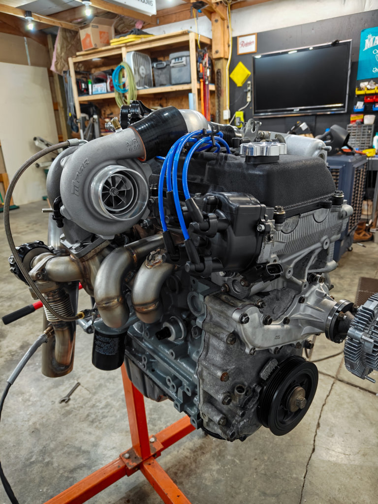

    I haven't looked at 3rz parts in quite a while so I can't accurately say if there is newer manifolds out there since then. But I can say that the Treadstone manifold was great, especially for the price. The only weird thing about it was the rear most bolt is tough to get to and you can't get a socket on it. I ended up grinding down a 14mm open ended wrench to get in there and tighten it down. As long as you tighten that bolt first then all the others afterwards, you won't have any exhaust leak issues. that is using a MLS gasket.

    My Treadstone recently cracked after 2 years at the wastegate flange. I'll likely buy another since I don't want to redo the downpipe and intake again. I found the bottom two nuts to be the worst. Could had to grind down a wrench to get enough of a turn to flip the wrench and get another 8th of turn. Oil filter housing is in the way too.

    I love the build quality and look of this manifold. Its a killer piece. I have two small issues with it however. It's very difficult to route an oil drain through this manifold at the stock engine tilt angle, and the wastegate is 2 90° turns off the runners, so wastegate priority isn't the best. They just take a little creativity to work around.

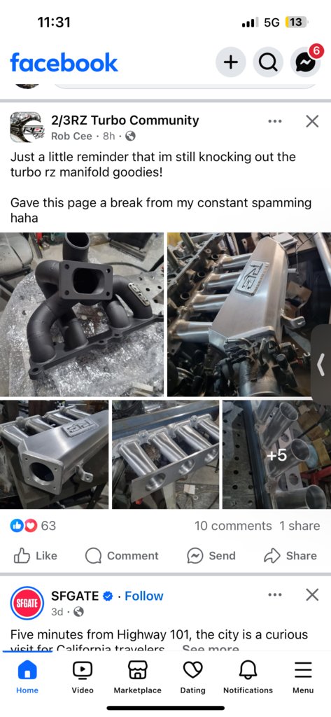

    This guys cut and shut stock intake manifold looks solid if it’s priced right.
    boostedka[OP], Torspd and 2RZNoShi1 like this.

    I have been thinking about doing something like this but using a Bosch dbw throttle body. Looks like a killer setup without having to spend 1500$

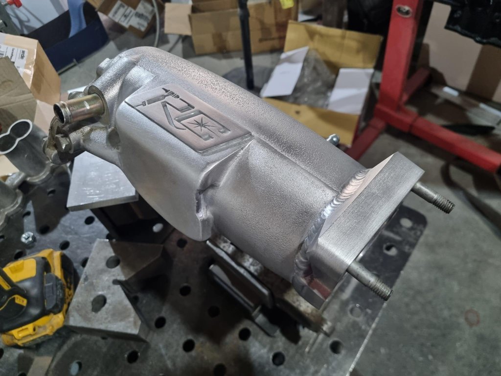

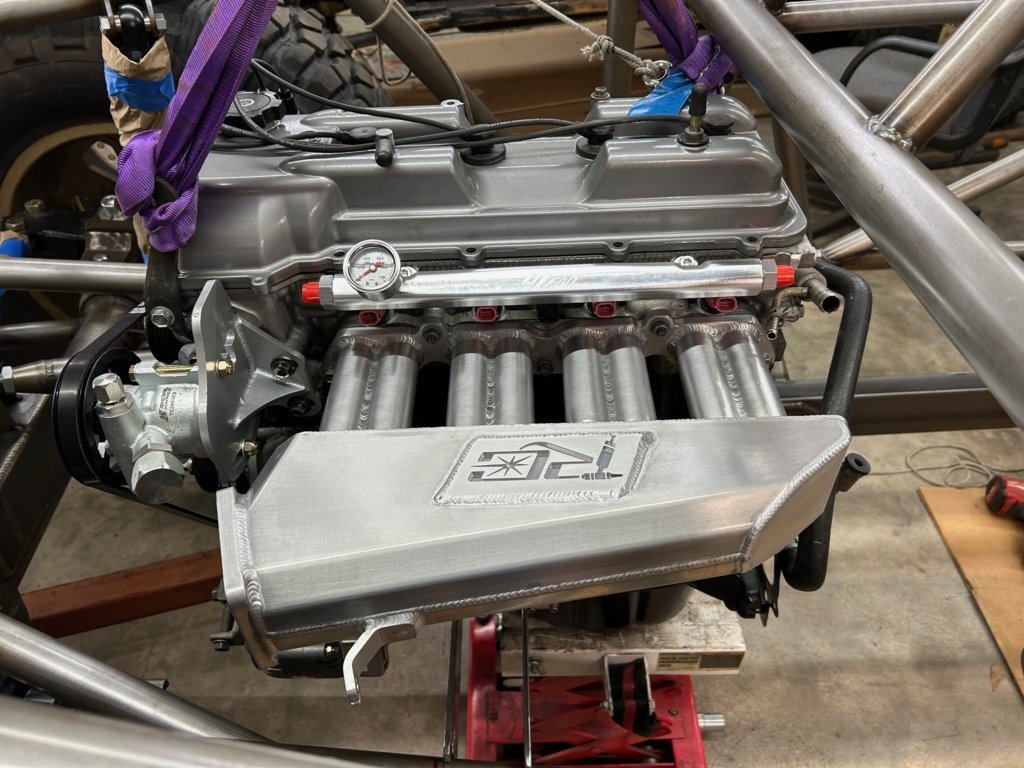

    His fabricated Front facing intake is 640 ish bucks shipped.
    Half the price of the GLF intake. Using one on my buggy build now.

    I might need to bug you for rough dimensions to see if it fits around my cage. Looks like it can handle an aftermarket PS pump. Sure is damn sexy. Thanks for the find

    No problem. It does fit around the Radial Dynamics TC pump I have with the Chillkat TC pump mount . The pump needs to be swiveled up in the bracket to clear the MAF though.
