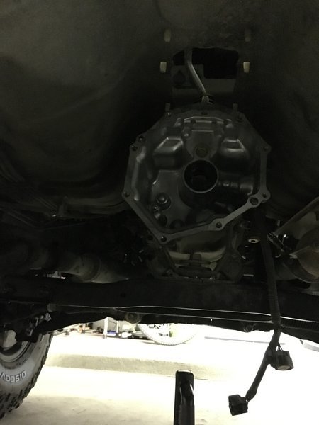

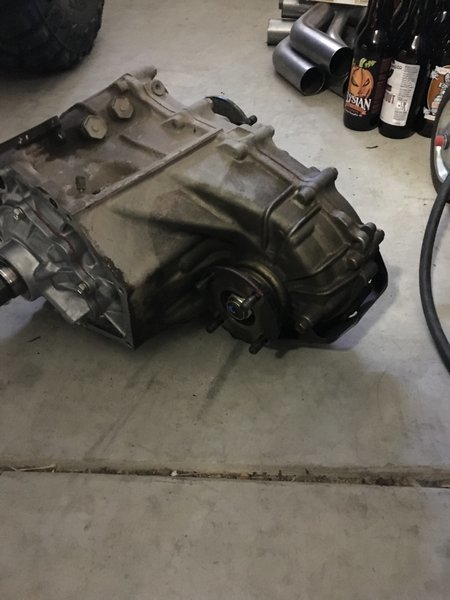

    James
    NM
    2013 DCSB 6MT, 2004 4runner
    Started working on replacing my clutch last night. Got the harness off, transfer case removed, and tranny unbolted. Just waiting for a buddy of mine to help me pull the trans off. I don't know if I should be concerned with the oil that seems to be slowly leaking out of my Tcase
