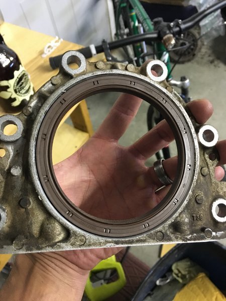

    I finished getting everything disassembled yesterday. Trans was a butch to get off. Had to shake the eff out of it to get it loose but it's finally off. I'm going to replace the rear mAin while it apart. I just need to figure out how to swap the seal out of the housing

    261
    Ernesto
    1996 Blue Tacoma 4wd 2.7L 5sp
    look at the replacement. should get a better idea as to how it goes on. from the picture looks like it might pop out from this side (push from other side)

    Nice observation. I just used a screwdriver and rubber mallet from the inner side and popped it right out. Looks like the new one should pop right in. Hopefully I can get some reassembly going on later tonight

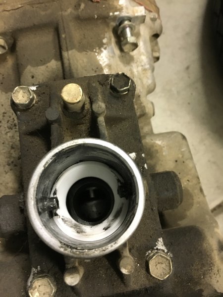

    For anyone that cares, I used this write up to help with this clutch project.
    https://www.tacomaworld.com/threads/better-clutch-for-2tr.144555/page-3
    The idea with the paper towels and the pilot bearing removal worked pretty cool. It did take a while and more paper towels than I expected. I jammed almost 3 paper towels in that tiny little hole by the time I was finished removing the bearing.

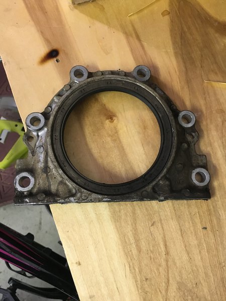

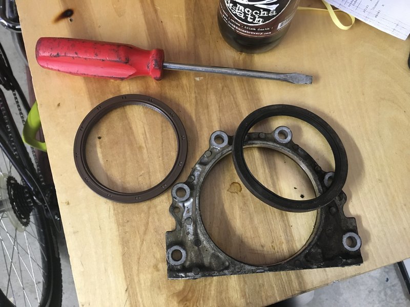

    I've been working on the truck here and there when I have a little time. Getting close to being back on the road again.
    Got the new rear main seal installed

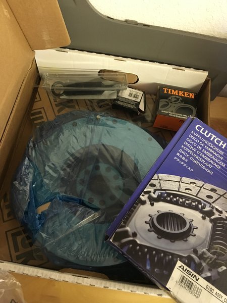

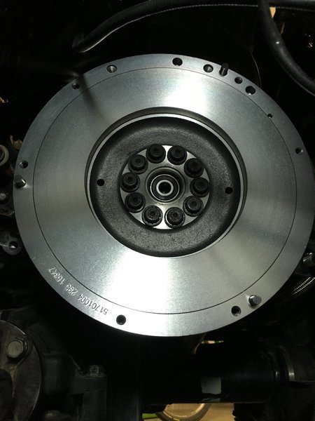

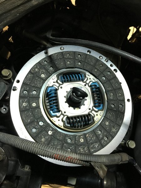

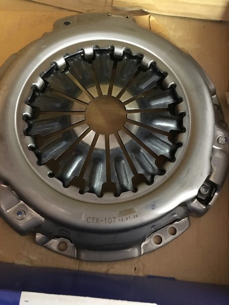

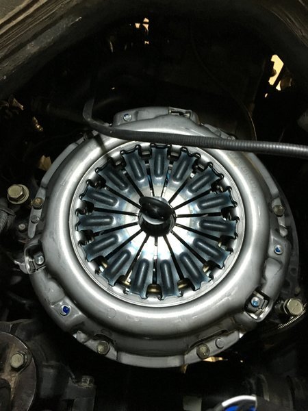

    New flywheel and clutch parts

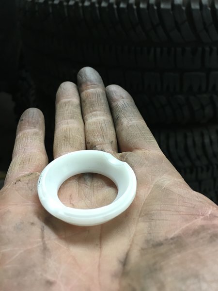

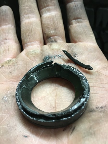

    While everything is apart, I'm also replacing the shifter bushing with one from Marlin

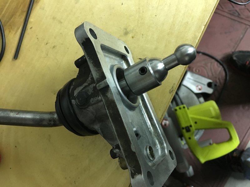

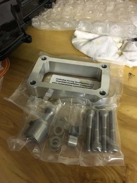

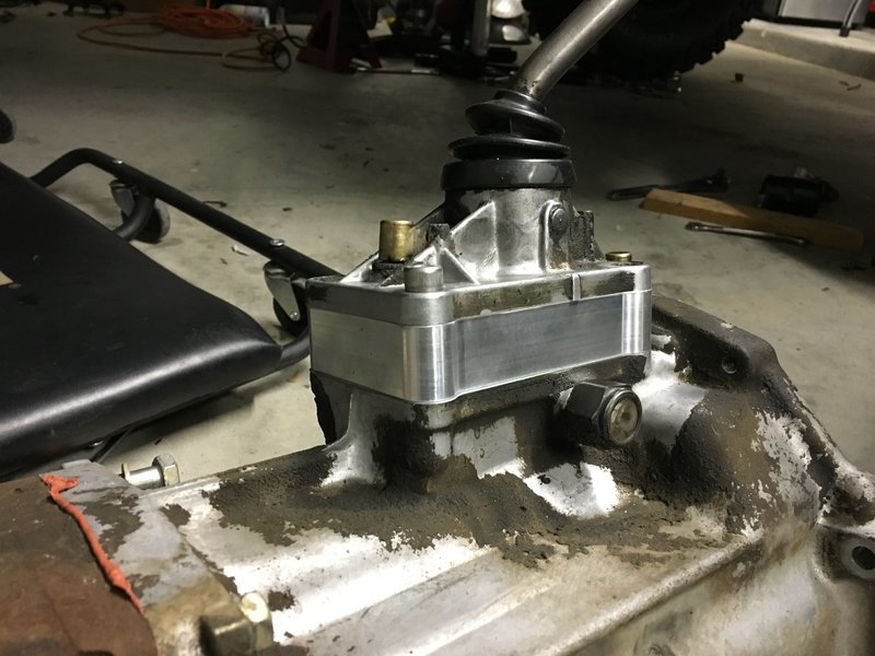

    Also installing a short shifter from URD

    i was gonna order one of these today actually. my shifter is floppy as all hell. let me know if its actually worth the money

    Will do. From what I read its supposed to really smoothen out the shift throw. After looking at the old one I removed, I can see why. The new bushing looks and feels like it will allow the shifter ball to glide slide around much easier than with the old rubber-ish one as well as just holding it place much more tightly. Mine was pretty tore up but seemed to not be as bad as some other reviews I came across online. Many people have said their old one was disintegrated into pieces.
    Their only about $11, but if you're not ordering other stuff at the same time, shipping doubles it. They're also sold by lowrange and LCE as well if you happen to be ordering parts from one of them at the same time
