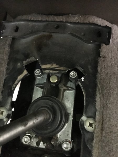

    Got everything all buttoned up last Night. I had to notch out the cab metal around the shifter to access the mounting bolts now that the URD spacer lifted it up about 1.5". Drove it tonight and everything seemed all good. Clutch pedal pushes in much easier now that everything is freshly lubed. It shifts completely different now. With short shift kit and new bushing. Much smoother and significantly shorter. It clutches and shifts like my wife's integra now. Pretty fun! :burnrubber:

    @boostedka how you liking that urd short shift?
