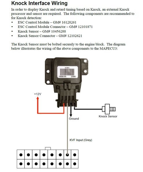

    Thanks I'm going to copy this for reference. I'm pretty sure I can find a pigtail connector on summit racing. Also if I can remember my ct account I'll pm Kirk about the knock sensor because I want to wire it also to my mapecu3 for logging. When I jump back to this motor tuning. I'm going to nail out a bunch of stuff on the engine all at once.
    Here is what mapecu says to use to read knock. Pretty sure the module can read a SU1075 or SU4669. The knock sensor they use is for a ls1

    That's looks like pretty simple way to log knock signals. I may do that if I end up going with the mapecu. I wound up getting the 1075 knock sensor. I was able to get both the sensor and the pigtail from Autozone. The duralast sensor is manufactured by wells just as most others are. I think it was around $40 for the plug and sensor. Now I just need to time to install it.

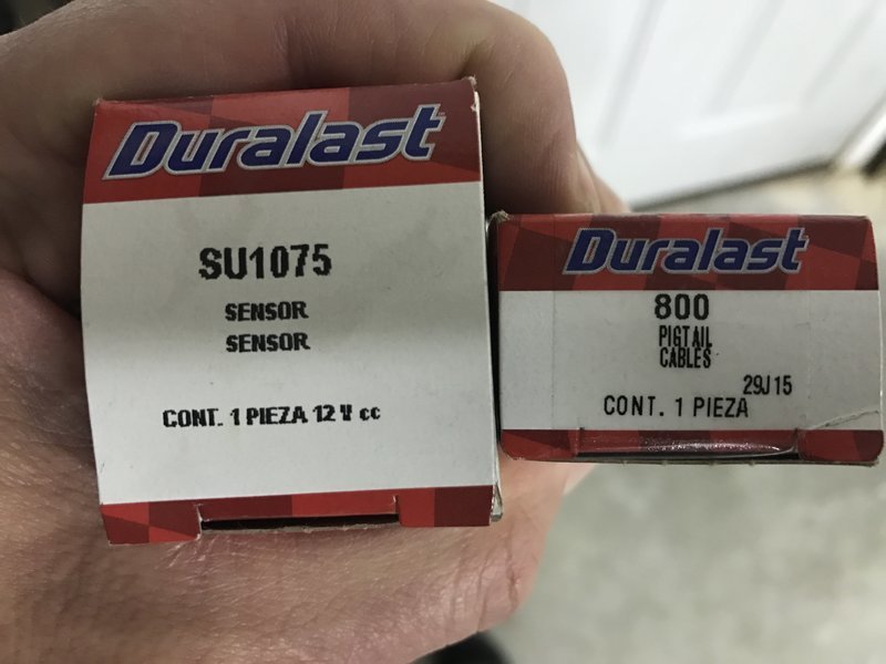

    Is the pigtail the same as the linked one I gave you? Or maybe you could give me the auto zone part #. The part store guys all snort glue I think.

    Here's a pic of the part numbers on the side of the boxes. The box on the right is the pigtail
