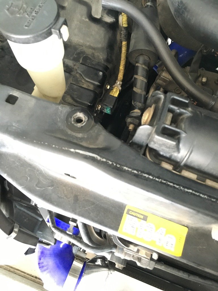

    Next up was an alarm system. After my truck was broken into a month ago while i was MTB'ing, i decided I at least needed something to deter losers. So I installed a Compustar system. Shit load of wires but was actually pretty straight forward. Used this website for what wires to tap into: http://www.the12volt.com/installbay/vehiclewiring/3/yeard/Toyota.html
    Then I took the hole saw to my front bumper to get some more air flow to my IC

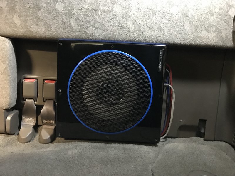

    Last night I also got around to doing some low budget stereo upgrades. Since I already had much of the dash disassembled from the alarm install, i figured I'd do this as well. I had a Pioneer single din that i had gotten from Crutchfield for cheap a while back. I had it running a set of JBL components i scored from eBay and some JBL 3-way Coax's in the rear that i got for cheap off Amazon. I found a deal on a factory refurb 4 channel JBL amp from the Harman site to run all 4 speakers. It's a 50x4 RMS @4ohm and 75x4 @ 2ohm. Since all of my speakers are 2 ohm coils, I am able to get a decent amount of power from a fairly small amp.
    Since my sub was stolen during the break in mentioned above, i also got new one. Trying to stay on a low budget with this I went with a Rockville RW10CA after hearing good things about it from @WildLand. Install was pretty straight forward. I just used a distribution block to run power from the under the seat amp to where I planned on mounting up the sub.
