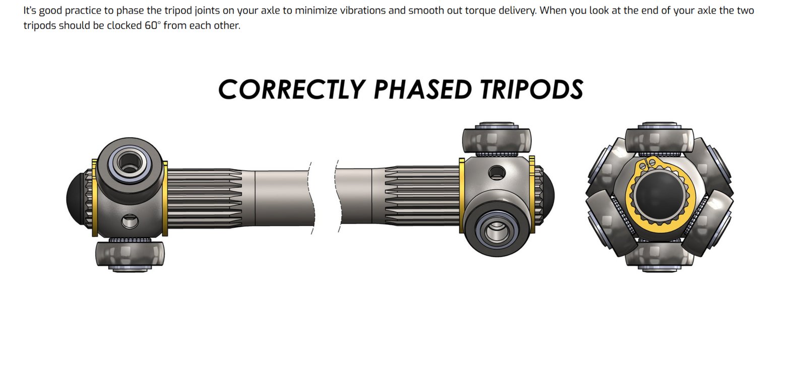

    somehow came across FSAE page saying make sure axles are clocked
    Does this matter?
    Probably didn't do it when I rebooted. Never once seen mention of it in a repair manual ever.
    Far as I'm aware, no issues. Same for anyone else.
    without tracking it on purpose during a reboot, I doubt it luck lands it on like this.
    seen maybe a whole 3 people on the entire internet say to do it
    if it was a thing, I imagine it'd be known.

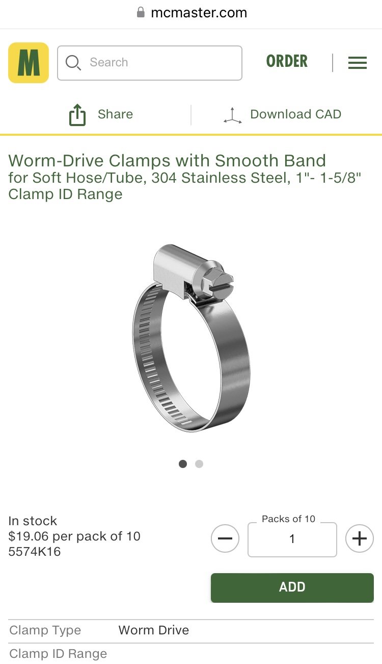

    does anybody know what size oetiker clamp to use for this
  17. Apr 19, 2024 at 9:24 PM

    It's probably applicable if you had independent rear suspension with rear CV axles.
    The front CV axle has a birfield type outboard joint to accommodate steering angles, while the inboard joint is the tripod type. The "phasing" is therefore moot.

    Is this what you’re looking for ?
    1 5574K16 Worm-Drive Clamps with Smooth Band for Soft Hose/Tube, 304 Stainless Steel, 1"- 1-5/8" Clamp ID Range, Packs of 10

    My FI motorcycles use oetiker clamps on their Fuel system, it's common for people to replace them with worm clamps because that's what they know, they work but often tend to chew up softer and thinner rubber they they are clamping. Where it matters and the rubber is thin you will rarely see a worm clamp installed by a manufacturer.
    Not trying to insult anyone's method but a real mechanic would frown on using a worm clamp on an axle shaft. Personally there's no way I'd use a worm clamp there unless it was an emergency repair. Nothin says shade tree like the wrong clamps. Worm style are more common on radiator plumbing but not on axle assys. There's a reason these style (oetiker) clamps are widely used in these type applications across almost all manufacturers, it's impossible to overtorque them and they are far gentler to the item they are clamping.
