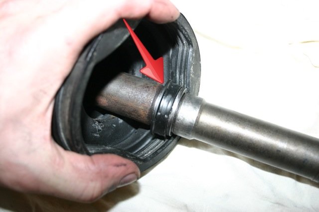

    The only way the glue method can be reliable is if the surfaces are absolutely clean. This is nearly impossible unless the boot is removed completely. Any grease contamination will compromise adhesion. Even the residual "mold release" wax clinging to the rubber can cause problems. Then there is the issue of re-clamping the boot on top of the shoulder of the groove. The shoulder acts like a taper and the boot "wants" to slip back to the groove, the tighter the clamp the more it wants to slide back. Sliding the boot all the way onto the "flat" portion of the shaft is too far.
    For maximum reliability I once recommended that folks do this job (glue method) at the time of a re-boot so things could be good and clean and the weatherstrip adhesive given a chance to air dry a few minutes before assembly. "Good and clean" in this case means lots of rubbing and solvent with any paint removed from the shaft. "On the bench" also allows a good eyeball on just where the boot is placed with respect to the groove shoulder.
    3/8"-1/2" at the most is all that's needed to keep the fins apart. Any more needlessly stretches the boot and has led to tearing. "Older" boots seem to take a "set" with age and can tear when stressed beyond their accustomed range, start with a new boot.

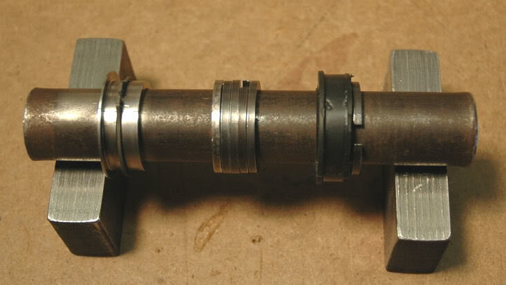

    Enter the "internal stop". This is nearly foolproof and allows the clamped area of the boot to sit right on top of the groove shoulder. The clamp need only be tight enough to prevent grease seepage.
    This is the preferred internal stop. It's the (small) end of an old boot backed up by an old inner "tulip" joint c-clip (not my pic). Also see the pics in my original TTORA posts.
    The red arrow below shows the shoulder of the groove in question, boot stop placement and also some caked on "mold release" agent previously mentioned can be seen coating the boot.
    Questions, just ask.

    I don't know what to tell ya other than the internal stop is the best bet. Glue has worked for many folks over the years, but then lots of folks have problems. The "mold release agent" can be pretty tenacious. 2 of my 3 shafts are "glued" and have seen 200K and 13 years.
    As I mentioned the internal stop is the way to go though. The quickest, easiest one is the old boot end + old c-clip seen at the right in the pic below. All kinds of things could be used, I mentioned a few in the TTORA thread.

    OEM inner boot kits come with new clips, all 3. You might notice the stack of tulip joint clips in the middle of the previous pic. You could pick up something equivalent at the hardware store. It just needs to be snug on the groove.

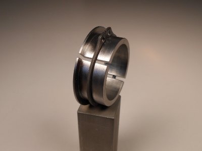

    My initial concept was to use an off the shelf 2 piece shaft collar but never followed up on it. Just broke out the lathe with dreams of going into production, founding the boot stop fortune.
