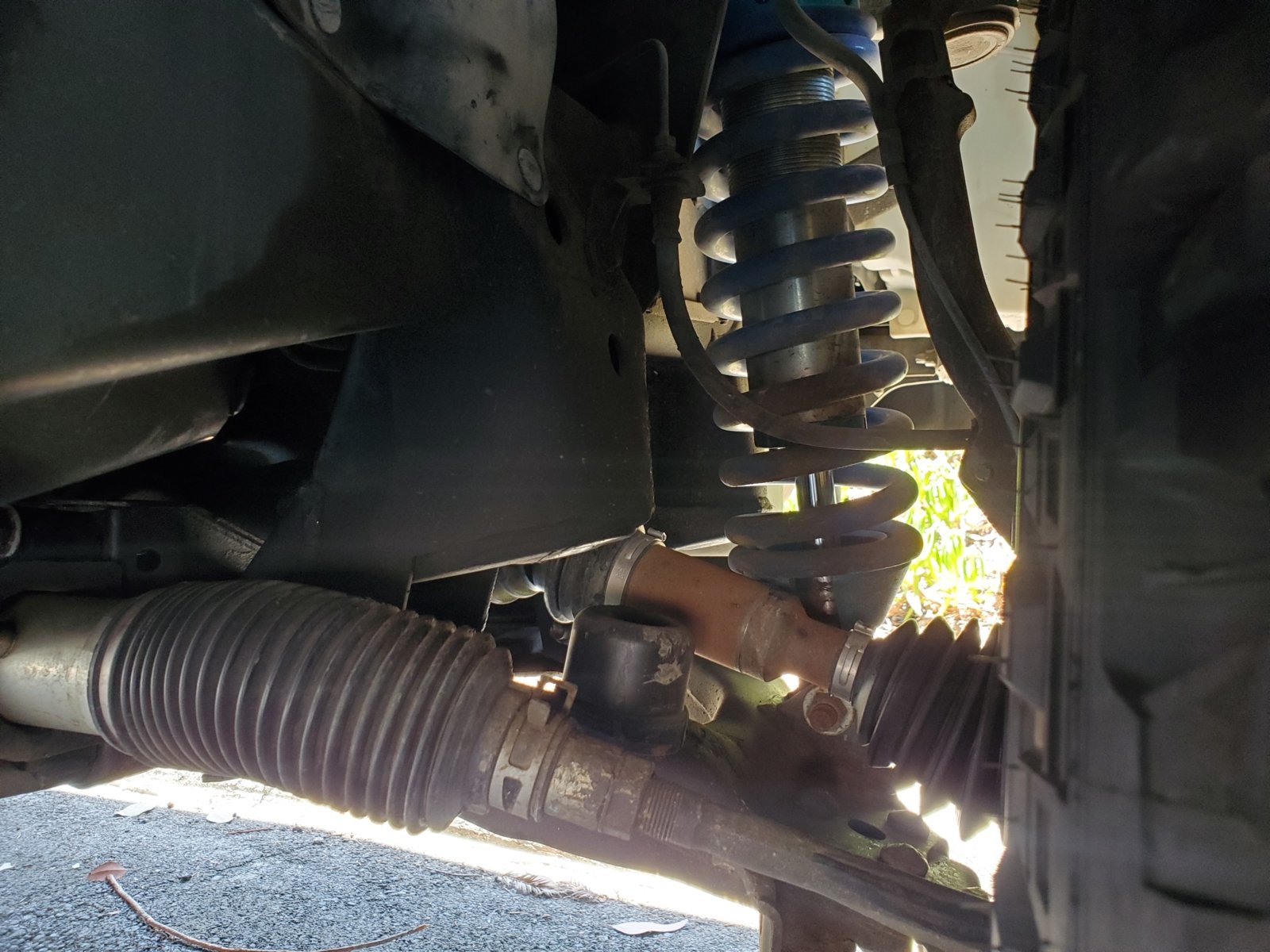

    It was very close on both sides; then one day a neighbor slightly tapped me while at the mailbox knocking my alignment off a hair
    I got it aligned the next day, but for the moment the cv axle did scrape the bottom backside of the coilover
    But with an alignment, as you mentioned, no issues

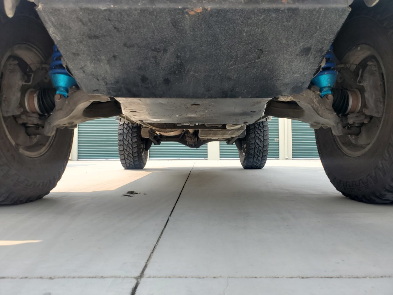

    Here's when it did make contact - I had work that next day so that meant being on the highway and driving it like this for a bit

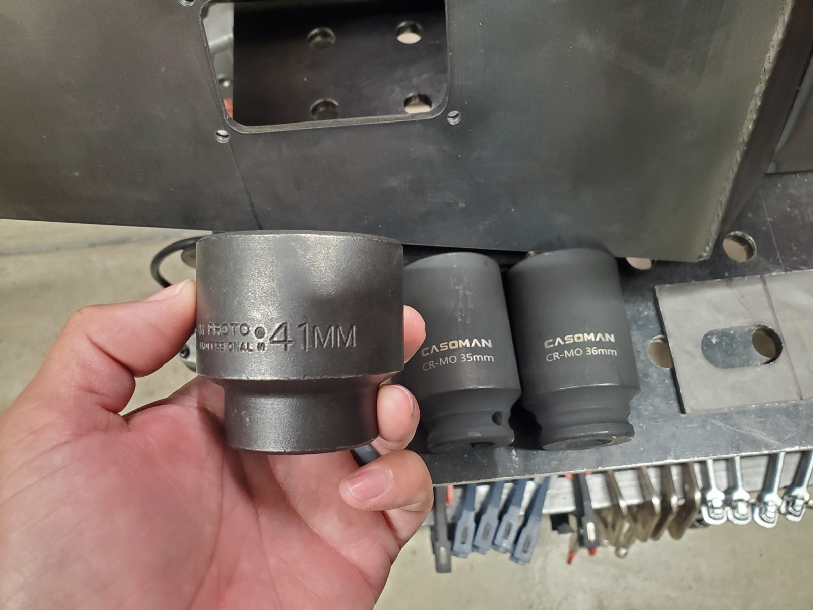

    To whoever has had experience with these: Do we know what size the axle nut is? I could just go out and check, but I'm lazy lol and want to know if I have the right size before tearing into it.

    It's for sure one of these:

    35mm or 36mm for factory, and 41mm for O'Reilly's ext cv axle
    So technically, you're wrong :luvya:

    well good thing he asked then. 41mm .. jesus... who even has one of those other than you?

    I'm sure if I had gone to a tractor store or the sort I could've found one, but not at any automotive parts/tools places.
    Had to order mine online just to install my cv axles.
    Even though that 4R is gone, I still have the socket "just in case" :rofl:
    Worst part? I've never used it for anything else :bananadead:
