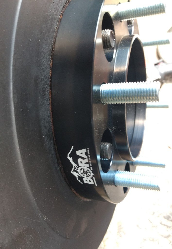

    Adding pictures so other members can see what the 1" spacers look like when mounted on the rear of a 1999 model Prerunner.
    The lug studs stick out beyond the spacer rim. I can't run these with the Pro Comp Series 51 D Slot steel wheels. So I will be selling a set of 1" BORA spacers.

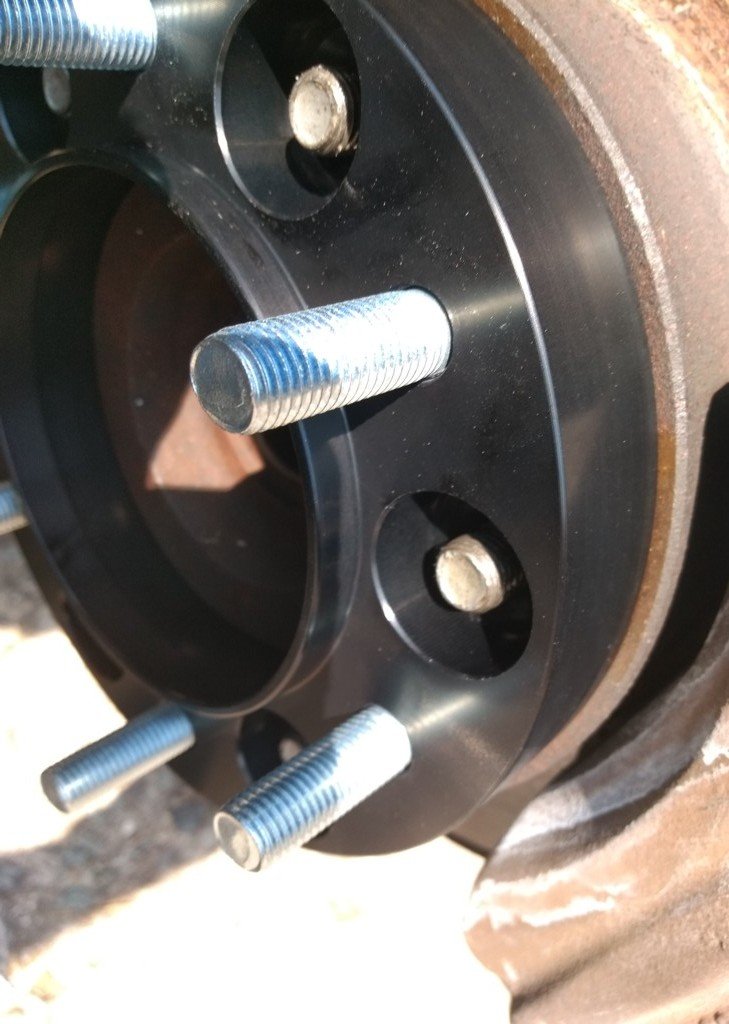

    Here's a picture of the 1" spacers mounted on the front. This is the perfect depth for the lug studs.

    I'm thinking some people don't have issues with 1" in the back because some wheels have "insets" between the lug holes which clear the end of those studs. Obviously you found out that your wheels don't have those. A lot of aluminum or alloy wheels do though.

    Yep, that's it in a nutshell. It's needing a completely flat mounting surface for the ProComp 51 Series D Slot Steel Wheels that presents the issue. Any other wheel with "insets" will not have the issue. So for running those wheels, you have two issues: 1) They rub against the caliper that requires spacers, 2) Spacers have problems with the longer lug nuts in the rear.

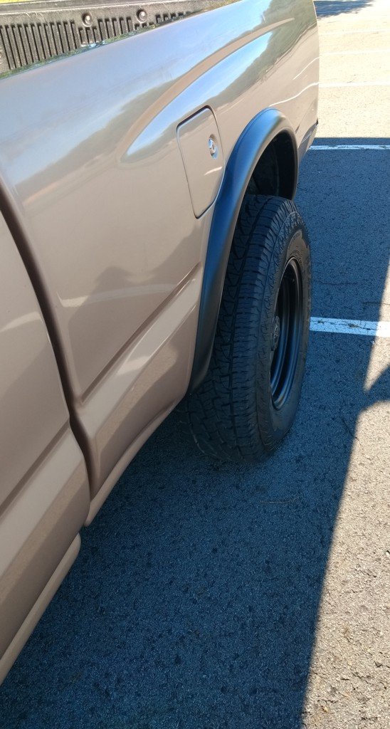

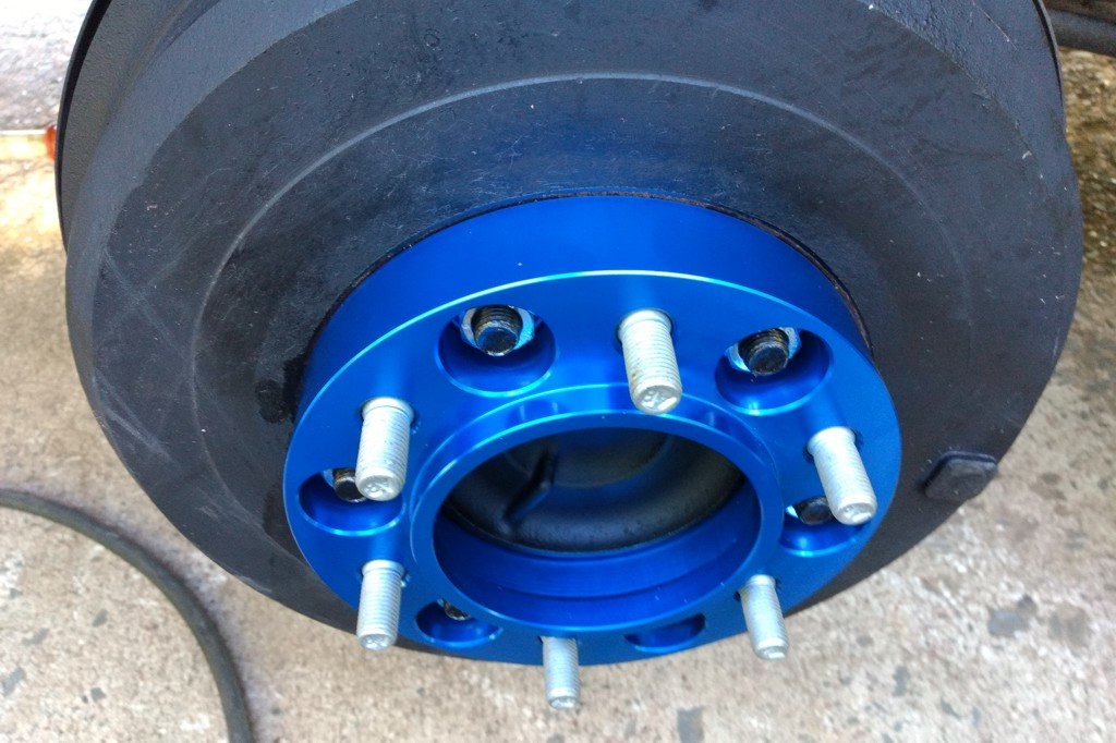

    Good news. The Spidertrax 1.25" arrived today. Perfect fit. I want to close this thread with a conclusion and a happy ending.
    This is complete a "bolt-on" solution with no lug stud cutting or swapping. The Spidertrax 1.25" compliment the 1" BORA spacers on the front. I get a little extra width on the rear. I like the way it handles. More like a G35 coupe. Ha!

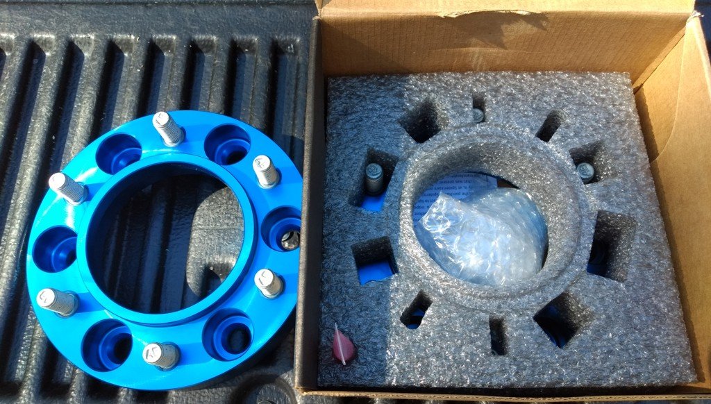

    The Spidertrax look to be a very well made product. They come nicely packaged. Threadlock and instructions are included
    Here's the perfect Spidertrax 1.25" fit on the rear.

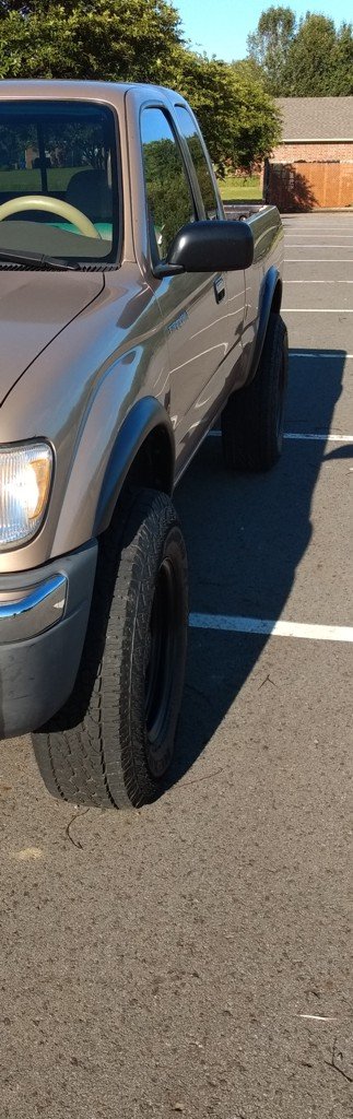

    And a picture of the perfect fit with BORA 1" on the front.
    And with the Spidertrax 1.25" spacers on the rear.
    Front and rear view.
