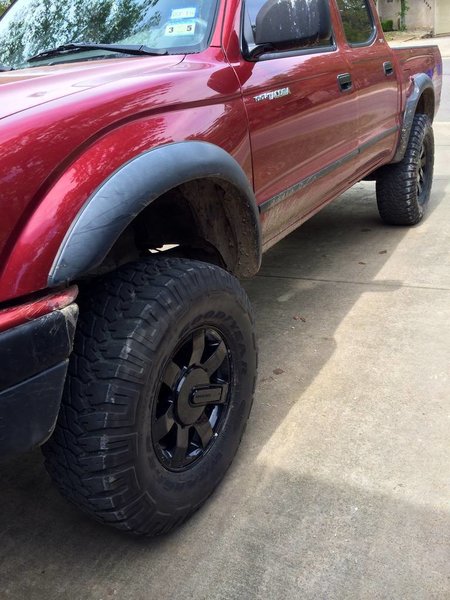

    Mostly on the tire mounted to see a before and after pic if that's available

    What size? I have 1.5" that I've been using for about 3,4 years with no issues off road, dd, and highway miles
    Old ass pics
    New tires. They push them out a great amount.

    An alignment shop along with Wheelers said rubbing on my UCAs from my new 285s should stop with spacers. Just trying to get a warm and fuzzy from my TW community that 1.25" spydertrax is enough to alleviate this problem I have :)

    It should definitely be enough. My tires would be pushed further out with different wheels. Considering they have a 5.5" back spacing. No rub.
