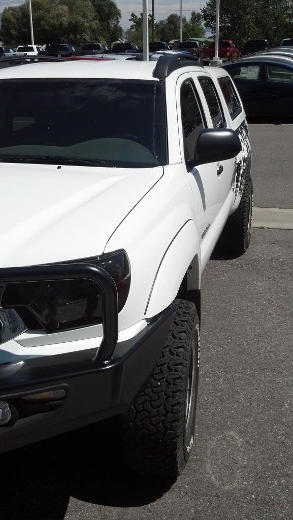

    installed.
    Had to really go at one of the hubs with wire brush to get some buildup off before a spacer would go on it. The other 3 went on with no trouble really.
    Tighten things slowly and watch to make sure they center themselve rather than sticking. I had to rock one of the wheels a little to get it to center up while tightening the lugs. May have been a fluke though because after the test drive and rechecking torque on acorns, the wheels/lugs went on smoothly.
    and... pictures.
    Trick to tighten fronts.
    rear view
    front view
    inside view, much better clearance now.
    truck is on stock trd sport 17" wheels with 265/70-17 tires and OME/Dakar 3 inch lift. Now with 1 inch BORA spacers all around.

    Looking good! nice trick to tighten the fronts, will help people for sure.
    I'm glad they gave you that extra clearance, I've got a very similar setup and my UCA's are like 1/2" away from the tires. Hopefully my 3/4" spacers will give me that extra clearance!
