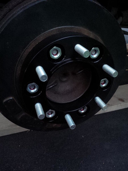

    I worked on a co-worker's rig most of the day but managed to get the rear spacers on as it was getting dark out... will do the fronts tomorrow. I did 83 ft lbs on all lug nuts.
    Found out the GDMF shop that my wife took the truck to for inspection LIED! They said the rear brakes needed to be replaced. The shoes are within 1/16th inch of the new ones! This is obviously one of those shops that tries to take advantage of women. I have pics of the new next to the old shoes. BASTARDS! Well, I have my next set of shoes and pads already bought and paid for.... Wagner PosiQuiet shoes and the same for the pads but in Ceramic.
    I'll post some pics tomorrow when I finish the front. The back looks GREAT! Hope my test ride doesn't yield the same results as a couple of you. I know I have the lugs all on correctly... dome toward the brakes.
    ***EDIT*** Added these pics tonight. First, shot of OEM shoe vs. new shoe.... next two are the rear spacers mounted. :cool:

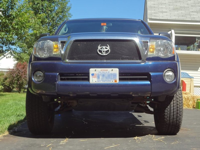

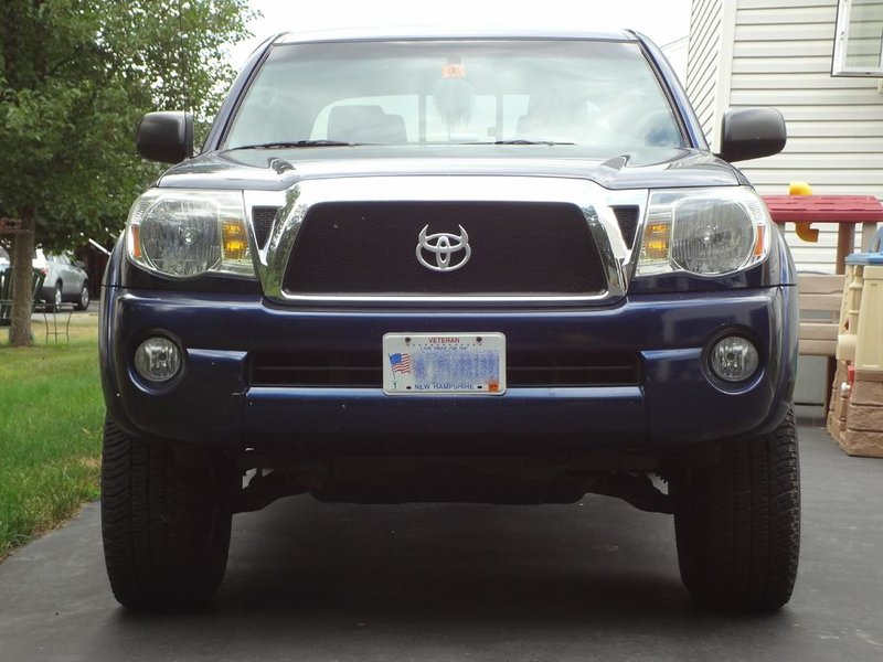

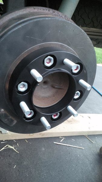

    Put mine on last week. Did the final wheel retorque yesterday. I had to trim the rear studs 1/4 inch.
    Fronts:
    th_55821faaec92730683a89c9c5cbee0f4_zps5_f5d5ff9d2ebb7c39c2dce63631687f50f28b1feb.jpg th_47f17d09bb5fbffcf11cb68ff6d1355b_zps6_d6b5d903b3b4ed325e4436f6aaad7cd874a90806.jpg
    Rear:
    th_0ecf9aa14bcaf6367996c37a935746b2_zpsf_e9a3946ede2a84a0dd4127e8aeb42b6af0b59927.jpg th_56294867e63bf419855b2b9185d9a47b_zpsc_4082f79e78fef1c91bad34260b6cac2ab7236857.jpg
    Before:
    th_9785cf040f2eec6d604fda99beb828dc_zps0_f87f032489390537a77479355616a36ec3744a0e.jpg
    After:
    th_01ad4c10e764f8df046217acaf39129f_zpsa_2ce5ed9a0655da76419aa3b7d135f474e501f998.jpg

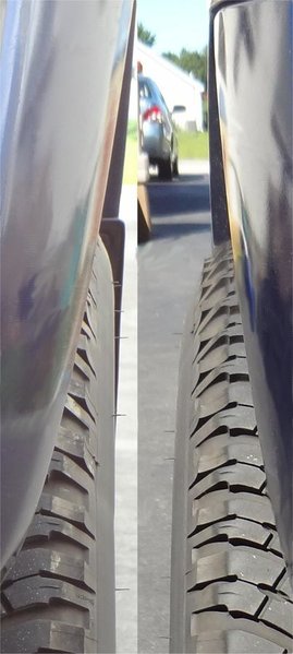

    Here's a side-by-side of before and after for the 1.25" spacers. Love the new stance! Thanks Lenny!! And thanks for this group-buy!
    Last two shots are before and after...
