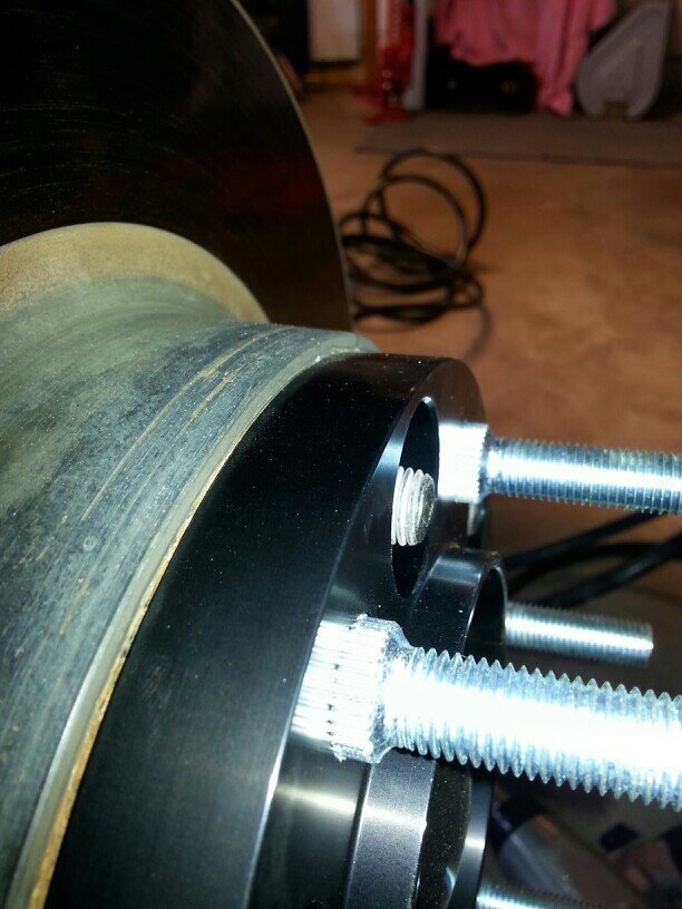

    So I will be calling Lenny on Monday. Because of the extra long shank on the stud where it presses in it is not allowing the wheel to make full contact with the spacer face. This puts all stress on the studs instead of on distributing it across the face of the spacer. A Toyota tech and a mechanic both state that is unsafe to run them this way. Hopefully we can figure something out. egy9a6ah_3531c40778e25fd18726fbac6e3d4ae5992f9f7a.jpg

    Nah but there is no way the non threaded part should extend past the spacer like that. I got 1.5". Definitely not right IMO. If you think about it when the lug nuts are fully tightened they would be almost touching spacer.

    Spoke to Lenny this morning and it appears they put the wrong length studs into them. He is mailing me a new set today and a return label for the one's I have. Stand up customer service for sure.

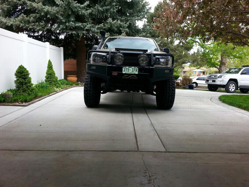

    Before with Spidertrax 1.25" spacers.

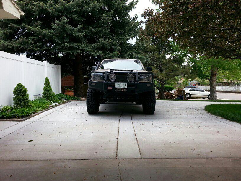

    And after with the .75" Bora spacers

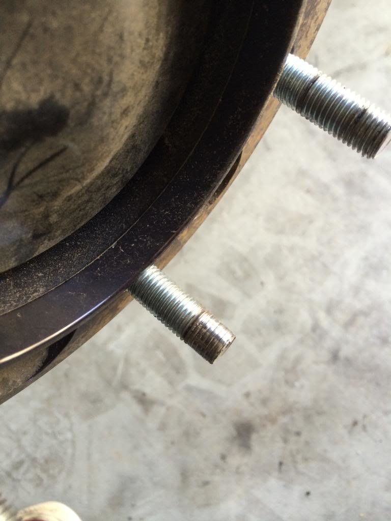

    Just for fun I'll add this... Idiots at wheel works SJ destroyed two lugs on my spacers. Ended up replacing them myself... Was pretty easy. Here is the 1.25" with new 3.75" bs wheels and 33x12.5:
    And this is one of the lugs the dude effed up:
