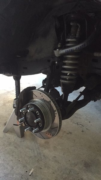

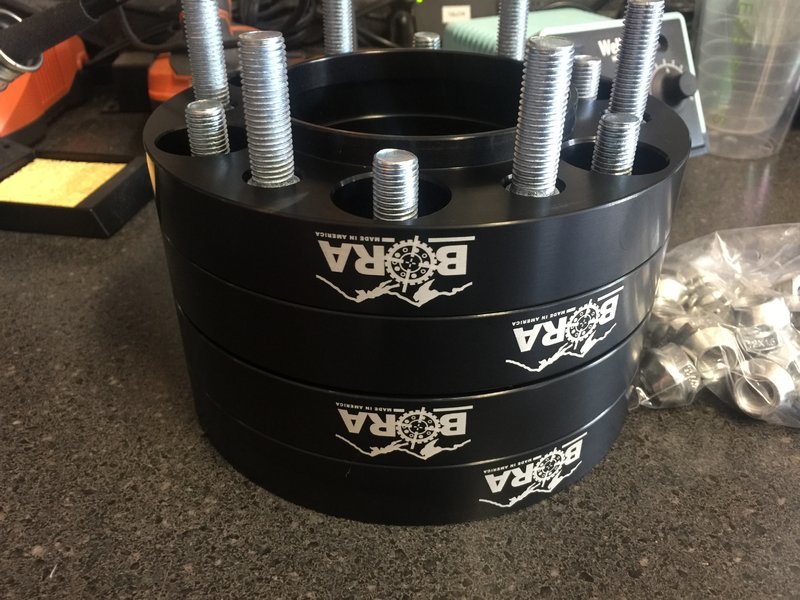

    Confirmed the 1" fit without any need to trim lugs and with plenty of thread engagement. See attached pic below. :thumbsup:
    I'm no torque nazi. I zipped mine on with a cordless impact. No lock tight included in the box and none added by me. If you're a torquer just do em to the same as you do your lugs and you'll be fine.
    Mine are 1" and fit perfect. See attached pics.
    Before & after. Not too dramatic and not the greatest pics. But pics none the less.
    Before
    After. Looks like positive camber, but its just because I lowered it off the jack. My camber is zero.
    Showing the thread engagement here and not needing any mods the the stuck studs.

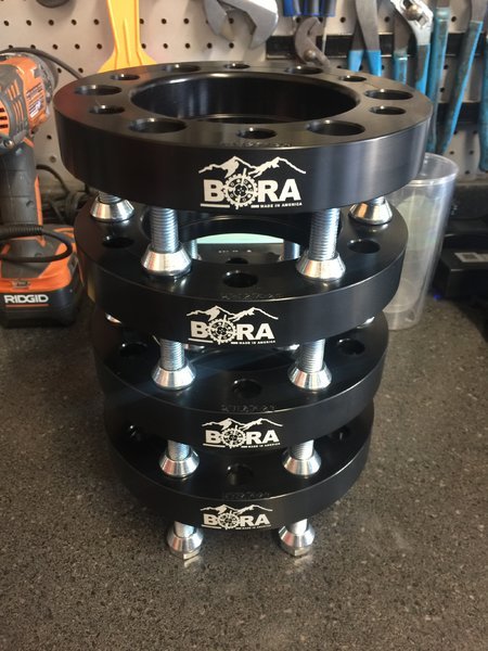

    Looks good..I'm recieving and maybe installing my .75s today
