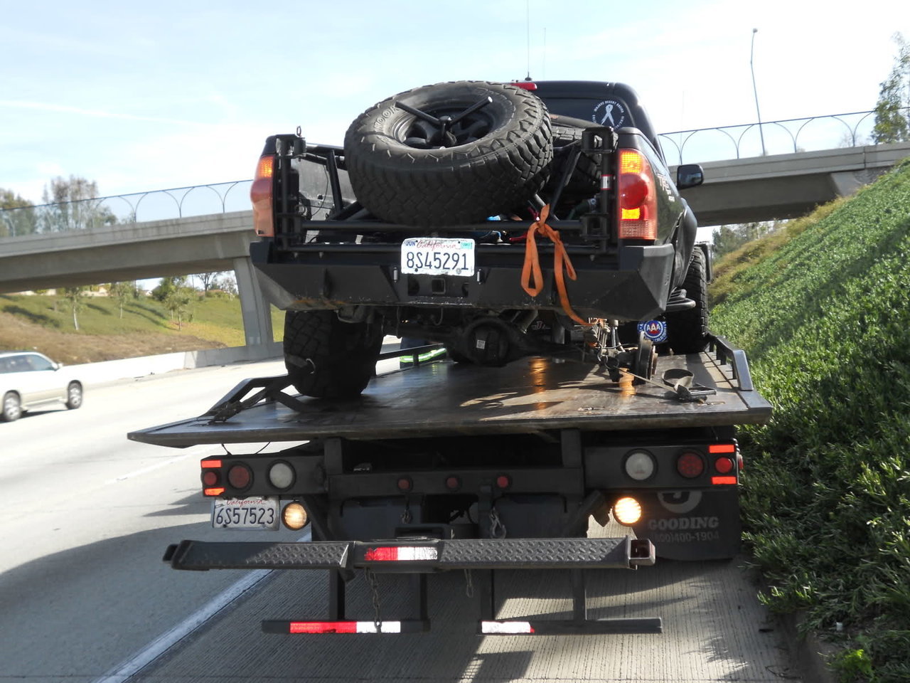

    My studs were over-torqued EDIT: stressed (since members are posting this pic claiming it was caused by over torqing my lug nuts) plus add the number of times I have taken my wheels on and off caused catastrophic failure while driving on the interstate ..

    did the studs shear off?

    Sheared right off..from the second it felt like something was wrong to the tire actually coming off was seconds..sucked ass chasing a loose wheel down the side of the interstate
