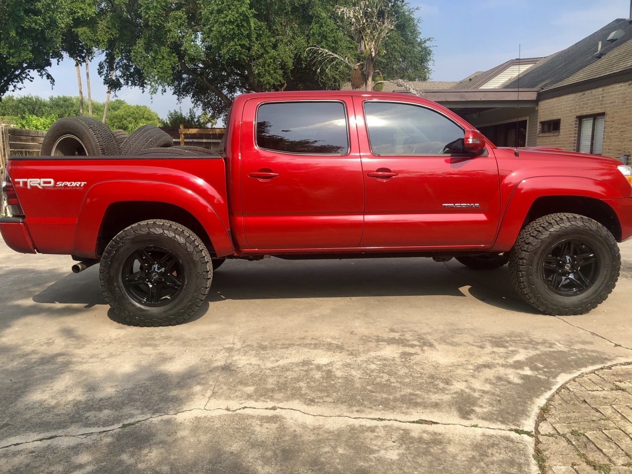

    Purchased 2015 Tacoma 4wd Sport Dbl Cab with 75K miles for my son's (16) first vehicle. One owner with no accident history. Color is Barcelona Red appears to be bone stock except for a basic spacer lift on front and rear and window tint.
    Picture of my Border Taco as purchased from dealer
    LET THE MODS BEGIN......3 days after purchase
    First mod was new wheels, replaced the factor sport 17" rims with American Outlaw Lonestar 17x9 with -10 offset and 275-70-17 KO2's. Spacing was tight but they seemed to fit ok given the spacer lift installed.
    New Shoes installed.

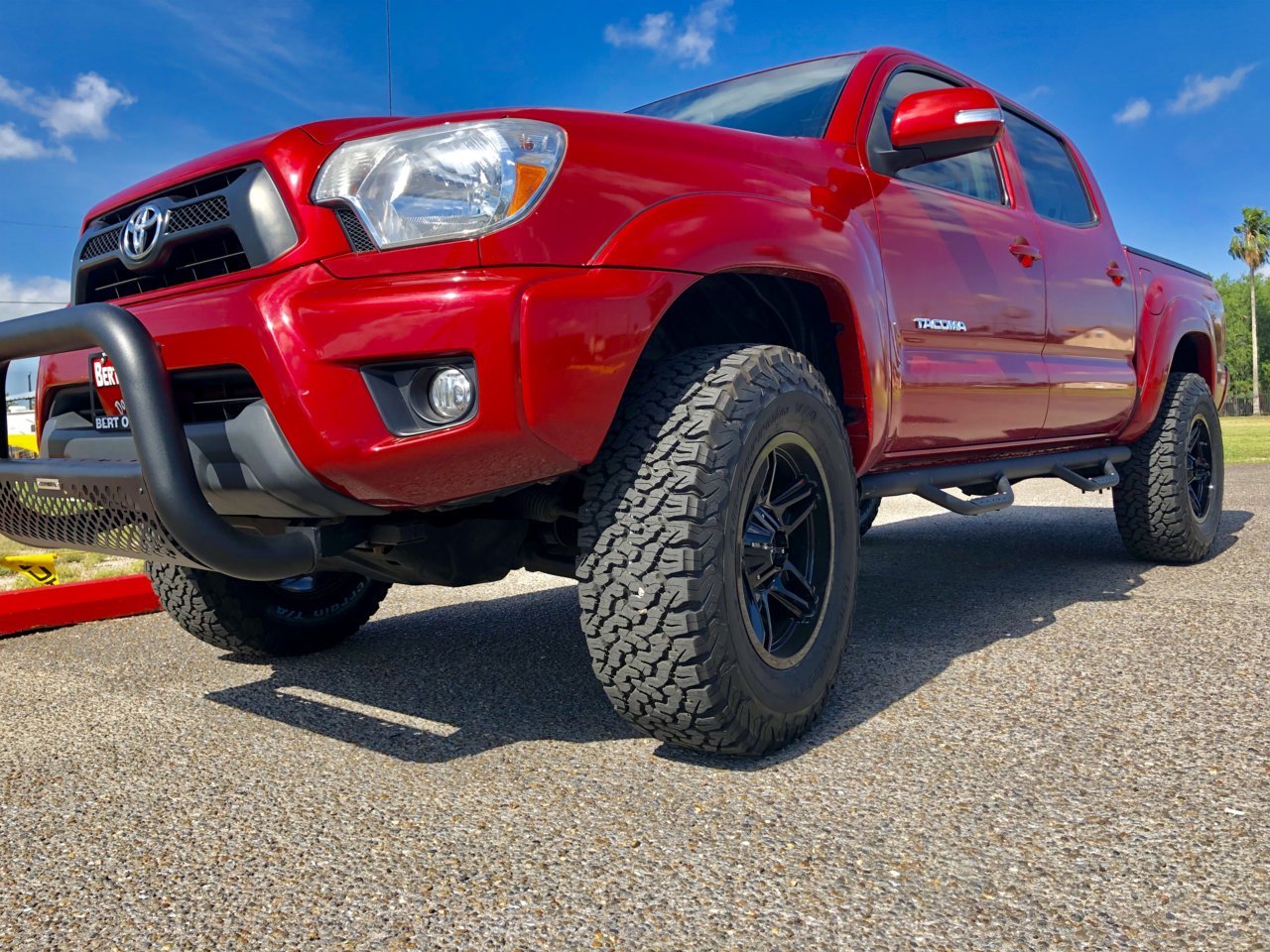

    Net up about a week later it was time to add some steps for mom and a bull bar to accommodate a light bar in the future. Installed the GoRhino Charger RC2 Bull Bar and GoRhino and Dominator D2 side steps. Given we don't have much of place to off road in our slice of heaven in South Texas I opted for steps instead of rock sliders.

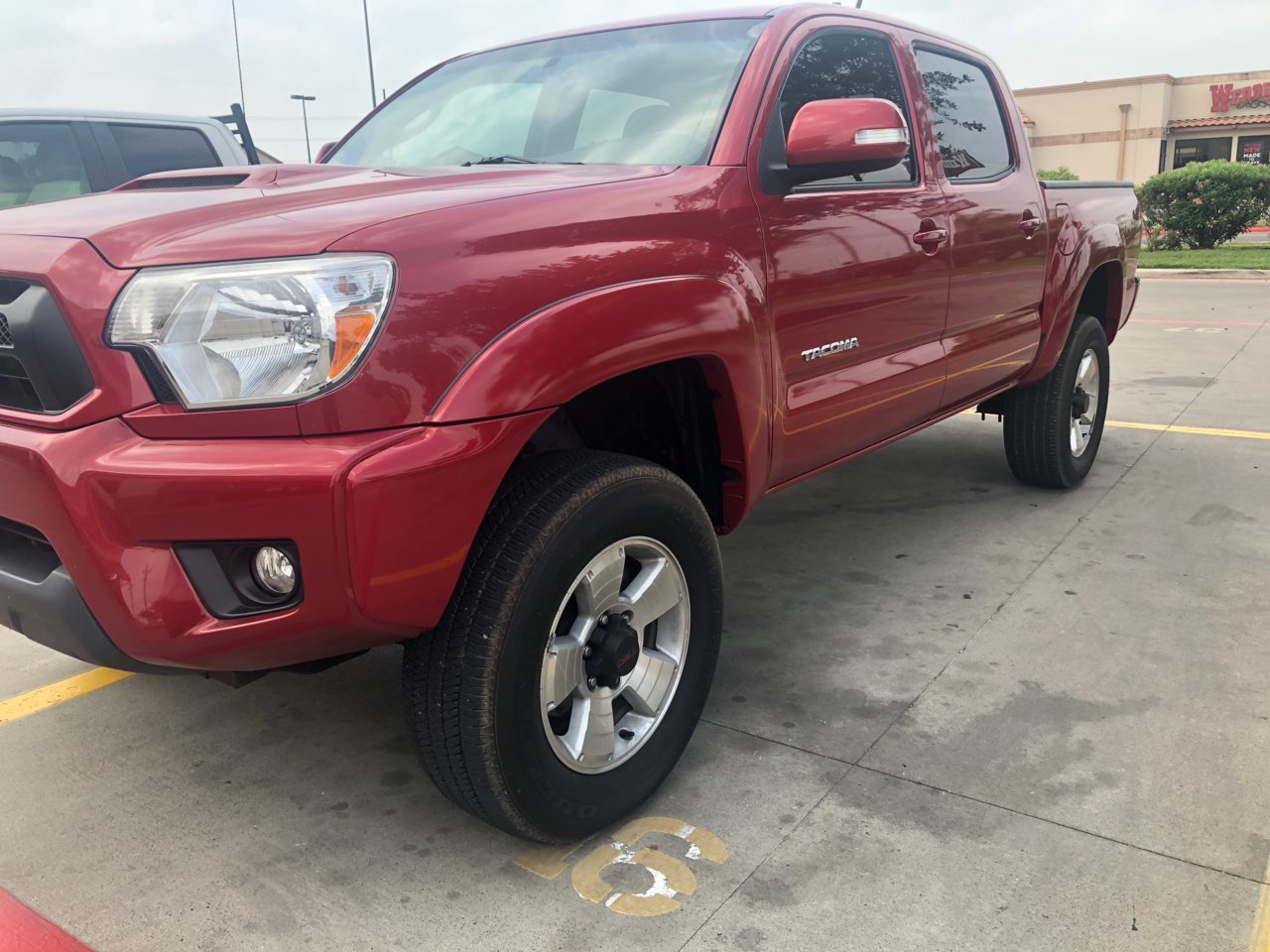

    Wheels - Began to notice some slight rub on passenger front when a full lock in reverse, damn. But then again YEAH new suspension upgrade in the future. I also begin to notice I am driving "my son's" truck a lot more than my 2019 Sierra AT4, lol, and future mods considerations are becoming more substantial....thinking over-landing would be perfect for the hunting lease this winter.

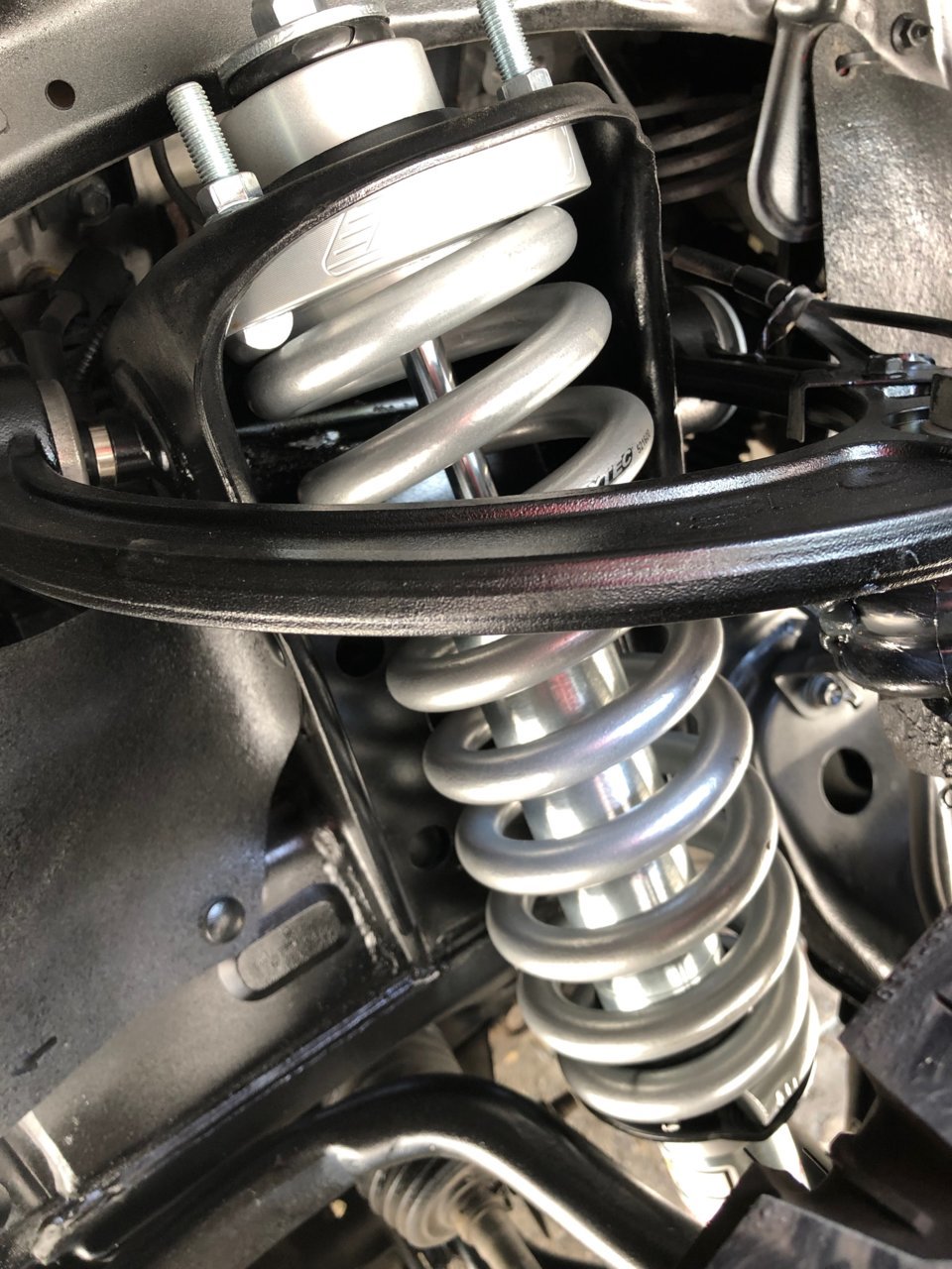

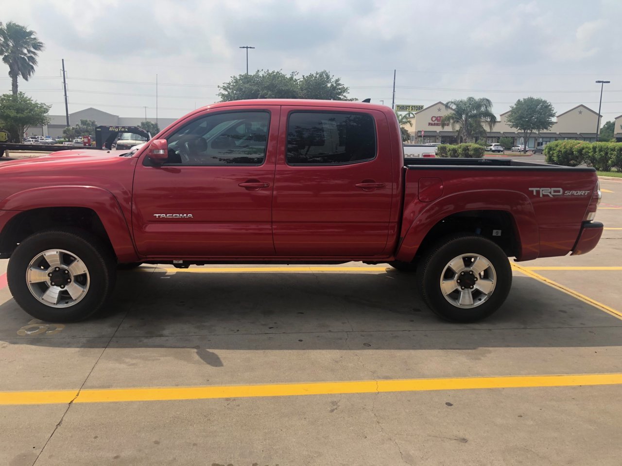

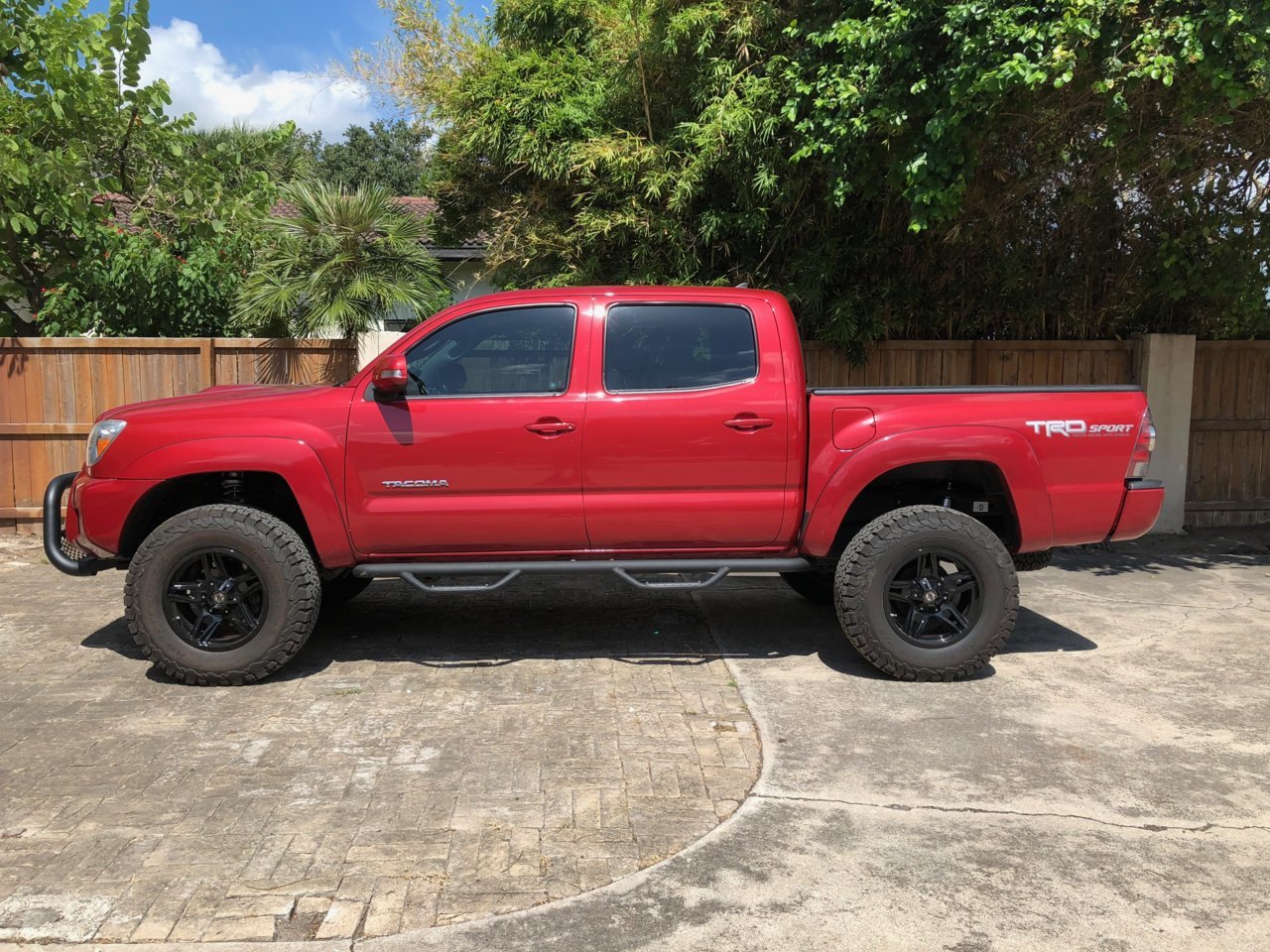

    As much as I wanted and tried to justify an Icon Stage 3 lift I kew it was something that we would likely never use so I decided on the Toytech 3" Bilstein 5100 with 600lb spring in the front and Boss rear shocks lift with AAL spring, new bump stops and SPC Control arms. The delta in savings over the ICON 3 will be directed to future mods.
    Local shop installed the parts on the 24th. The much anticipated unveiling (seeing it for the 1st time after the install) was not disappointing.
    My initial impressions:
    Front Suspension: The front was slightly, though noticeably, higher and my hopes were high that the rub at full lock would be eliminated.
    Rear Suspension: Damn that's tall, had no idea the AAL made such a difference, looks like the original factory stance has returned. Will it settle? Will it level with the rack and tent?
    Curious about the effect of the lift when comporting to where the truck was with the spacer lift and what it would be original factor heights I compiled the following measurements. The stock height I found on Tacoma World, assuming they are correct.
    Measurements are center of hub to fender
    Stock Spacer Toytec Stock Delta Spacer Delta
    FL 20.00 21.50 22.50 2.50 1.00
    FR 20.50 22.00 23.00 2.50 1.00
    RL 21.75 23.50 25.00 3.25 1.50
    RR 21.75 23.50 25.00 3.25 1.50

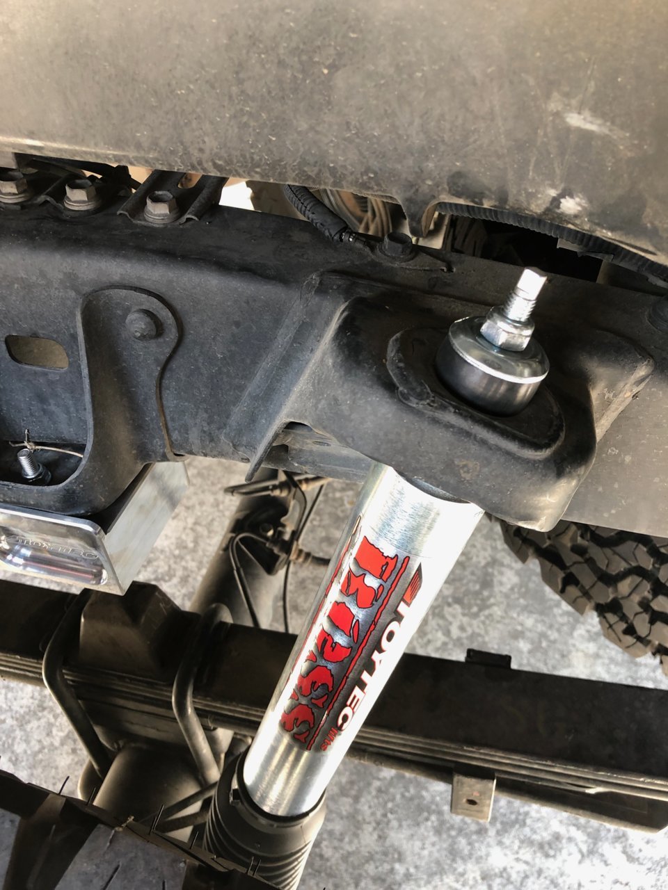

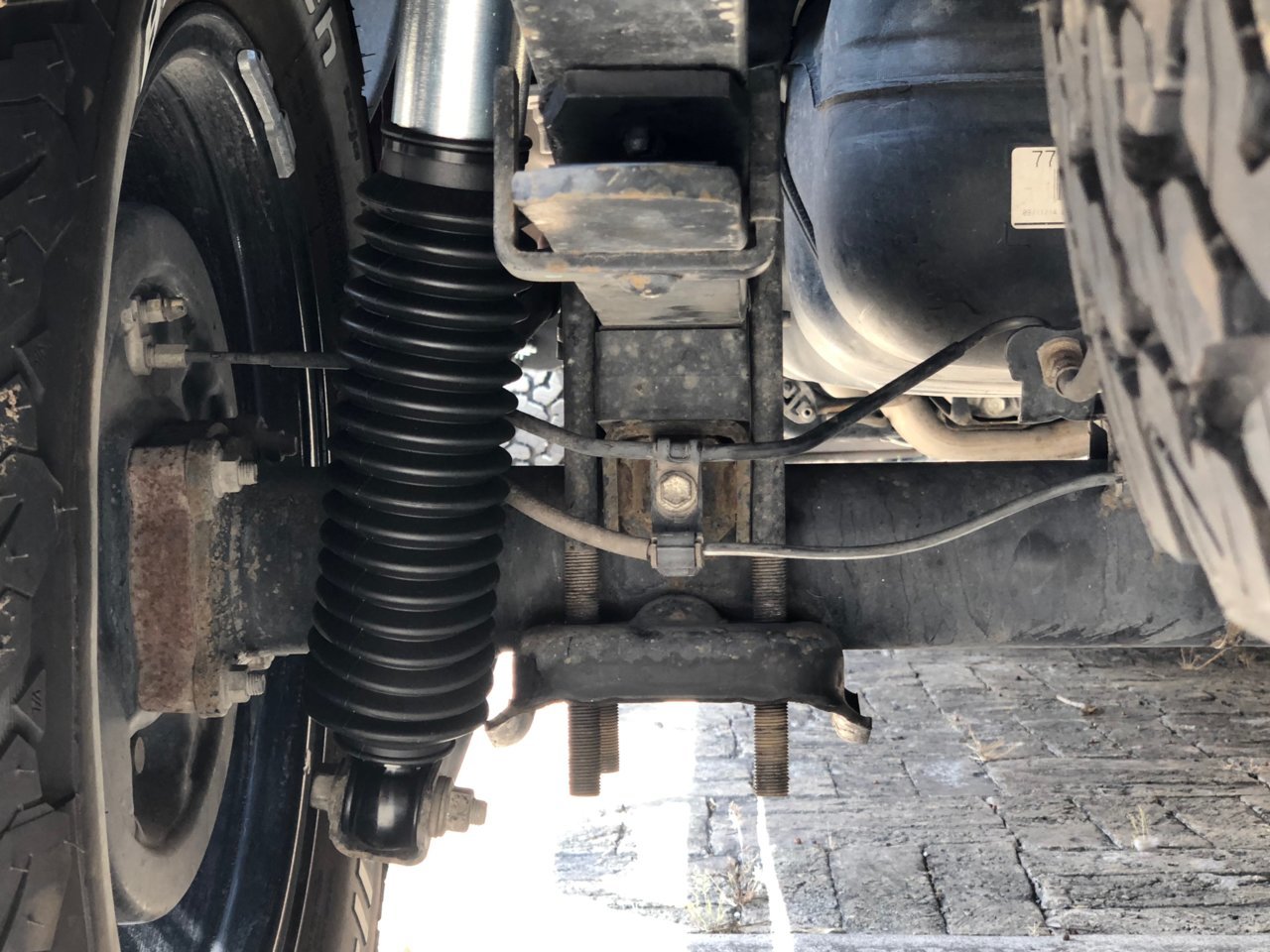

    The 3"+ inch lift in the rear seemed odd based on all the research so I went under the truck to look at the suspension.....
    The front
    The rear Boss shocks and bump stop
    The AAL spring.....wait is that spacer still in place? shouldn't it have been removed when installing the rear AAL? It would definitely explain the gain in height on the rear suspension.
    Overall - the ride is excellent and could not be happier at this point, the improvement in ride quality over the spacer lift is substantial. However I have concerns about the rear suspension:
    1) Are there potential drive shaft alignment issues? Vibrations? Undue wear? I have read about vibrations but have not yet experienced the phenomenon. Perhaps I will at highway speed this weekend, to be continued....
    2) Are there potential brake line issues? Brake lines are stock, is there risk of catastrophic failure in a full extension/compression (flex situation)?

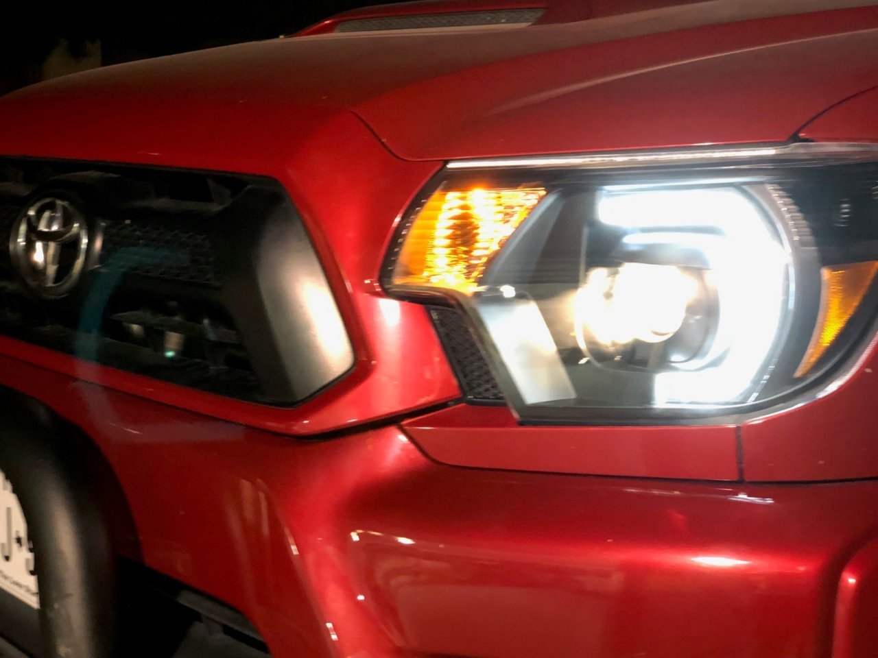

    Replaced headlights with Spyderco lights from Tacomabeast

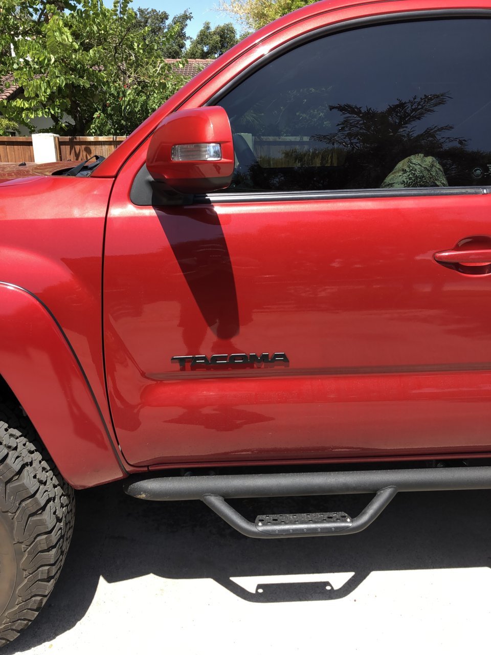

    Blacked out the lettering. Used plasti-dip as I could not find any OEM black badging, curious how long it will last.

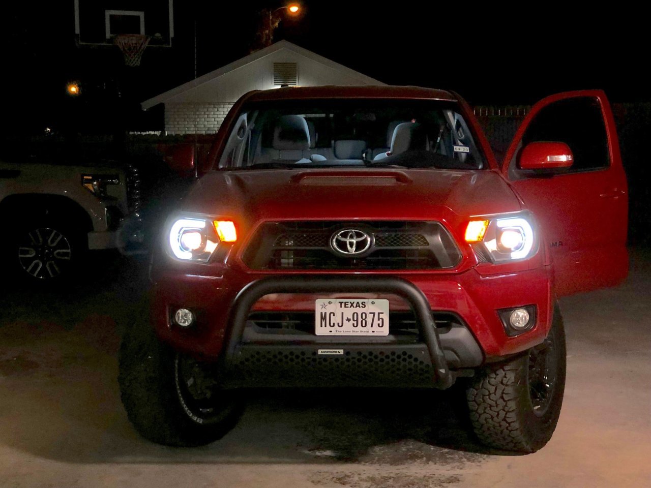

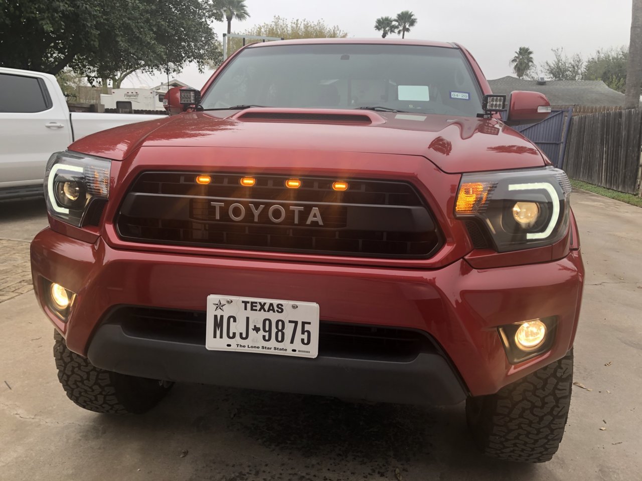

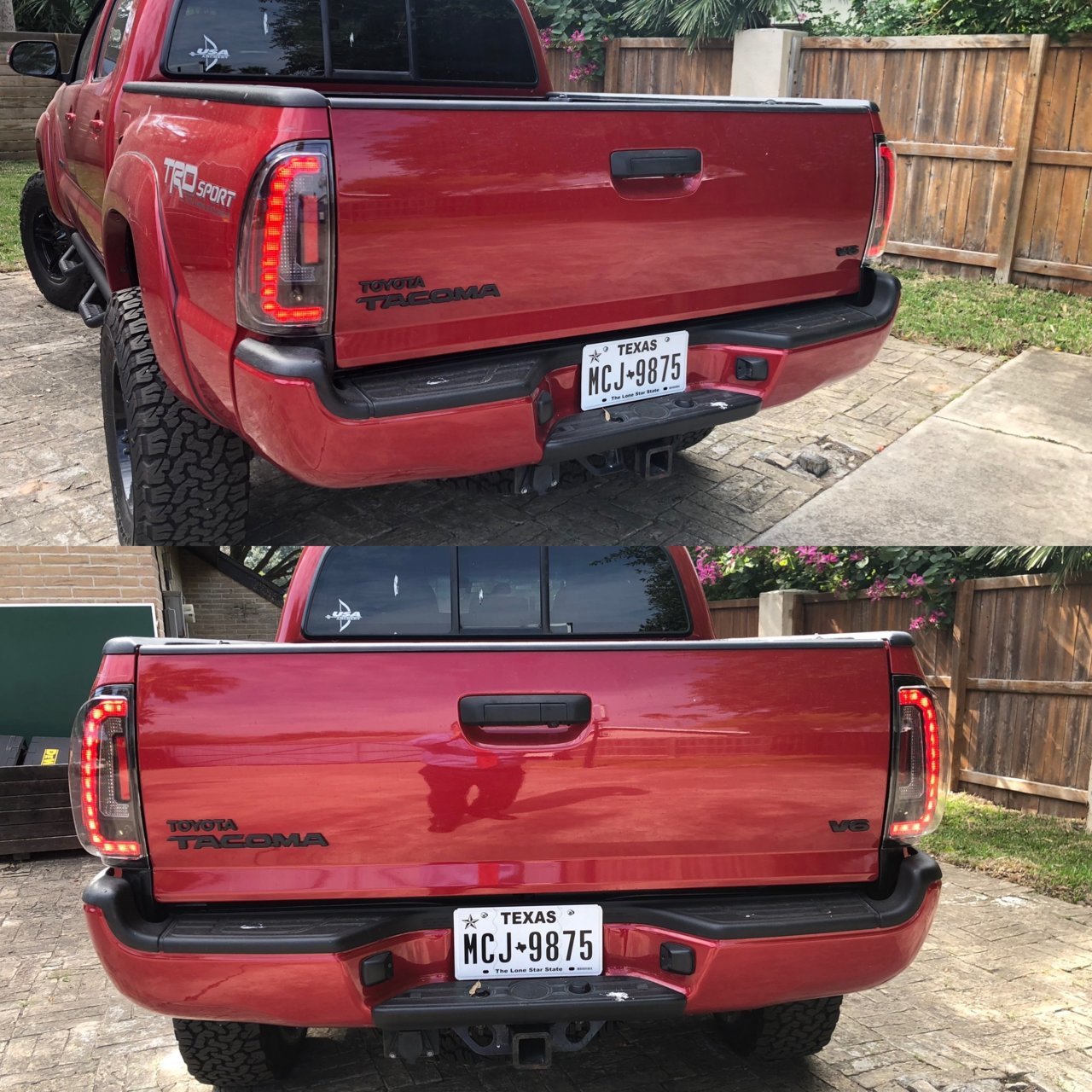

    12/29/2019 Build Update:

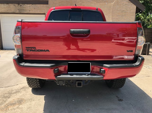

    Replaced the tail lights with Spyder Lights to match front, purchased from Tacomabeast.com.
    Replaced grill with a TRD Pro Style Grill with Raptor's lights, purchased from runnin4tacos.com.
    Installed Cali Raised led ditch lights w/brackets, purchased from caliraisedled.com.

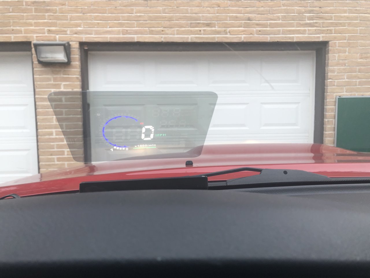

    installed the ColorTree A8 HUD unit just for fun, purchased from Amazon.com.
    Installed a Switch Pros 9100, purchased from sdhqoffroad.com, used the Expedition Essentials, purchased from expeditionessentials.com, mounting bracket for the SP-9100 under the hood and the bracket to install the controller unit in the sunglass compartment.... pics to follow.
