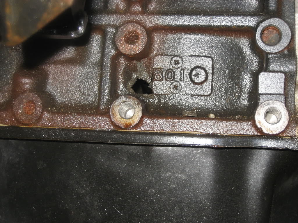

    Ok, let me rephrase what i said. You CAN bore it, its just VERY ADVISABLE NOT TO. The walls are very thin as it is and boring it any further will inevitably end in disaster.

    Did they actually bore it out or just stroke it? Probably ran out of money or blew up the engine.

    It would be sick to bore each cylinder out 100cc to get ~4.0L

    Boring an engine doesn't affect the walls of the crank case;)
