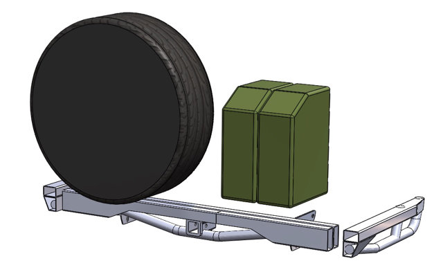

    Decided to get my rear bumper build going. I'm going hi(ish) clearance with dual swing outs. It'll be styled after my sliders so, hopefully, they look like a set.
    Here it is...mostly. This is as far as I'll go in CAD until I get the main bumper with swing outs actually built and mounted. Then I'll work out how I want to attach the wings.

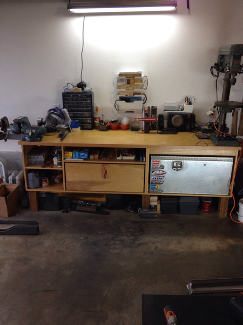

    Step 1: Clean your space! Can't do good work with crap everywhere. And, yes, this is my idea of 'clean'. Haha.

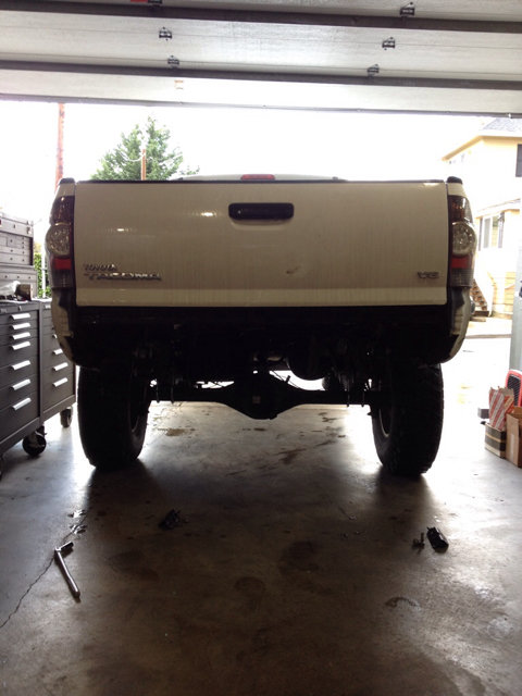

    Prep the truck! Back that azz up and tear into it. If you have the factory tow package, the hitch and bumper are conjoined and are removed as one unit. Toyota did their homework on this though. If you remove all of the bolts on the frame rails except the bolt closest to the front of the truck (just loosen them), the bumper will just sit there. Then, from behind, you just tilt the bumper up and slide it back and you're done!

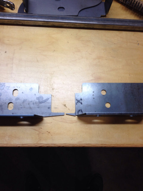

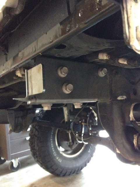

    I made some templates and did some measuring and figuring and staring and licking...oh...uhhh, never mind. Then I made frame plates in CAD and had them laser cut and bent. Here they are!
    Time to bolt them up! They look super dope...and are completely wrong. They bolt up to the frame perfectly but they place the main bumper tube too low and too close to the truck. Too close as in jammed all up in. There's $44 down the drain. Better luck next time.

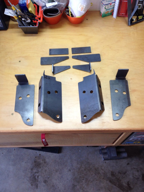

    I made my adjustments in CAD and had new plates made. Picked them up yesterday and will find out if they fit today. While I was waiting I started working on the main bumper tube; a nice 2" X 4" 3/16" wall piece of rectangular tubing. I printed off some dimensions and angles and got to work.

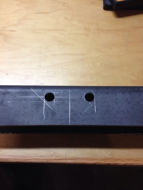

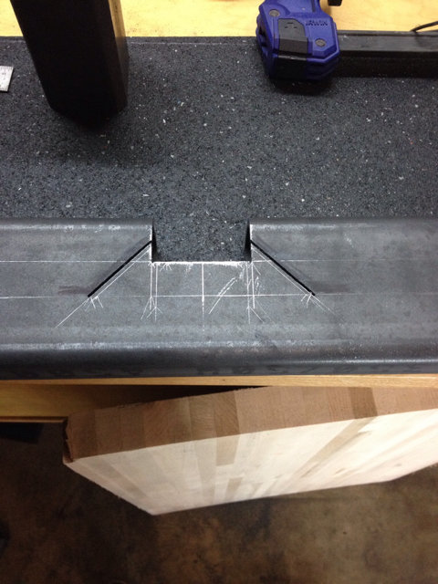

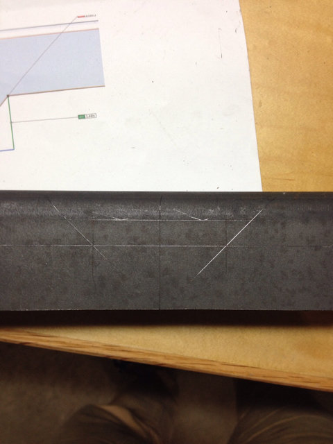

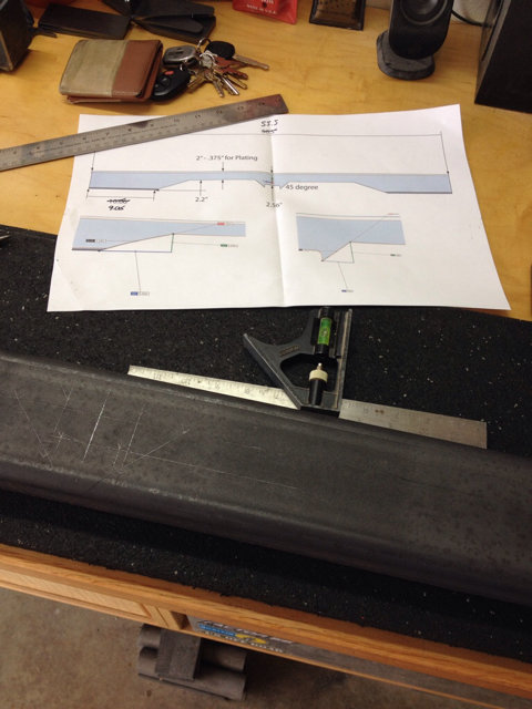

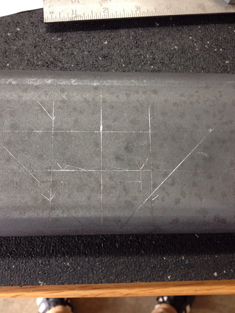

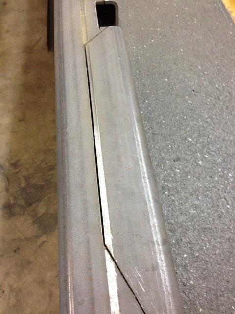

    Started by carefully scribing all of the cuts. Then completely redid it once I realized I screwed the pooch...again! I re scribed a few lines that were off.

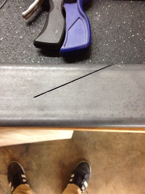

    Did some angle grinder work to get the party started then I totally cheated and took this to work and did the angled cuts on the bandsaw! Saved me mad time and added a lot of accuracy.

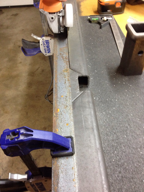

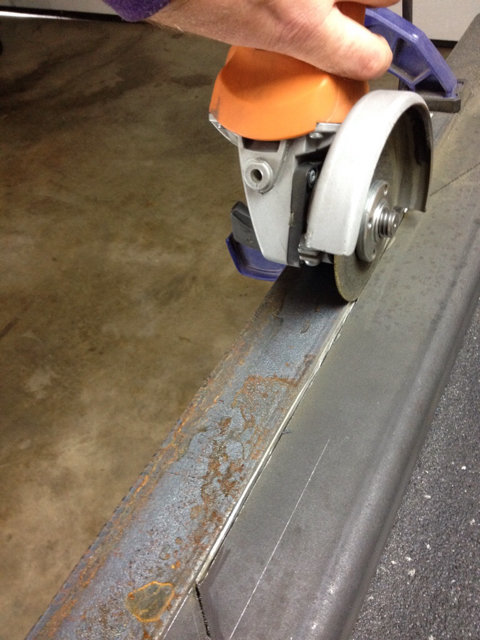

    Needed to make some nice straight cuts where a bandsaw could not go. Bust out the angle grinder and a nice thick piece of straight metal. Clamp it down and use it for a straightedge. If it works for an X-acto knife it'll surely work for an angle grinder!

    Sure enough! Straight edge works awesome for angle grinders and cutoff wheels. Just remember to keep and eye on your straightedge and be sure to change edges when necessary. I was able to make four cuts that were over a foot long using just two edges.

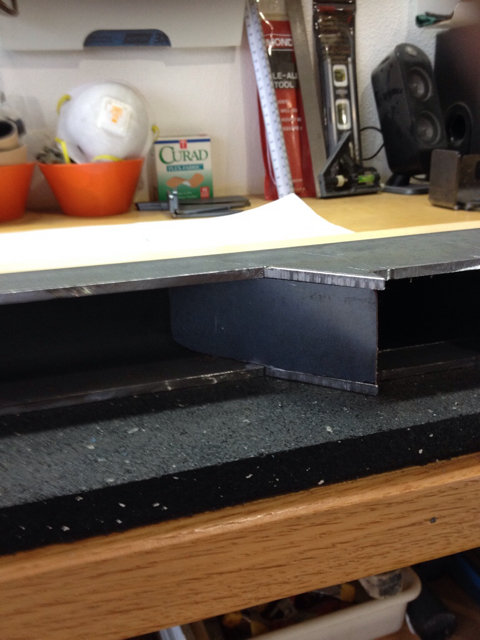

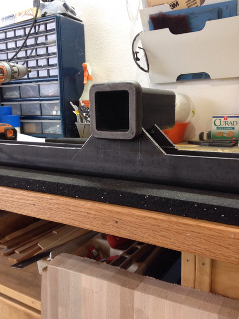

    Here's where the hitch goes. And, yes, it will have a lot more bracing.
    Some internal bracing for the hitch.

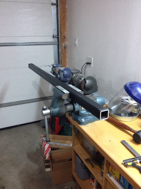

    Picked up my 2x2 .188 wall square tubing! Took it to work and cut it to exactly 55.5". Then I put it in the vise and used a file and a square to ensure the ends were square. Deburred it a little and its ready for cleanup and welding.
    Took one of the cut offs from my failed 2x4 steel start and scribed out the new upper hitch feature.
    Drilled holes in the corner of the recess for the hitch tube to make a tighter fit up. I'll likely get the bandsaw after this tomorrow night.
    And, in the spirit of full transparency, here are the potentially good and the positively bad frame plates. The one on the left is the new modified version which I've yet to fit to the truck to verify. The one on the right is the one I fit on the truck to verify that it's total rubbish. It happens.

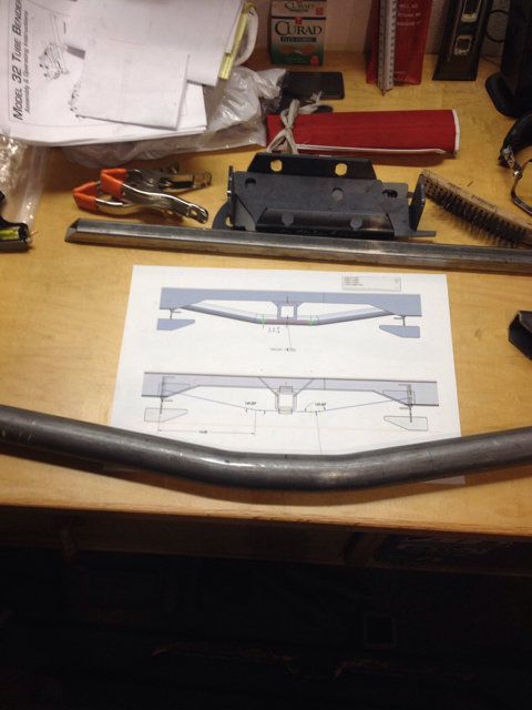

    Did a test bend of the brace that runs under the hitch. Other than measuring and bending in all the wrong places it came out really well! Haha.
    The drawing shows a bit about where we're headed but doesn't give away the whole thing.
    Here's what I learned tonight:
    1. I can't divide 7.5 by 2 when I'm excited.
    2. I can't bend on the correct side of the incorrect lines mentioned in note 1.
    So, even though it's completely wrong technically, it's actually quite correct in spirit!
    I'm pretty sure I've got it figured out now. I think the next one will be dialed.
    I also need to level my bender so that I don't have to eyeball level on my bends...I can actually use a level. A couple of washers under one side should do it. Even though every element of the bender is free to move a small degree, I think starting more level than I am will help. I'm open to input on this subject.
