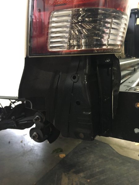

    Getting closer! I cut the bedsides up 5/16" then mounted the side wings. Then I measured up from the top surface of the side wings and marked a straight line to trim to on the bedsides...to make sure the bedside cut was parallel with the bumper wing. Visually, that's the most important line. Got that all trimmed, sanded, filed the I put some primer on the exposed metal. This will be covered with Trim-Lok edge trim later. I also painted the corners under the tailights with rustoleum truck bed liner. It's not real truck bed liner but it makes a nice looking, textured black surface. That'll do for now!

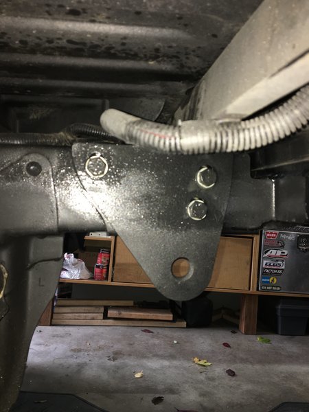

    I also bolted up my frame mounted recovery points.
    These are 1/2" thick steel. Put a bow shackle through the hole and you're good to go! (In theory, haha). I did some other puttering around...cleaning stuff, repairing other things...all in prep for finishing the install.

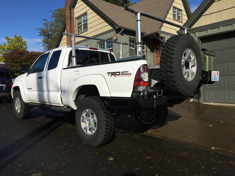

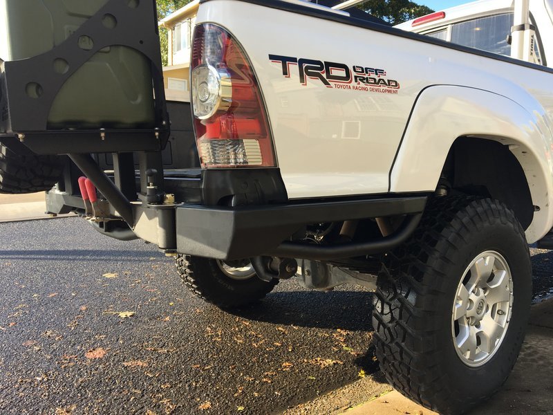

    Got everything major done.
    Hard to take a good picture when it's all black on black. Haha, oh well, why learn how to shoot photos now?
    So, I still have a few thing to wire but all the big stuff is done and operational. There are parts about it that I don't care for but it should work for our purposes for quite a while, I think. I always look at my projects critically, though, and it drives my wife nuts! This was definitely the most complex welding project I've done and that was an experience in and of itself. I'm glad the fab is done and I'm ready to try woodworking and fiberglass for the camper. I'll update this thread with the finishing touches and experience reviews. I'm happy to share my failures as well as my triumphs so if something breaks, you'I'll know about it and hopefully will learn from it!

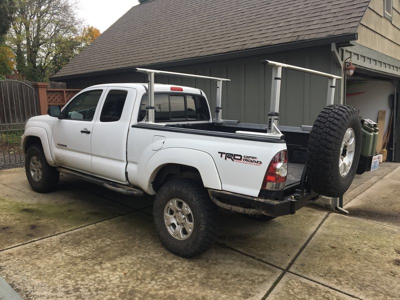

    Since some of you have asked about my camper build, I have a question for you: where should I put that build on this forum? There's a specific place for camper builds on Expo but not here. Should I put it under the general 2nd gen area or under 'builds'? I guess I could just sit down and do a full build thread for my truck. There's not a ton to cover but there is some.
    And, just to keep this thread on topic, I went out on Saturday morning to drive out in the hills. It was sunny, fairly warm, and I had a great time. I loaded two full Jerry cans with water to test the bumper a bit and took to the trails. Nothing hard but there were some bumps and twists involved and everything went well. Time to get it on some harder trails and stress it more. I'd rather have it fail close to home than in the middle of nowhere!
