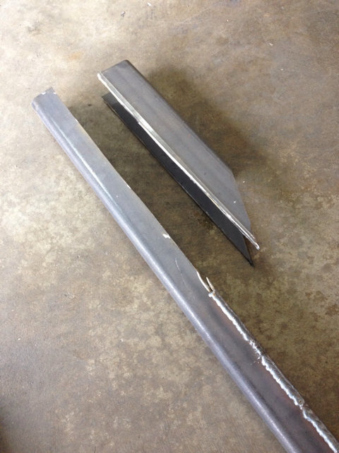

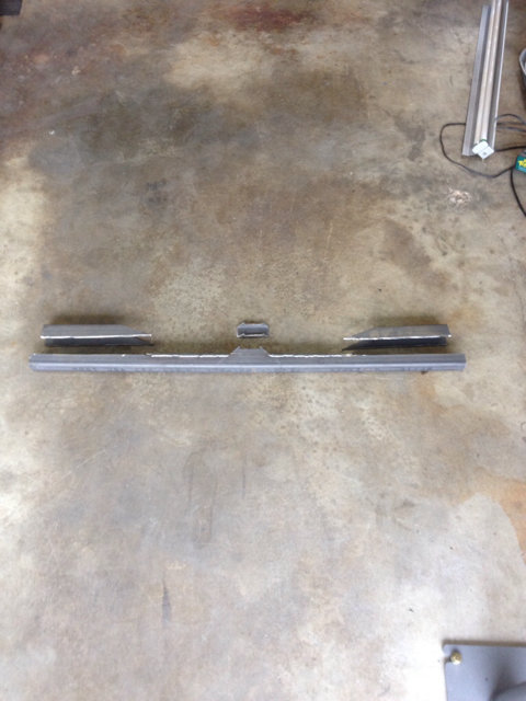

    F'd upectomy is complete! I cut off the pieces I want to use from my sad first attempt and I made a new bracket for the hitch.
    Cut two of these off. I'll clean them up and get them tacked up to the 2x2 square tubing. It will be very important to make them equal, straight and exactly 4" overall height.

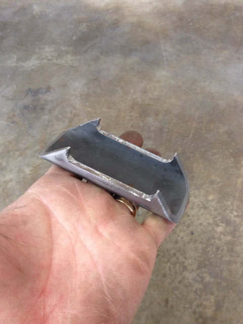

    New upper hitch bracket. This will attach to the underside of the main 2x2 square tube. It will be gusseted quite a bit. This won't be the only thing holding it in place! This will also be the main recovery point on the rear of the truck so I'll do my best to make it stout.
    I'll be back at it this afternoon. More updates will follow. I imagine I'll get all the pieces cleaned up, fit and ready for welding by EOD. I would also like to get the main 1.75" round tubing lower support bent today. We'll see how it goes.

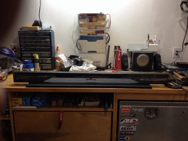

    Rob all you want! Here's the last update for the day. I'll be back on it tomorrow night.
    Have to get pretty far away with my phone to take a picture of the whole thing. Consequently, you can't see a damn thing! Trust me, it's magnificent.

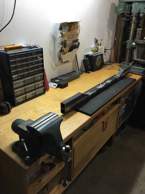

    I'll have more updates this week for sure! I stole away a little time today to clean my workbench. It was a total mess!
    Much better!
    Cut two fill plates. That's progress, right?

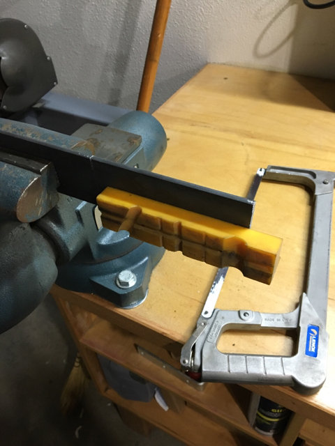

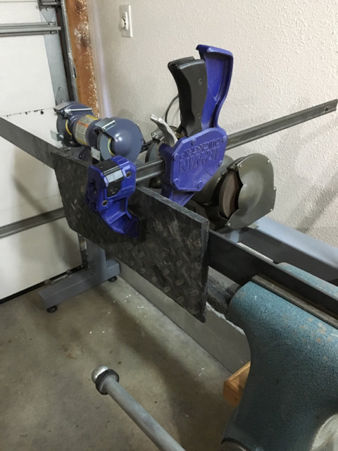

    A little helpful hint when using a hacksaw. When you cut something with a hacksaw you can get some horrendous screeching from vibrations.
    You can clamp a piece of rubber or, like pictured here, use a magnetic soft jaw for the vise. It will keep the vibrations and screeching down to near nothing.
    Here's the 'clamp on a piece of rubber' method. Works really well too.
    There are other ways to do this but these are two I use frequently. This is likely pretty common knowledge but I didn't know about it until someone told me!
