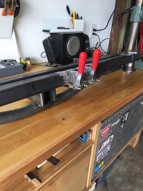

    Put in a little work this evening.

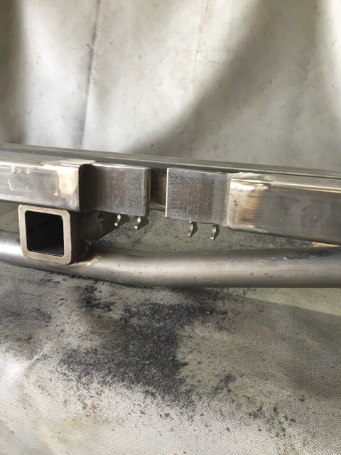

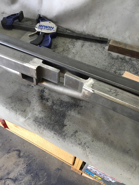

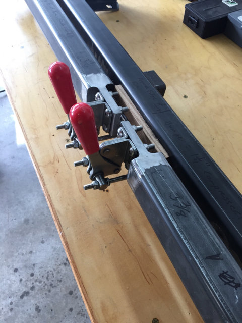

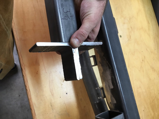

    I needed to figure out the best way to mount my De-sta-co clamps. They have a mounting foot and an adjustable but limited reach. So, after some measuring and figuring, here's what my plan is.
    I need to move the clamp farther back on the swing arm. By that, i mean, I can't mount it on the face of the 2x2 square tube. I need to offset it back from the front face. I decided to use some 1/4" wall angle. Should work great.
    I had to make clearance for the angle steel clamp mounting point so I cut these back.
    This is the plan with the angle. I'll mount it back to back and weld it up solid. Should be stout. It will also allow me to set the clamp exactly where I need it. I had just enough angle steel laying around. Perfect!
    Back on it in the morning!

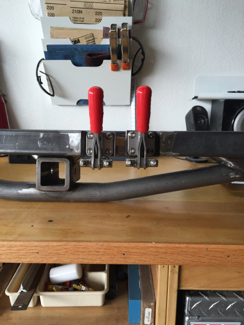

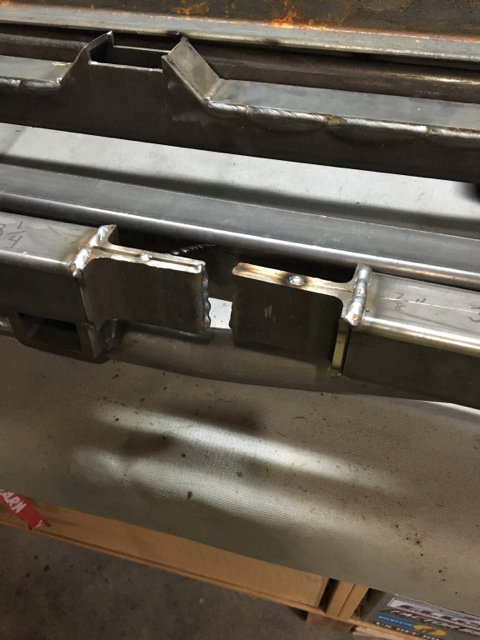

    I try to show all the steps to some degree. Well, today is more of a One, Two, Skip a few kind of update.
    I finished my clamp mounts. Doesn't seem like much but it's big for progress!
    Angle steel cut and tacked in place.
    All welded and ground down to something approximating 'smooth'.

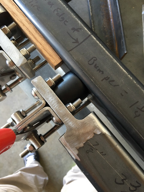

    Stainless steel 2000lb De-sta-co clamps mounted and ready-ish for duty!
    They'll just come back off shortly but it was important for me to get this done. I still need to get an appropriate set of rubber bumpers to mount on the backside of the clamps to give some pressure back to the clamp. Keeps things tight and rattle free. I also picked up a small remnant of 1/4" thick King Star Board. It's just HDPE that has been UV stabilized with some sort of additive or something. Anyway, I'm going to try to bed that over the main bumper tube to be used as both the vertical alignment plate as well as the surface that the rubber bumper contacts. We'll see how that pans out when I find a good bumper.
    I don't know what else the weekend holds but I'd like to start getting the spare tire mount mocked up. Plus, there are a few other bits of welding that need to happen on what I have now.
    A few things off the list...a ton left to do!

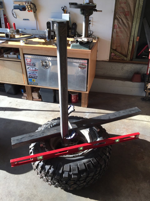

    Last update for the day:

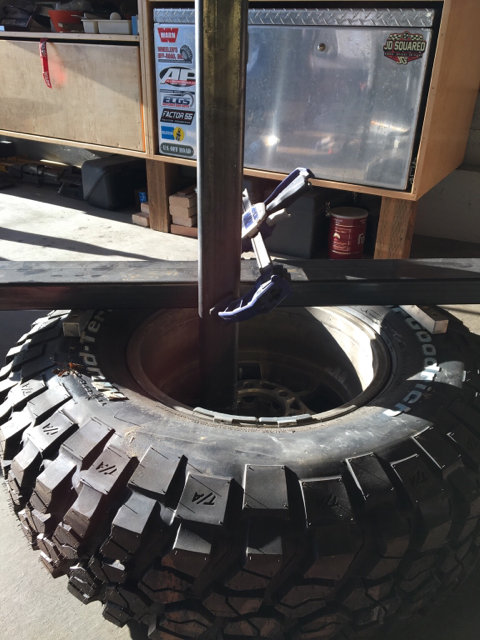

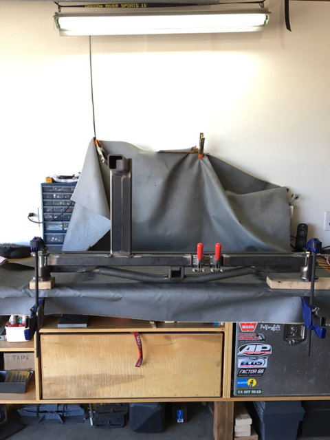

    I figured out how I want to do the tire carrier so I started laying that out.
    See! Figuring out how much I want the tire set away from the upright...how long the upright is and how long the extension is. I have a cut list and the material already loaded. I'll head to work first thing in the morning and get it handled on the horizontal bandsaw.

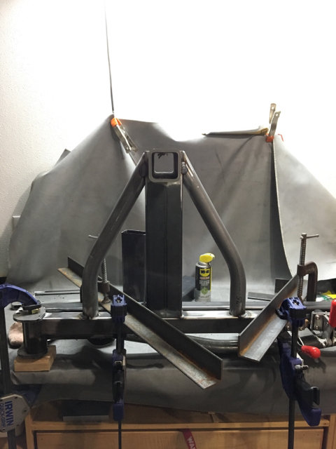

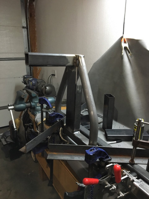

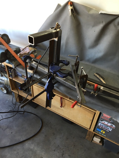

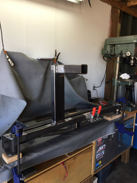

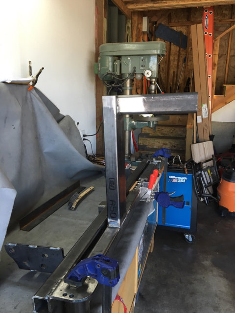

    Tire carrier in process!
    Went to work this morning to cut some steel.

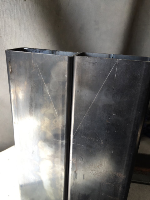

    I then marked out where I wanted the arm that actually holds the tire to intersect the upright. I wanted the tubing to intersect so that it had more support and weld area. May not really matter...
    Got the arm and upright welded together. Then I went about clamping the upright into position on the swing arm. Yeah, that's Frankenstein level jig making there. Don't worry about it. Haha.
    Partially welded in place! I'll finish weld it when I get the tubing supports bent and in place. Gonna be sweet!...I think.

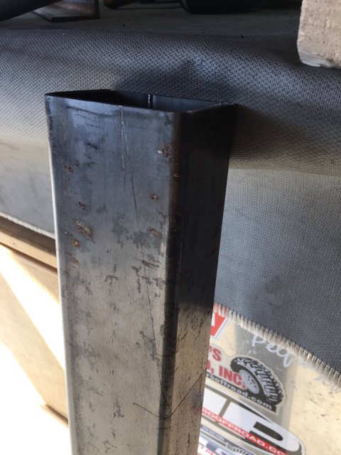

    Marked these for cutting. These will become the lower braces on the swing outs.
    Marked two of these to cut. These will be the basis for the wings that wrap around the side of the truck.

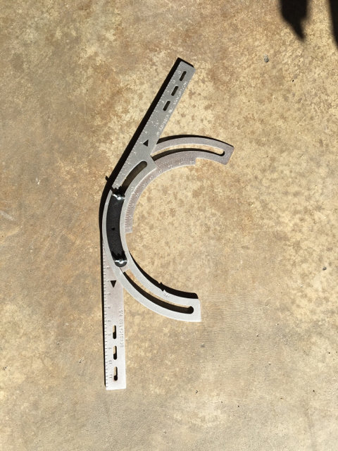

    Used this cool thing...

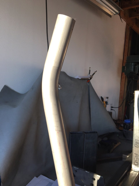

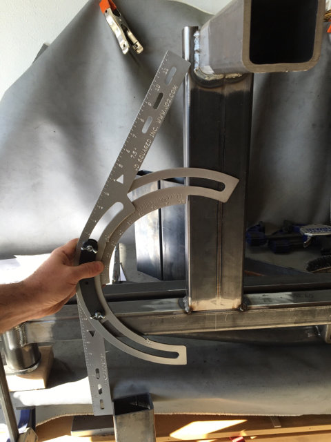

    To figure out the bend angle for the two tubular braces that will ride shotgun on either side of the main tire carrier upright.
    Bent two of these. I only need to cut the one end of each at 60 degrees. Cutting tubing at angles steeper than 45 degrees is a pain because that's as far as the saws I have access to will do. If anyone has a tip on that, I'm all ears! I can get the angle okay by eyeballing/drawing a rough line but the rotation is a mess.

    Angle grinder with a chop/ cutting blade. I used my sawzal for mine with a lazer blade. Also remember that if you are smart you can cut it backwards as you only ever need 45*+1. I know that is not always possible with pipe but it sure works for wood. A band saw can also do it if you have a good brace or clamps.

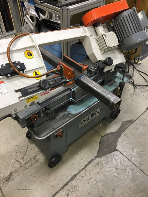

    45 + 1? I don't follow... Sounds like some Jedi stuff to me. Haha. I thought about the bandsaw but using a big bandsaw on tubing can be scary is you're not set up perfect, as you mentioned. I may just make a jig that I can clamp to that gives me a lot of good visual reference and just use my angle grinder.

    Wait. After thinking about it on my lovely walk to work, I think I have this 45 + 1 business figured out. That would work really well on a table or chop saw. I'll have to take a look at our chop saw here at work and see if that is possible. Work holding will be the issue.

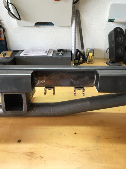

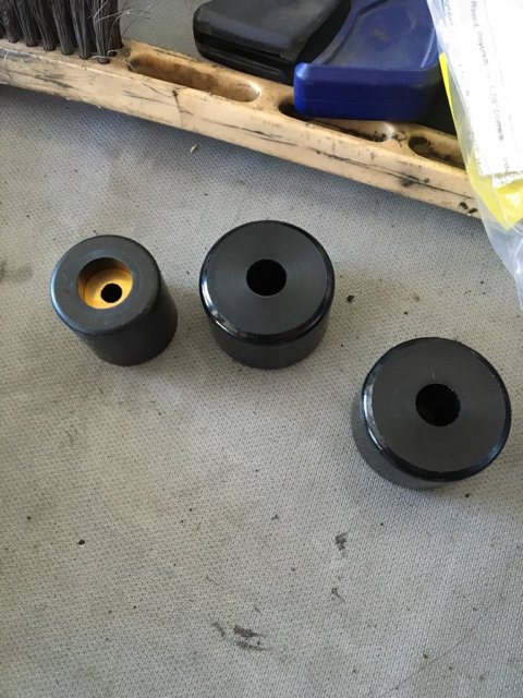

    I need to figure out some kind of bumper to go between the swingarm and the main bumper tube. Something to keep constant back pressure against the clamps.
    I ordered two sets of different bumpers that looked like they may work.
    Not sure how I feel about them. The big ones were a little too big in diameter and softer than I was hoping. The smaller diameter but longer ones fit like a glove but seem too soft. I clamped it in place and left it there. We'll see when I get home. I'm almost thinking something hard like Delrin would work better. At least something way harder than these. FYI these are in the shore 80a range.

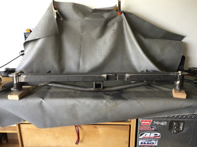

    Did a scrap of work:

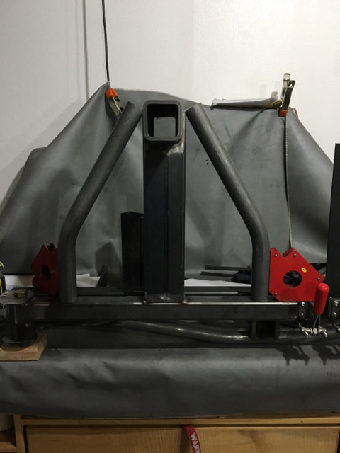

    This is what the bracing for the tire carrier will look like. I just need to trim to fit.

    All trimmed and half welded into place! Me likey! Too bad it'll be covered up by a giant tire! That's okay. I'll know it's there.
