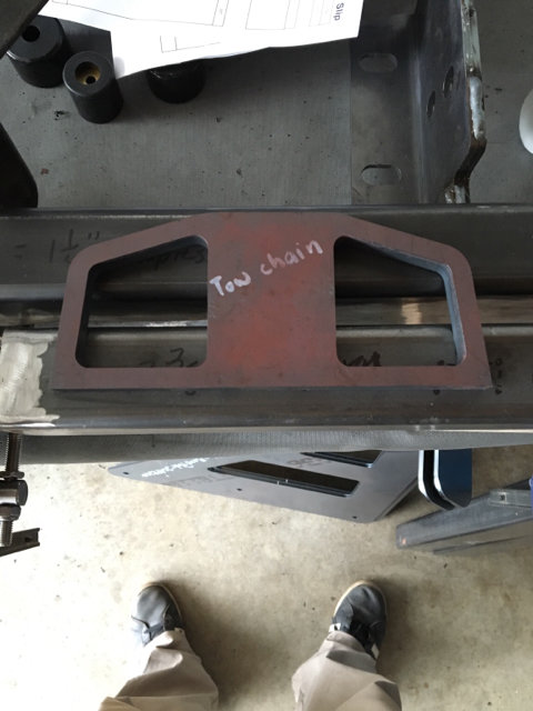

    Small update...critical features!
    Picked this up from my laser cutter. I need to drill out the holes to, I believe, the tap drill size for an M12. I'll have to verify that and the pitch of the wheel stud. Then I'll thread the appropriate bolt in there and weld it in place.
    Also picked this up. This is, as the part says, for tow chains. This will weld up to the bottom of the hitch receiver and be the spot where you hook safety chains. Will add more bracing to the whole system as well.
    Yard work has been killing time and energy but we should be wrapped up by the end of the day on Saturday. Then full time bumper again!

    Side note: I love getting all of my parts laser cut. It's not that expensive (here) and you can make any shape you want...nice radius corners...lovely.

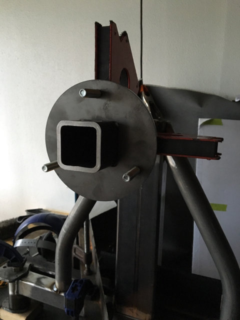

    It's the little things:

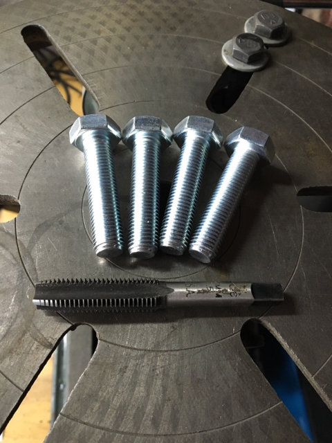

    Bought 4 m12 - 1.5 x 2" bolts for my spare tire carrier. This matches the lug that's on the truck so factory lug nuts should work on my carrier. I only needed three but I bought four because I always buy at least one more than I need. These were stupid spendy though...due to the fact that nobody buys an odd metric bolt. $2.80 a piece at my neighborhood true value. At least they had them and it's a block away. Fit in my schedule nicely. I also just happened to have an m12 - 1.50 tap! The benefits of having a dad who was a machinist for many years. I also have a complete drill index with bits ranging in size from 'don't touch that, you'll break it' up to 'don't touch that, it'll break you'. So, I'm sure the proper tap drill is at hand.

    Drilled, tapped and ready to weld. Little bits of progress as I have time and energy this week. In hindsight, I could have just not tapped the hole, used a nut to cinch the bolt down and welded the head. But, somehow...and for some reason, tapping the hole seemed right...even though I'm still going to weld the bolt head anyway.

    A little late, but i just purchased replacement studs for the truck from o'riley's for $1.90 a piece. Doorman, but good enough for a tire carrier. Not a huge loss, but if you need more or for future builds. Love the build BTW. Following along closely from the beginning.

    You know, I was going to get studs but...well...I didn't. Haha. I got antsy and just 'did it'. And paid for it! Oh well.

    I hear you. I've used 1/2 grade 8 bolts in previous builds of my own and never considered studs because I thought they would be much more expensive- never even thought to check. Go figure.

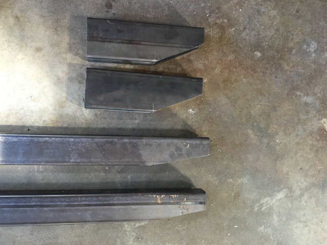

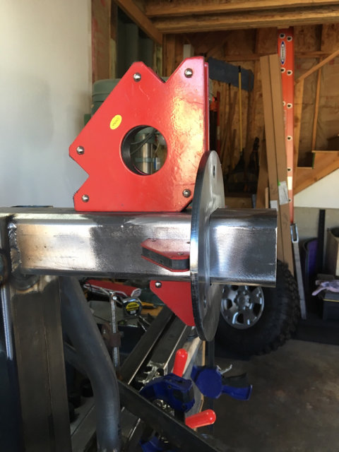

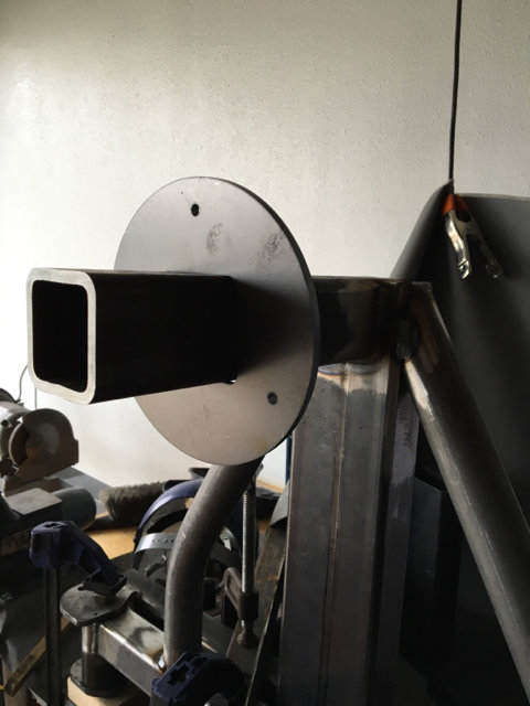

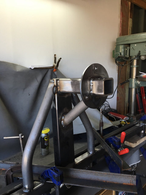

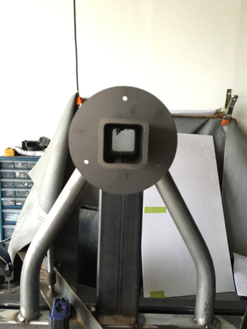

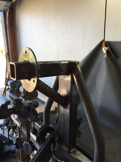

    Did some good work this morning.
    I made all of these cuts. Still more cutting to do but this is all I had laid out.
    Got this dude all lined up and ready for welding.
    Welded up the tire mounting plate and cut/welded in a diagonal brace to keep everything happy on bumpy roads...hopefully!
