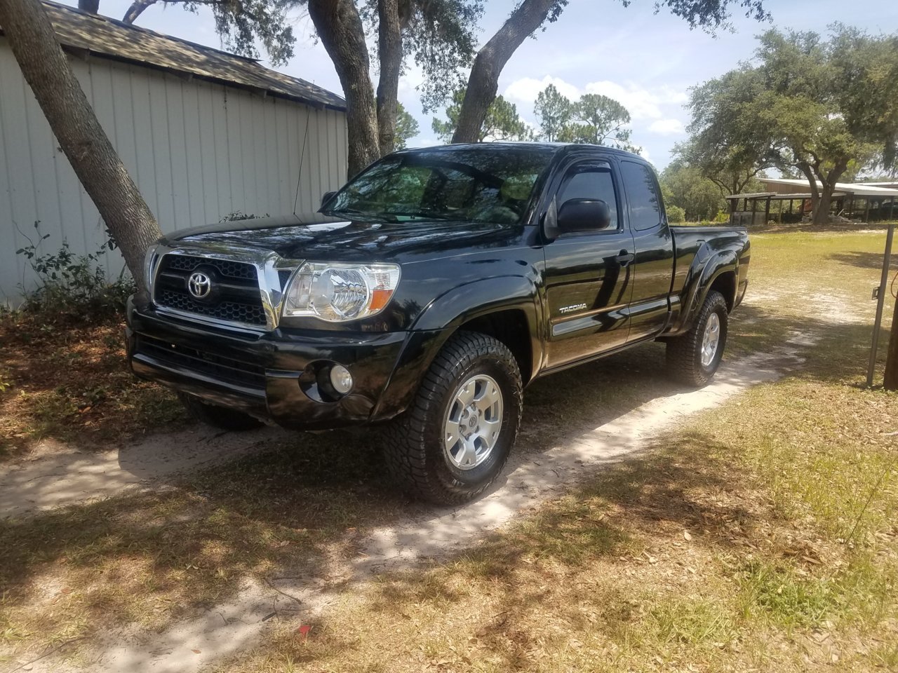

    So I've had this truck since 2017 I got it from Carmax with around 40k miles and a clean history.
    Its a 2011 access cab, 4x4, 6 speed, 3.73s and black. Nothing special but man was it hard to find one at the time.
    I wanted it because they look awesome and I thought I could get close to 20mpg, have an unstoppable off-road monster, and mess with ricers from lights. Little did I know it was dead slow, shifted like garbage, and gets 15mpg average. So I did like everyone else who likes fast stuff and got into the LS game and put this truck on the back burner just months after I got it. I usually drive it twice a month unless I need it to get to work because all my other stuff is broken or awaiting parts. It does get taken on adventures to fishing spots or to haul my 4wheeler to the trails once in awhile. I also tend to give it out as a loaner to my friends/family if they need something for a few days. Boy is it painful to watch them try to not stall it.

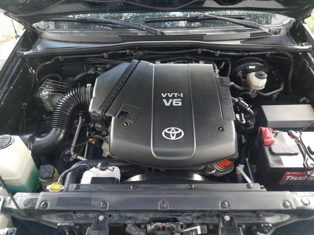

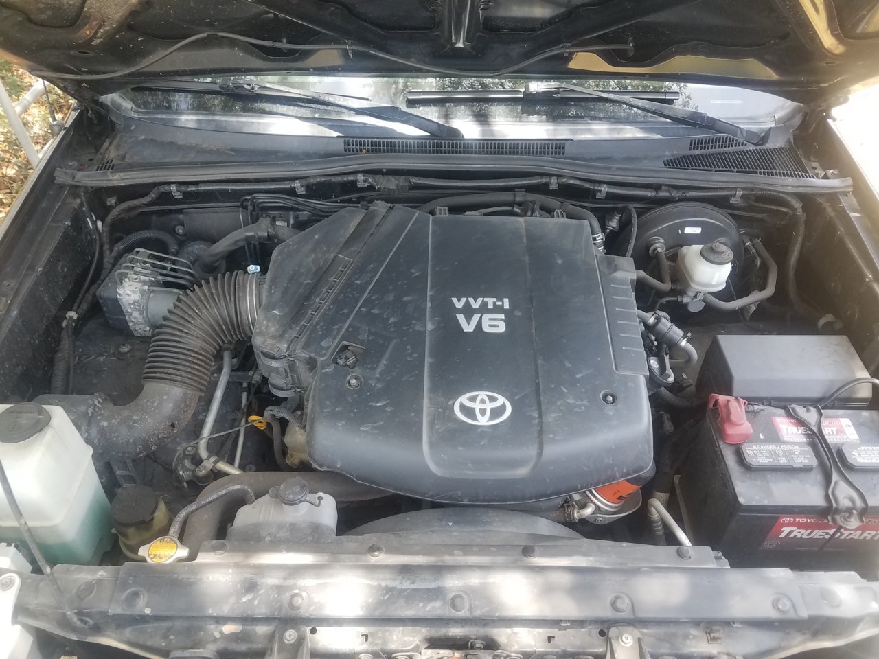

    Well since my redline hood struts should be here soon. I decided the engine bay could use a little elbow grease. Couple minutes with the power washer and a rub down with VPR does wonders. Its strange for me to see something I own completely stock still. 20200527_193024.jpg

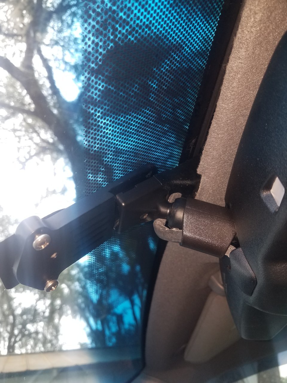

    Bird dog mirror riser installed. I used some double sided tape to help support the top and the connector since its an electric mirror rests inside the head liner which should provide some more support. 20200531_165733 (1).jpg

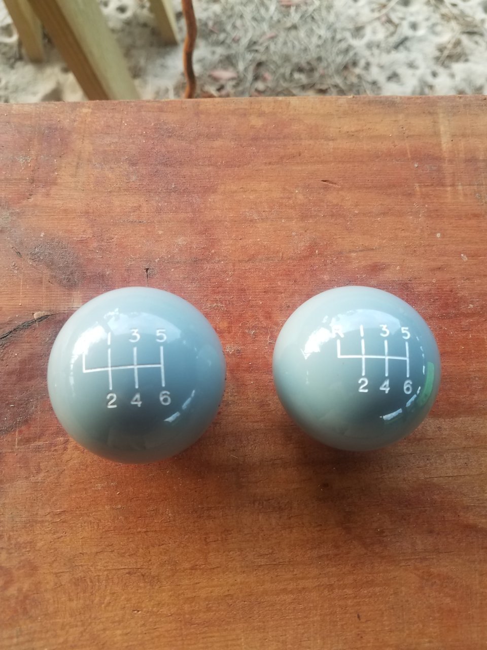

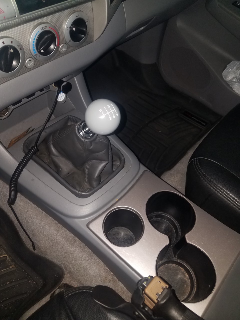

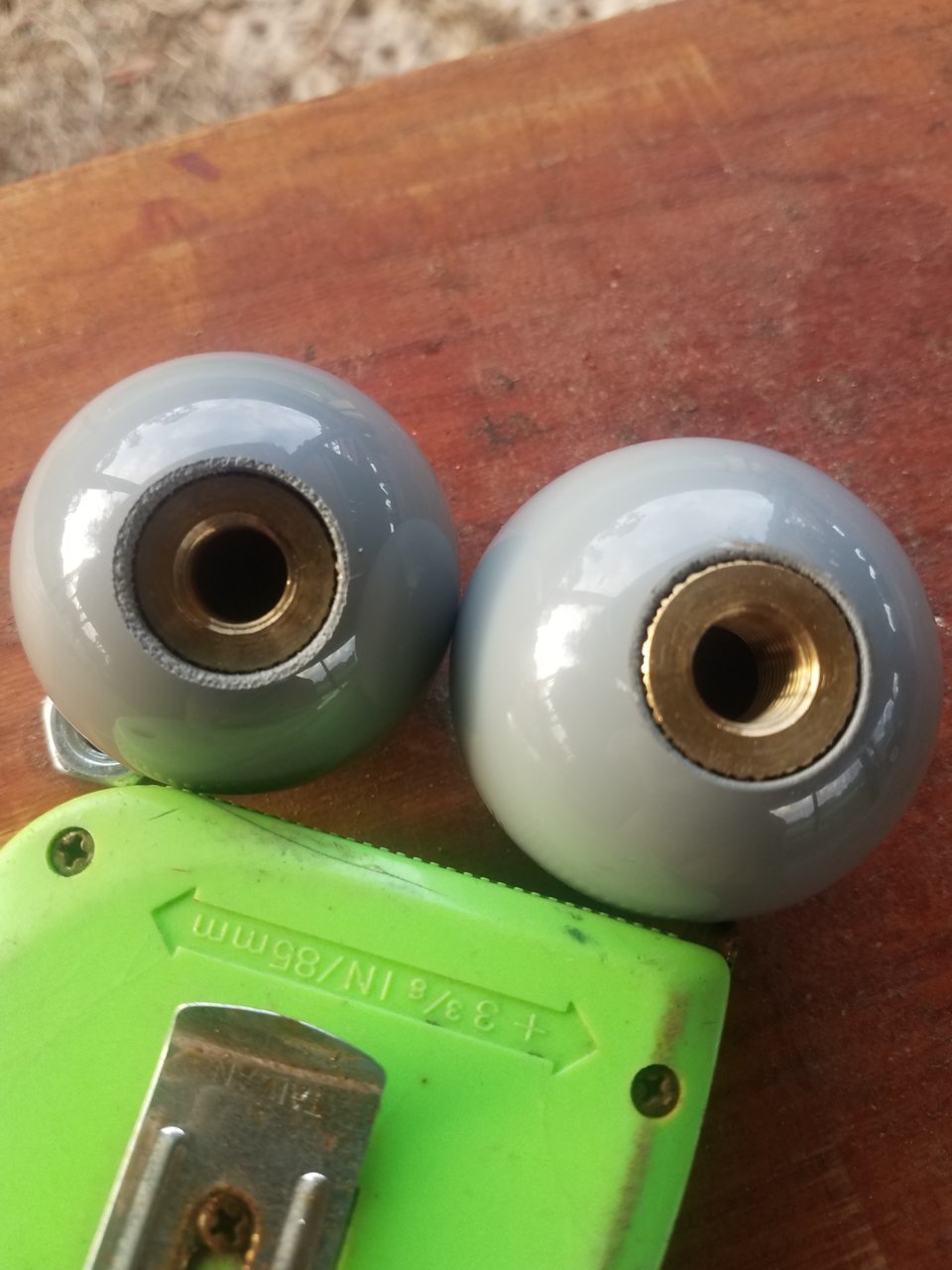

    Swapped the TRD shift knob for a Hurst. The Hurst is a tad smaller and since my other trucks all have Hurst its more comfortable to me. Also Redline hood struts came in. Wow those things look good. Hopefully get them in tomorrow.
    TRD ball is up for grabs! $40 shipped to lower 48. Can't post a FS thread yet but PM me. 20200601_193707.jpg 20200601_193646.jpg 20200601_193916.jpg 20200601_194108.jpg

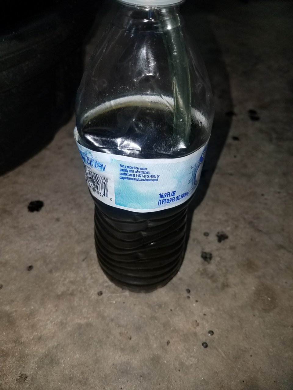

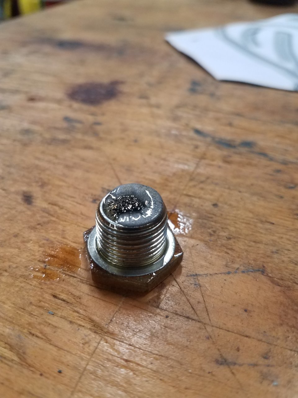

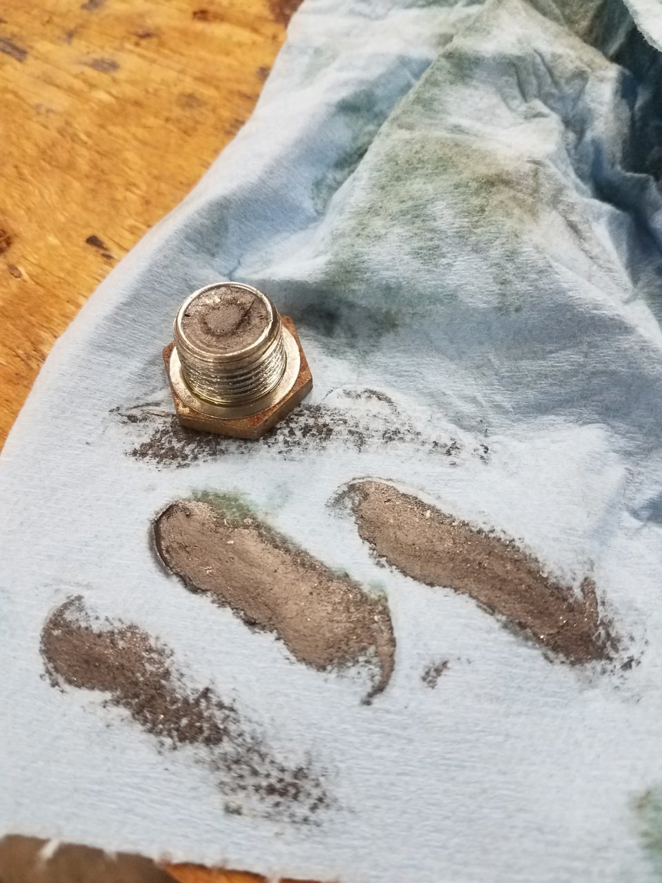

    Redline Mt90 trans fluid change and a full clutch flush and bleed with RL-600 Dot4 made a noticable difference in shift feel and trans noise. Now I can here the throw out bearing and tires where before it had a little trans vibration like noise. Clutch is more forgiving and engages a little further down in the pedal travel.
    Overall very pleased with the results of simple maintenance that's been neglected. I was shocked at how thin the factory toyota trans fluid is. It's no wonder the MT90 makes such a difference. Also the original clutch fluid looks like pond scum. 20200605_205107.jpg 20200605_205130.jpg 20200605_215924.jpg 20200605_215938.jpg

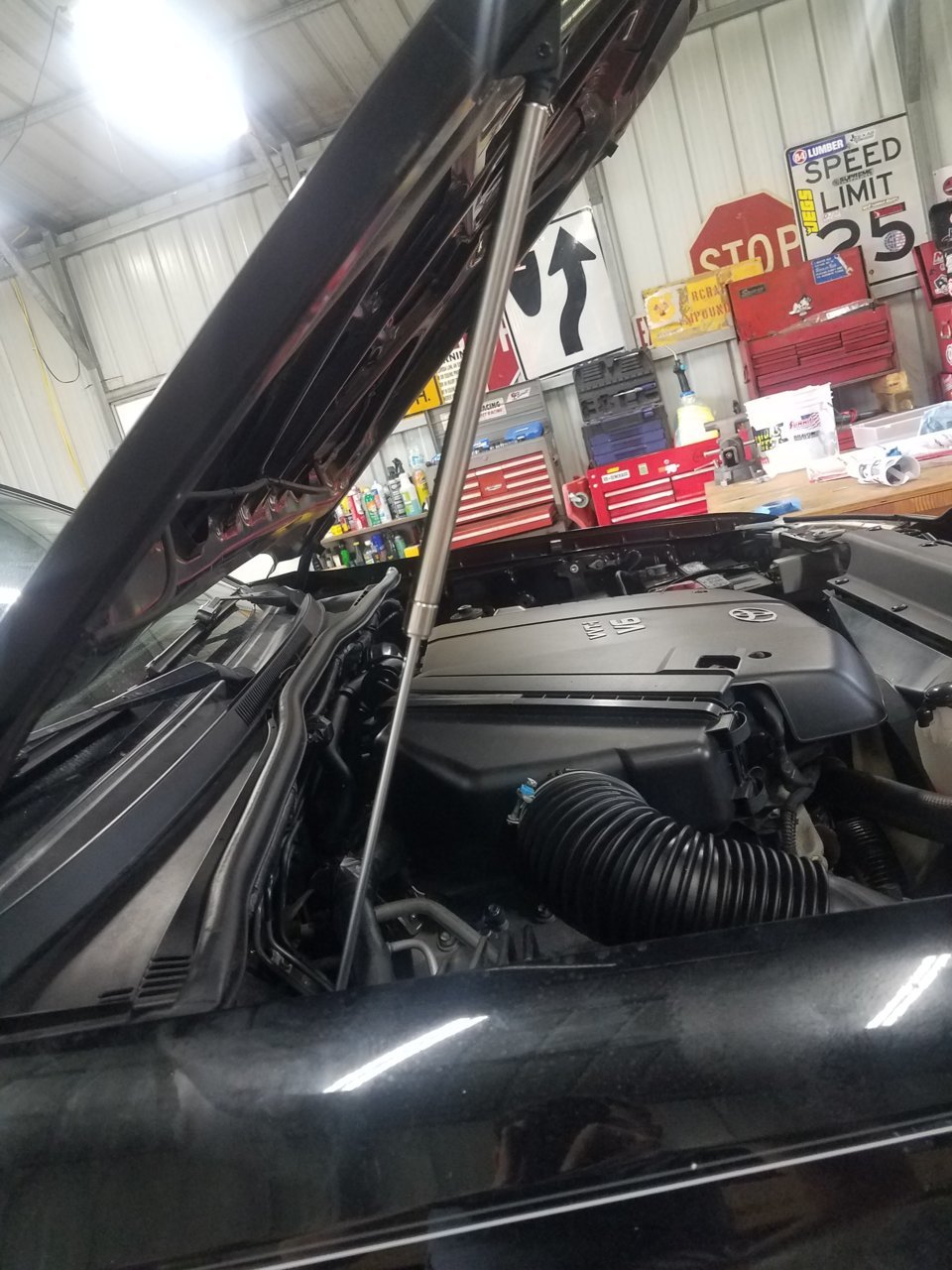

    Got the Redline hood struts in, what a satisfying upgrade!
    Diff breather kit should be here soon then probably get tint done and call this puppy good for a little while. I actually like driving it more now that I have mods to show off.

    Thanks! I know mine hadn't until now at 72k. Clutch pedal still engages kinda high however most of the shudder when releasing has gone away and it seems smoother all around.

    I was shocked at how dark the clutch fluid coming out was. I used the entire bottle of redline-600 and could have probably used another bottle just to be certain I got all the yuck out. These trucks are super easy to bleed the clutch which was a relief.

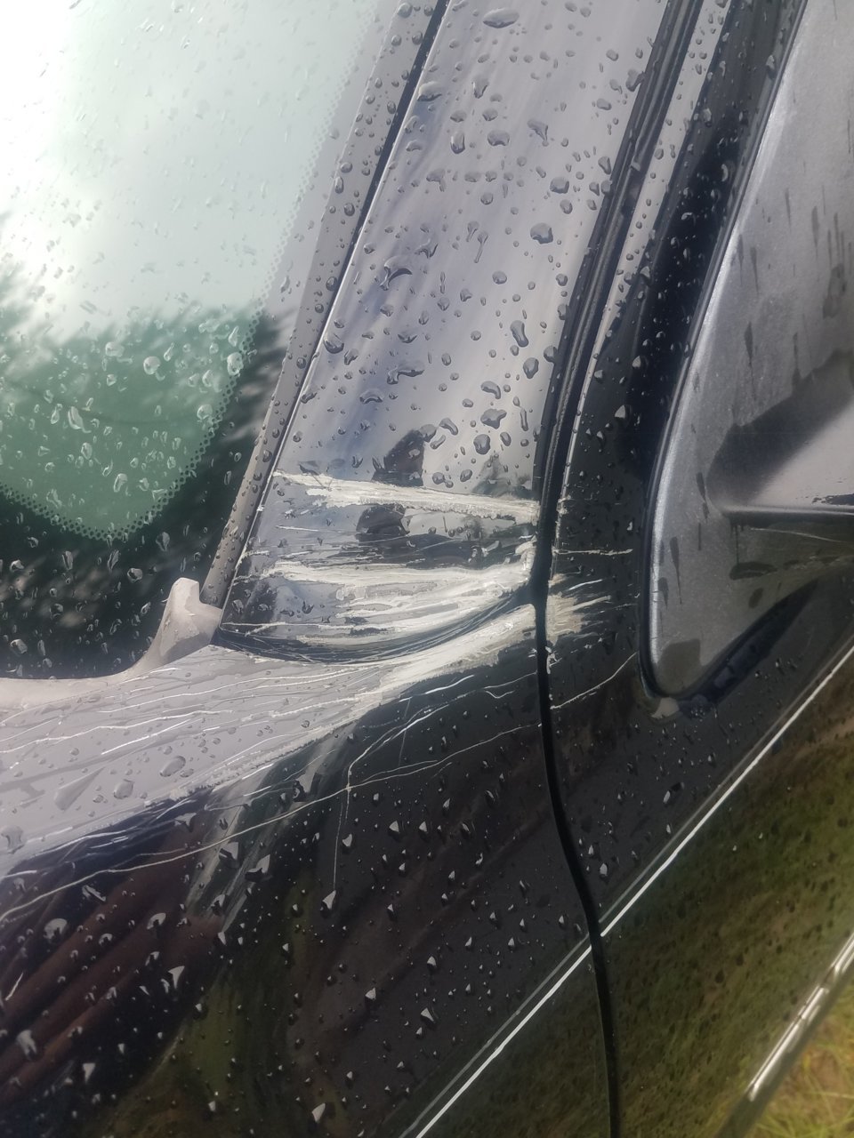

    Well, long story short a family member was borrowing this truck and had a medical event about 300 yards away from my house causing them to wipe out a barbwire fence and nearly roll it into a 5' deep ditch. Nobody got hurt but my beautiful unmolested truck is not so pretty anymore. The main damage is the plastic front bumper which is mashed in several areas, the hood that looks like Carole Baskins cats attacked it, the driver A-pillar that has deep cuts/grooves from the wire, the passenger fender flare is torn off, and the headlights are all scraped up. I'm gonna claim my insurance since it hit so many spots and I want it nice again.

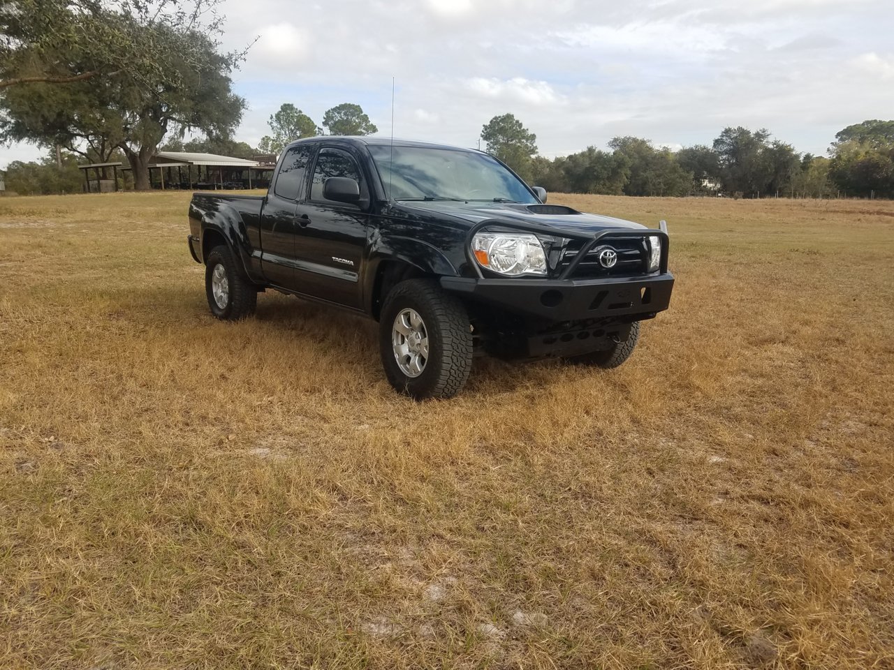

    The truck is finally about to be done at the body shop, got a sport hood and color matched grill added along with the AllPro APex bumper. I figured since the truck already sat a little nose down the bumper is gonna make it look worse so it needs a little front lift/level. I ordered Bilstien 5100s and OME 885s from Headstrong off-road and some Camburg X-joint UCAs. Can't wait to get it back and modded up!

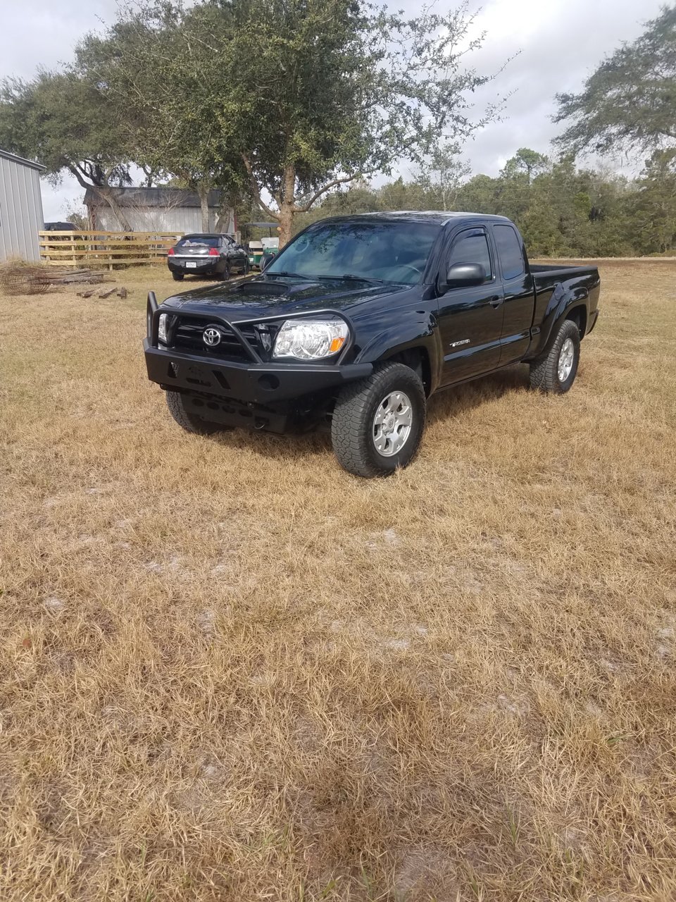

    Finally got it back from the shop Wednesday, and put it right to work today.

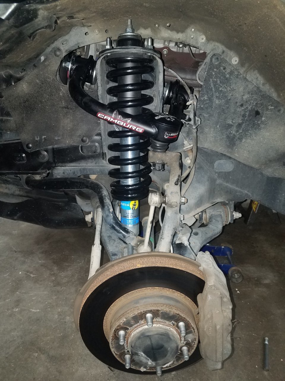

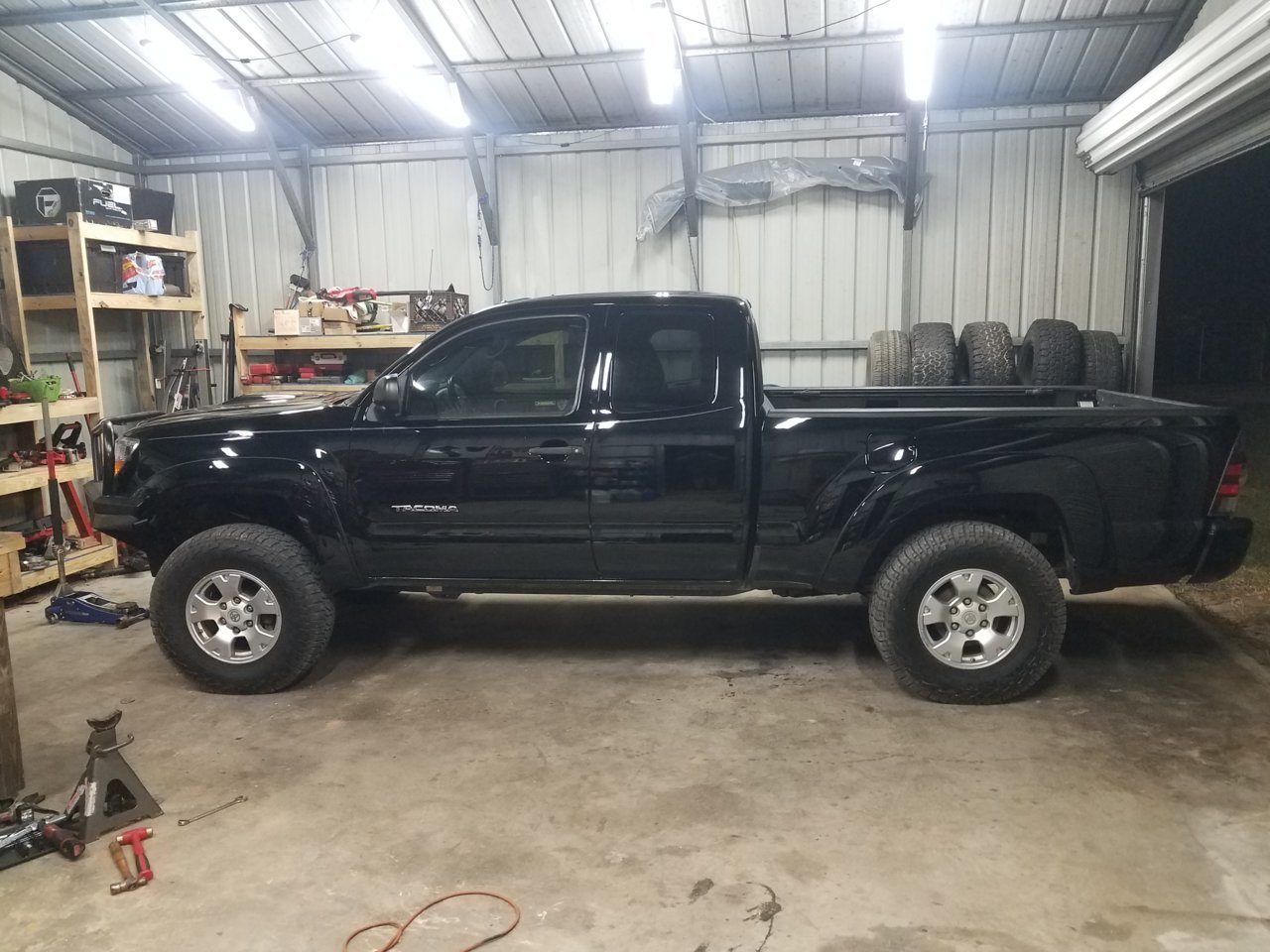

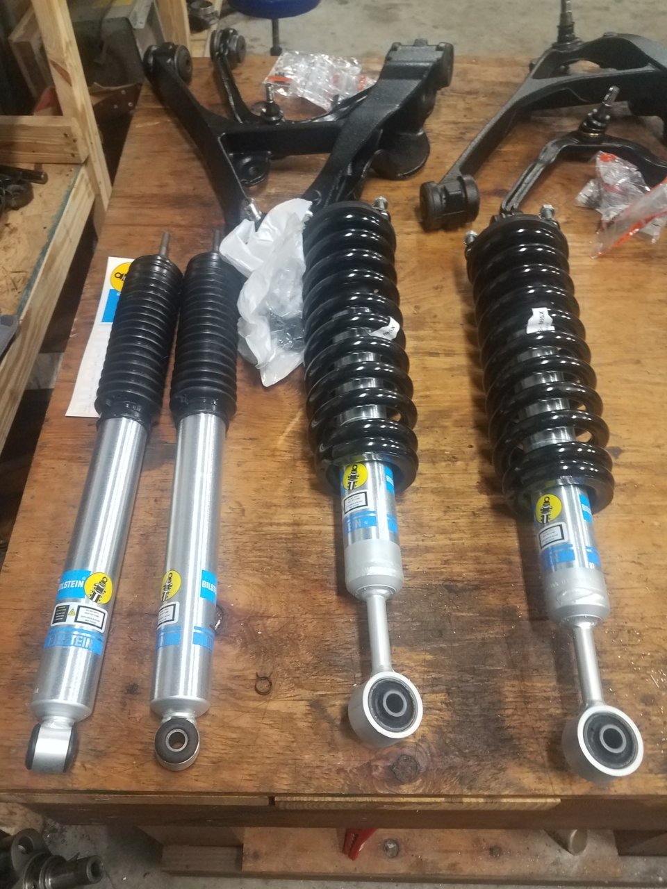

    Got the front on tonight in about 3 hours with the help of a buddy. Glad I bought new UCA bolts don't see how the hell anyone would do it without them. Realized the OEM brakes are pretty shot so that's gonna be the next thing on order along with stainless lines because at 10 years and 75k miles I'm sure the fluid is gross.
    Really happy with the 5100s and 885s got exactly 3" of lift and with an alignment and a few hundred miles I'm sure it will settle to the 2.5" everyone reports.
    Hopefully knock out the rear AALs and shocks tomorrow.
    Not a whole lot of difference but heres a before and after.

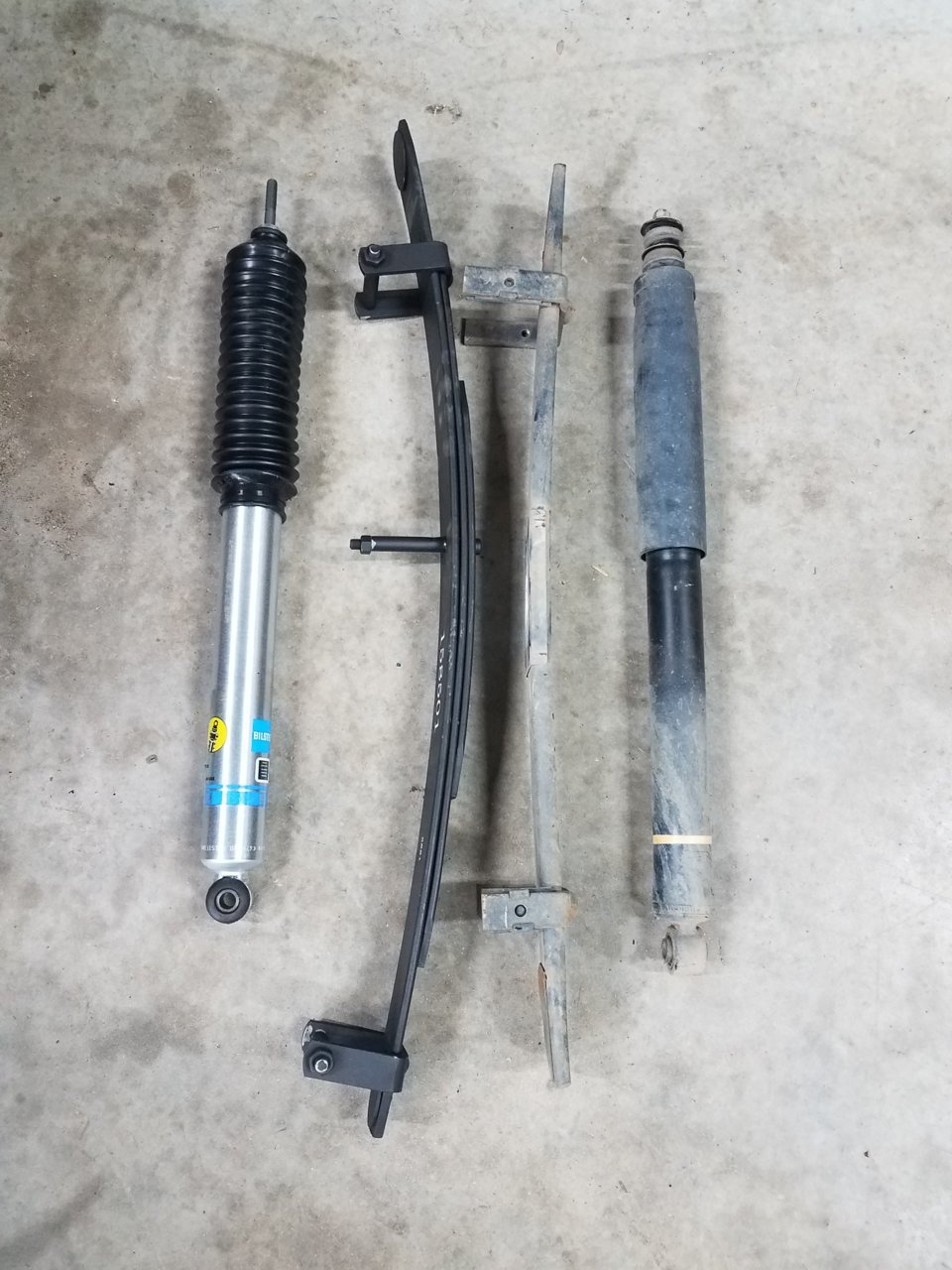

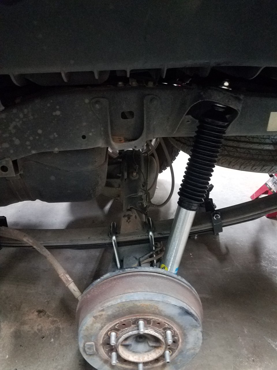

    Finished the rear AAL and Bilsteins. I love that these trucks don't come with garbage ass lift blocks in the rear, I hate GM for those. Really happy with the ride quality! I took it down my local sandy strip again and could easily hold top of 2nd gear and not have beer splash out the can. Tint, alignment, pads/rotors, stainless lines, and amber LED fogs are next on the list. 20201229_183014.jpg 20201229_193731.jpg
