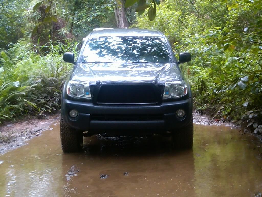

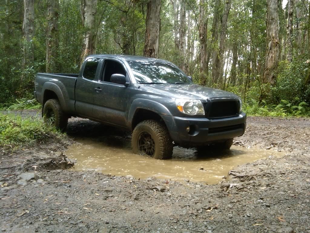

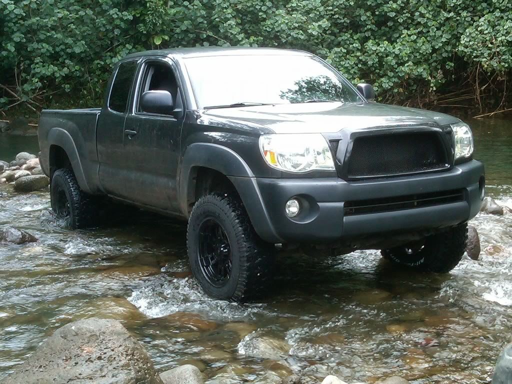

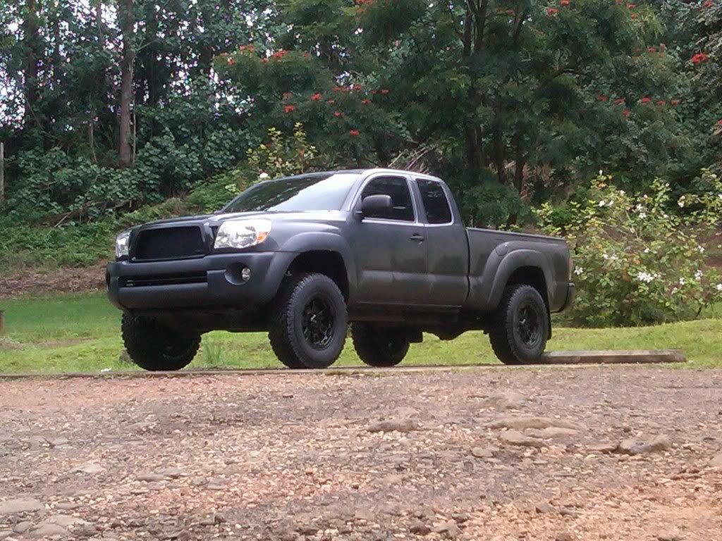

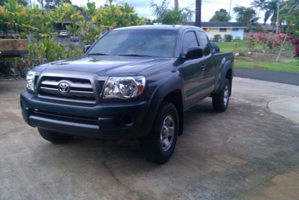

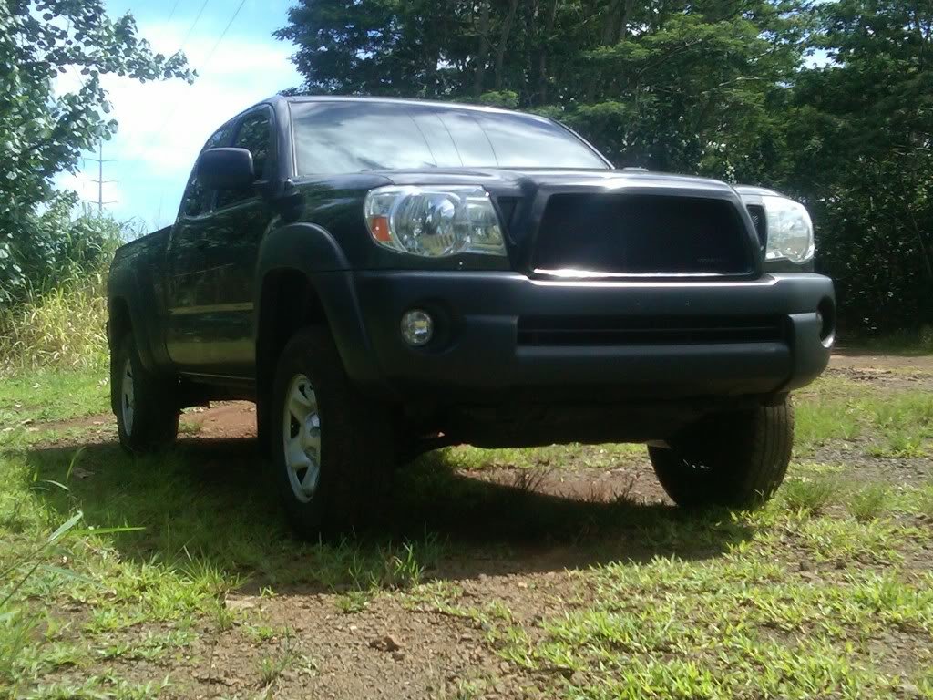

    Finally got some time to post up a few pics of my Tacoma. bought it back in 09. All questions and opinions are welcome.
    STOCK
    Pic. shot from my Backhoe at work.

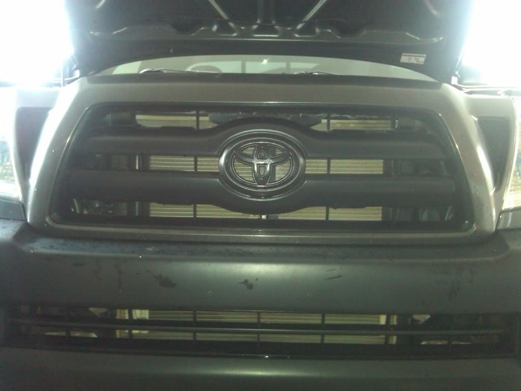

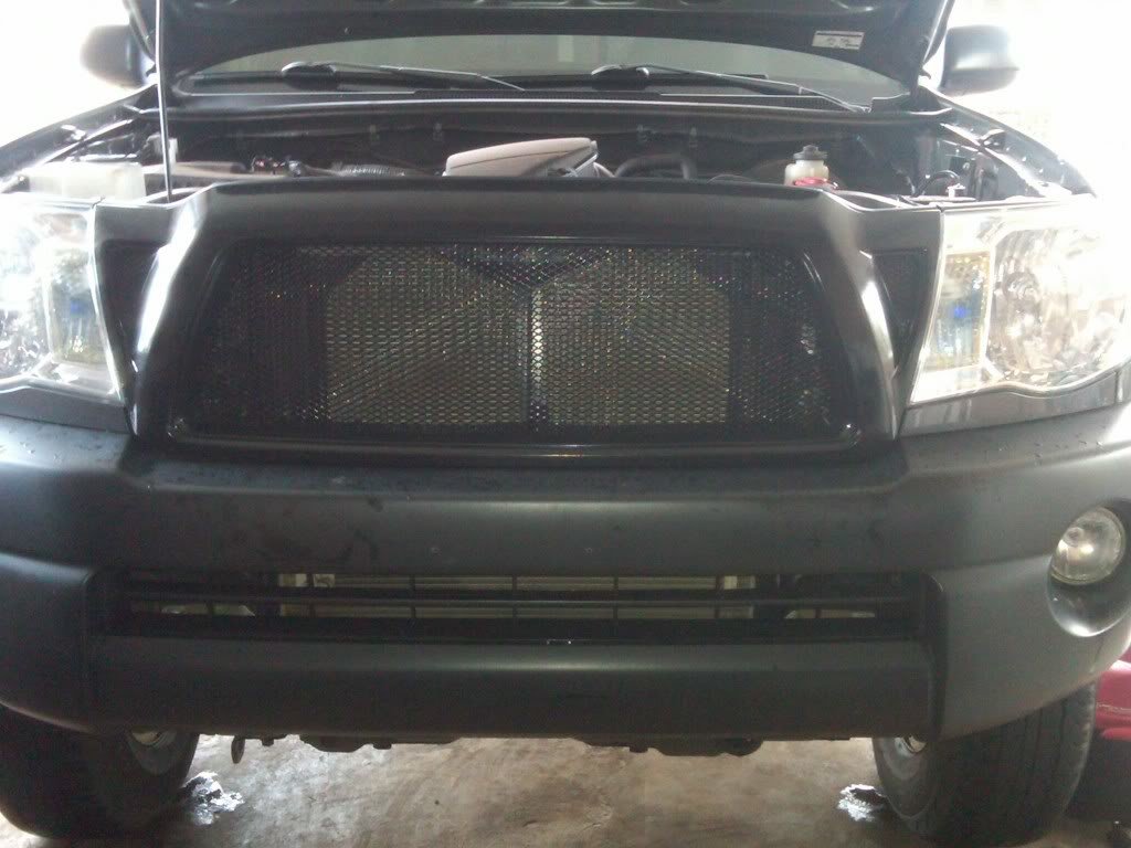

    Stock grill, ready for the Satoshi.

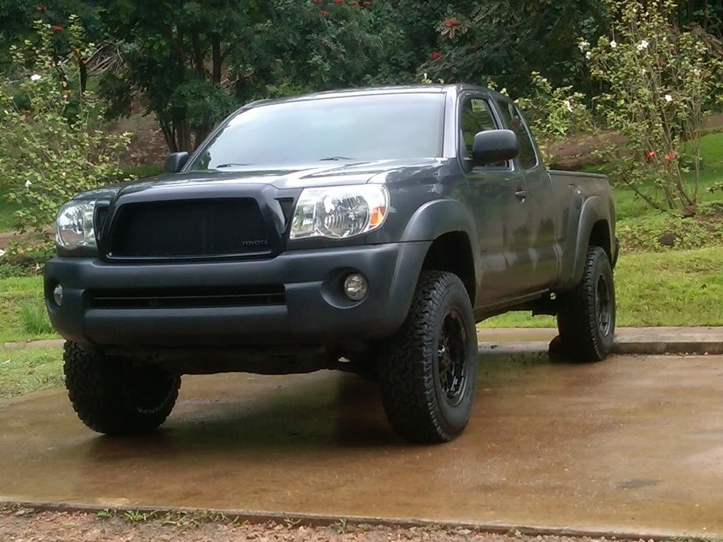

    Satoshi with Grillcraft grill

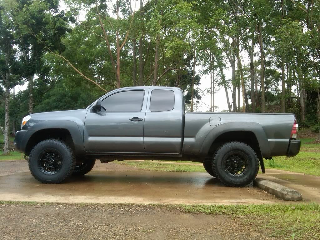

    Added Hell Bent Steel 1-1/4 leveling kit

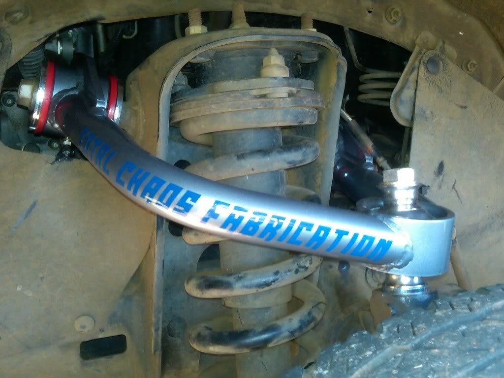

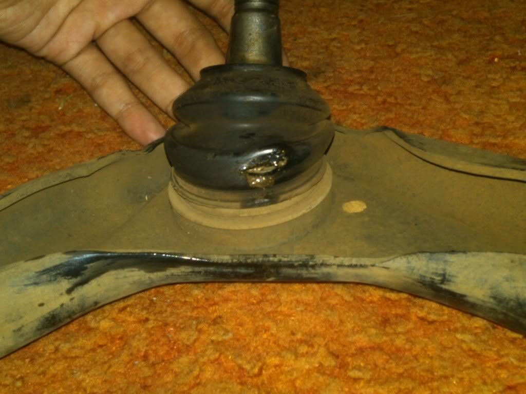

    This is what happens when you have 3 inches of lift. With out installing new UCAs. The ball joint was hitting the coil.
    Total Chaos Fab. UCAs

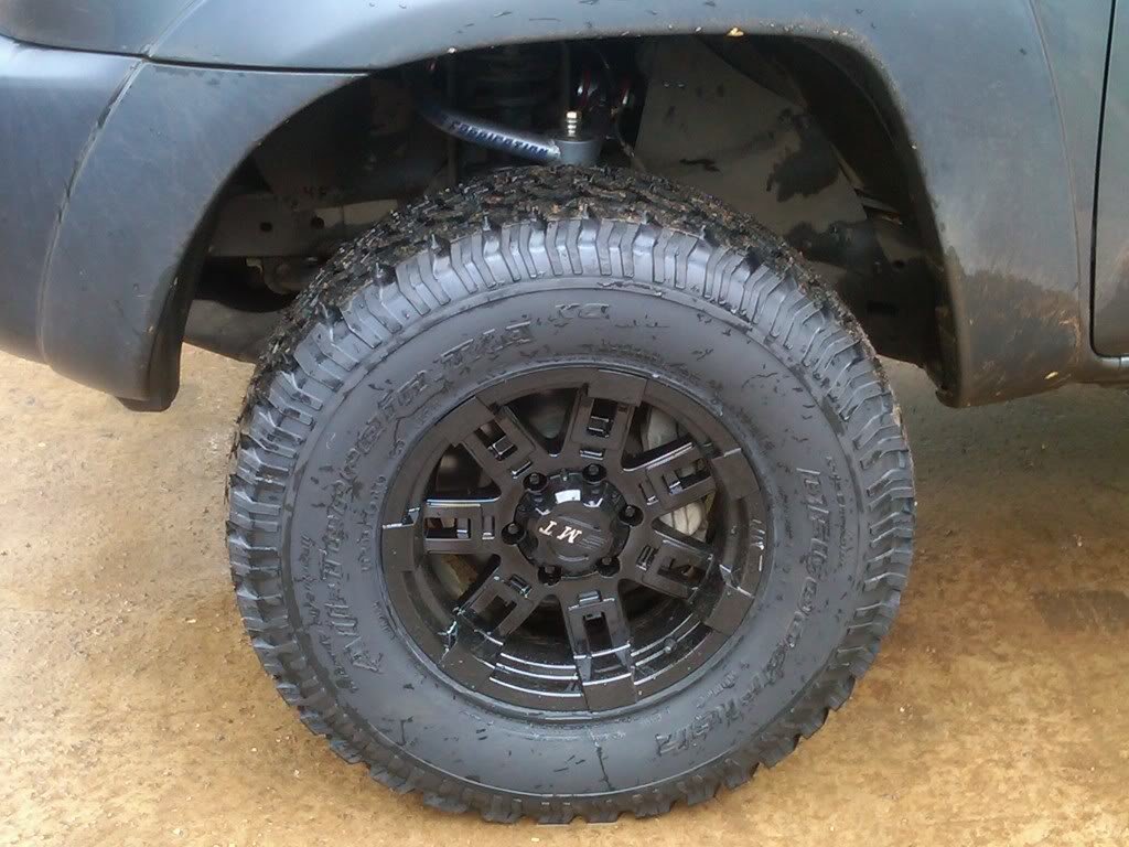

    New rims and tires. Mickey Thompson Side biters(16x8) with BFG A/T KO 265/75r16.
    Some pics before a little light wheeling.
    Some light wheeling HAHA

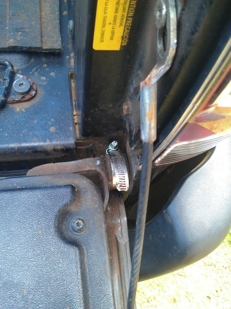

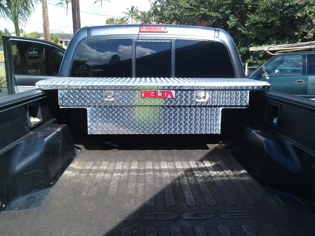

    Tail gate mod.
    Delta low profile compact truck box.

    Thanks guys, Just have to modify the front mud flaps. So the tires don't rub, that's what they told me at Costco.

    nice build man. i would just take the mud flaps off> front and real looks much better IMO.
