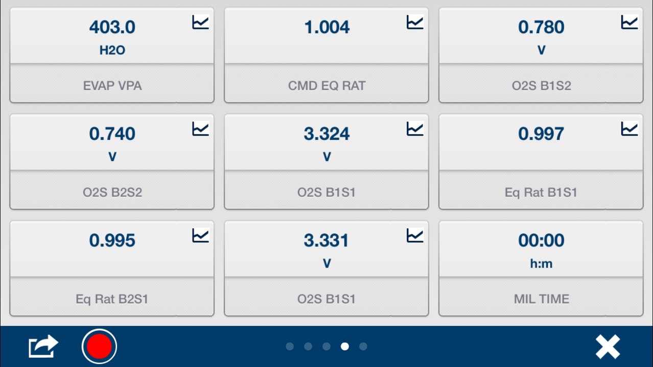

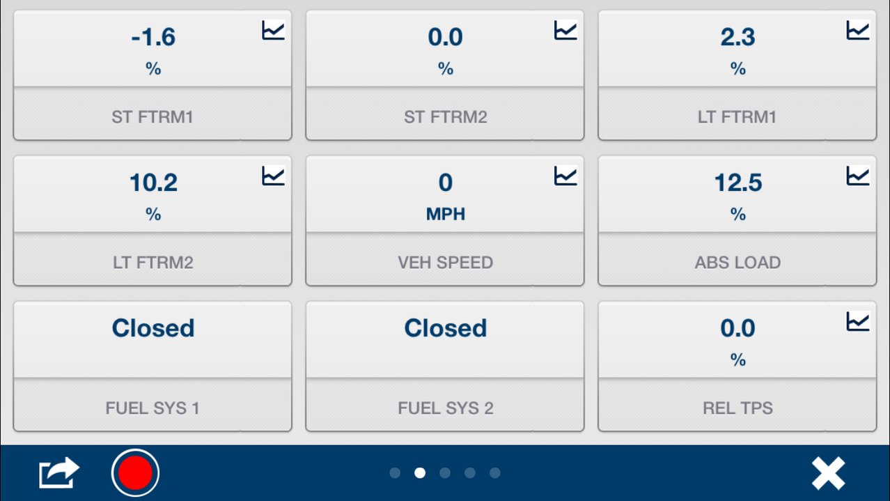

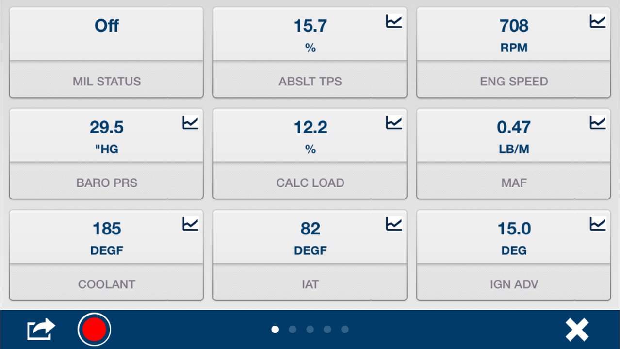

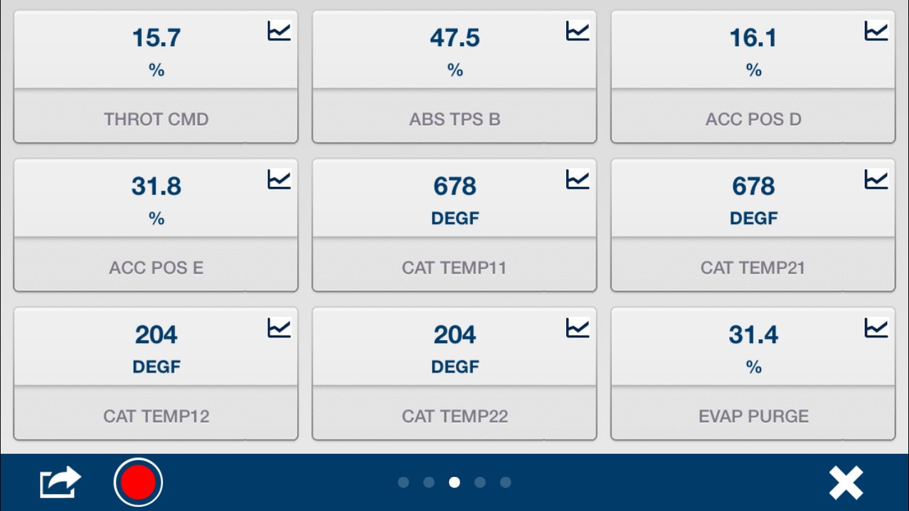

    Been reading threads on here and using this forum as my primary resource for all things taco and finally have something I feel is worthing posting about. Within the last ~6k miles I've had a intermittent idle issues. Having limited knowledge on diagnosing such I decided to fork over the dough for a bosch obd1050 in hopes that it's data log function may be of some use. Here's what it's come up with. IMG_0498.jpg IMG_0499.jpg IMG_0500.jpg IMG_0501.jpg I'm having trouble interpreting what some these values are, what I want to know is if any of these will give me AFRs. So far I've narrowed the problem down to fuel delivery issues a vacuum leak, MAF sensor or vvt control valve, but there's always room to expand that list. lol.
    My hope is I didn't spend money on an idiot tool that only tells me what the idiot light is trying to tell me
