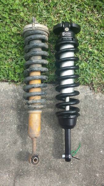

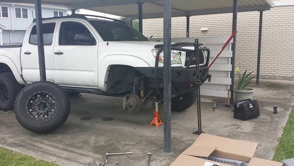

  17. Sep 1, 2014 at 3:23 PM
    #17
    Sje1124
    Sje1124 Well-Known Member
    Nov 1, 2010
    #45564
    5,023
    Sean
    Louisiana
    2010 DBL Cab TRD OR 4x4
    Just a few
    I average 700# springs on mine. If you need a little more room to play with use a pry bar and push it down wile inserting the new coilovers. I've changed mine multiple times this way with NO problems.
  18. Sep 1, 2014 at 3:26 PM
    #18
    Sje1124
    Nov 1, 2010
    #45564
    5,023
    Sean
    Louisiana
    Just a few
    This was my OME 886 with top plate spacer vs the Extended Travel Icons with 700# coils
    This is how I did mine. Took me 15 minutes per side as I only loosened 4 bolts on each side.
