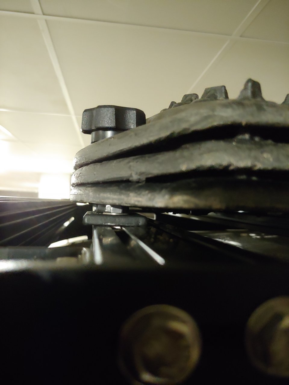

    DIY Maxtrax pins here I come!

    Success! Only cost me like $25 in materials too. Had to buy a hack saw and some other stuff because I am lacking on proper tools.

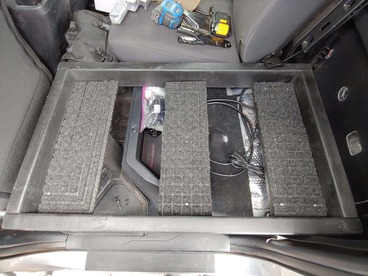

    Just need to add some tie down points and fridge tray "should" be complete!

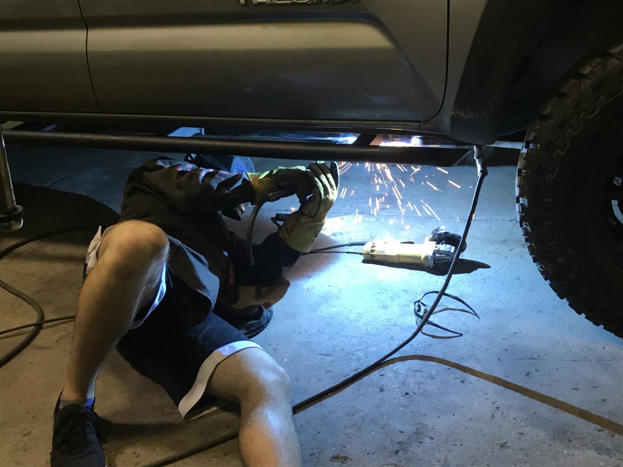

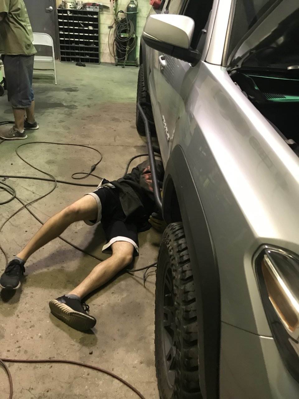

    First time welding and they let me weld on my truck :rofl:

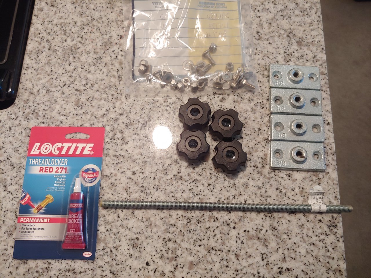

    Completely forgot about this but,
    (1) 1ft 3/8 threaded rod cut into 4" sections
    (4) 3/8 Steel flanges
    (4) 3/8 Fluted Plastic Knobs
    (1) tube Red Loctite
    (16) carriage bolts/washer/locking washer/nuts. Pick a length that will work for you setup.
    Pretty much, cut the threaded rod into 4" sections
    -Coat the end of your choice in Red Loctite, thread it into the flange
    -Let set/dry for 30min or according to Loctite tube
    -Thread the carraige bolts into you crossmembers, loosely attach the flanges with washer/nut/locking washer
    -Slide in the track to align for your maxtrax board mounting holes
    -Screw on the knob to secure it down

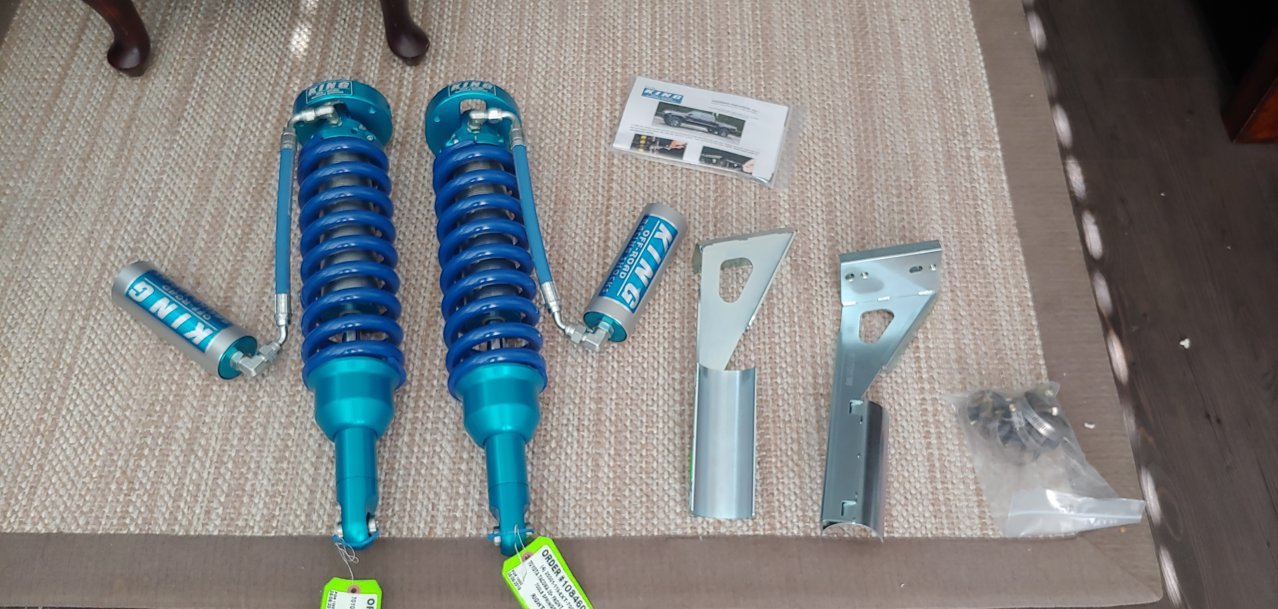

    Yean man. Wheelers had them w/ 700lbs springs for $1270 shipped. Couldn't resist lol
