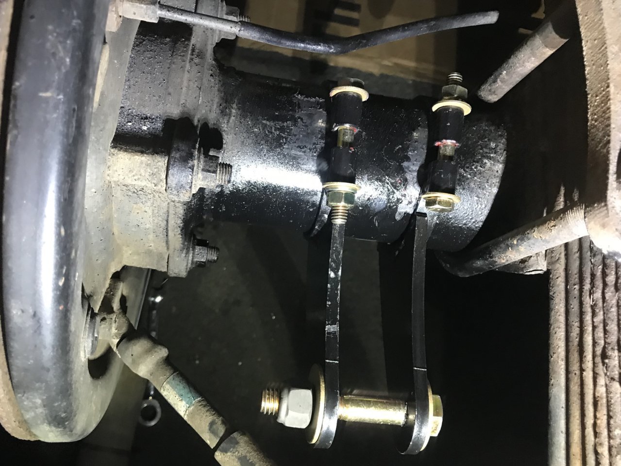

    So if i replace the whole axle, anyone know where I can get one? Im in Pennsylvania if that helps..

    Hit the PA and NJ BS threads, I think someone had one for sale somewhere local-ish.
    Or buy me a decent Ford 9" rear axle, and I'll give you the taco axle off my truck, installed and everything.

    A set of 4 (enough for both sides), with all the hardware, will be $85 shipped.

    I'd get the Hoop for $85.Alex. plus youll need new shocks by the look of the broken one that's not a bad total cost on a fix

    Any fabrication shop can reinforce your axle where that broke off,and weld on new brackets,then you really need too clean up the whole axle/paint and keep the axle coated from then on.

    Frame is good, was replaced. Axle is what's worrying me.

    might not be a bad idea on maybe a fabricator weld a new mount on, if you can find one willing to do it for less than $85 I would do it. I did once see a 3rd GEN owner had some kind of traction bar setup welded directly to his axle and the welder burnt right thru it and leaked, whereas the hoop just gets bolted to the axle after cleaning off some corrosion
