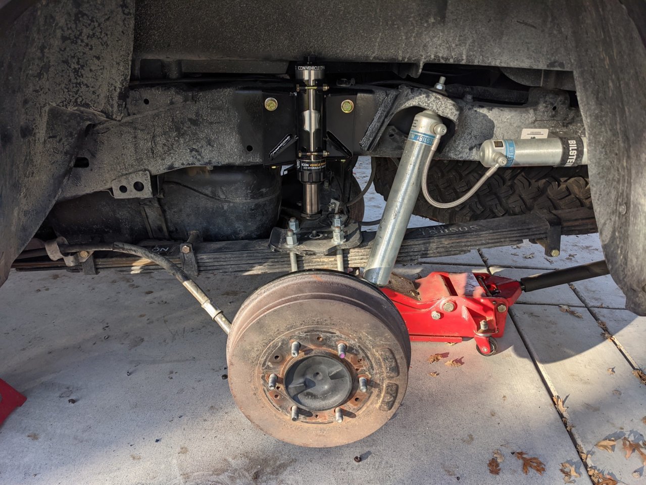

    Bilstein 5160's & Icon RTX leafs set at stage 2 helped with my bottoming out when unloaded but not when loaded for camping out on rough trails/ dirt roads. I tried Sumos, Super Bumps, air bags, etc. to no real satisfying conclusion. Hydro bumps ended giving me what I was looking for. Pricey but worth it for me.
    wL7eMegdxfXddPZ_v5KE0Dh1w8Idc_g8LQ7qepO6_ef7e709658d9978058b570aaeb1eff915074ae01.jpg
