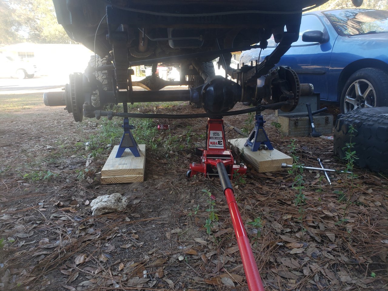

    I messed up and bought a Sassed 97 tacoma (buying a tacoma isn't where I messed up) but the dumbass I bought it from is where I messed up. After I realized what I had on my hands I found that the inner c on the dana 44 was never rotated do I have to remove the axle and cut and rotate them or can I leave it under the truck and is 5 degrees to much or set it at zero thanks the part number on the front spring say 8in spring but I'm not exactly sure what size lift it is please help this is the last thing on my list to get this thing rolling thanks 20201202_142243.jpg

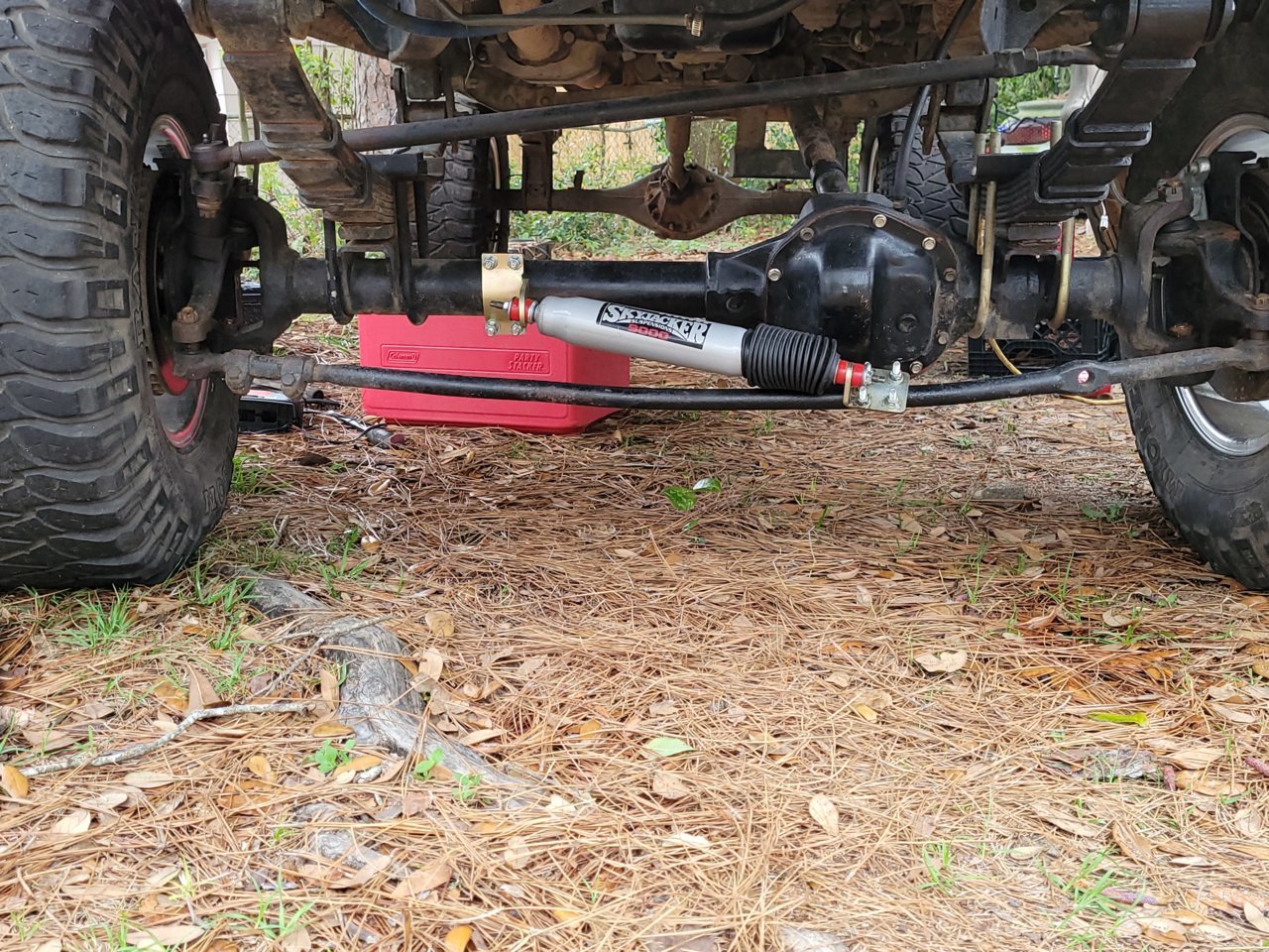

    Your at a crossroads with this axle. From the pic (more pics will tell) it appears they cut the factory perches off, rotated the pinion, and then welded the new ones on but forgot to turn the Cs to set appropriate caster (5 to 8* positive aka rotated back towards the rear of the truck). Does wonders for the pinion, but drivability suffers greatly.
    Two options:
    1. Cut the Cs and rotate it properly and keep the pinion and current DS angle which looks semi decent as long as that's now a CV style and not 2 ujoint out of phase... http://d44tech.com/CutandTurn_Main.html
    2. Cut the perches, set pinion back to factory spec and weld on spring perches to gain back the caster that was lost due to rotating the pinion. But lose pinion angle and if a CV driveshaft you'll need to go to a single u joint at either end to be phased correctly.

    Good call. I didn't even notice that. It looks like it was a spring under that was converted to spring over.
    OP: get your suspension figured out with your ride height, then redo the perches or cut and turn the Cs if needed. You're fixing the cart before the horse so to speak.

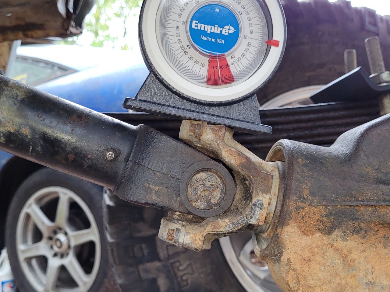

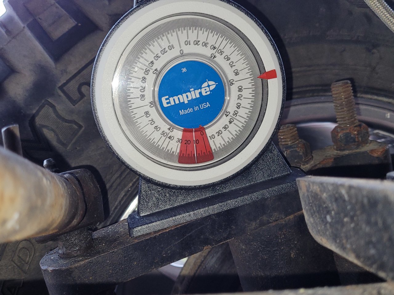

    Caster definitely needs to be fixed, your actually reading about 5 degrees negative camber. Putting you actually around 10 degrees in the wrong direction.
    Though that tierod looked like it was pointing down too much. That'll fix that issue too. Pull some springs as said and get ride height you want. Then cut n turn the Cs and keep the pinion where its at.

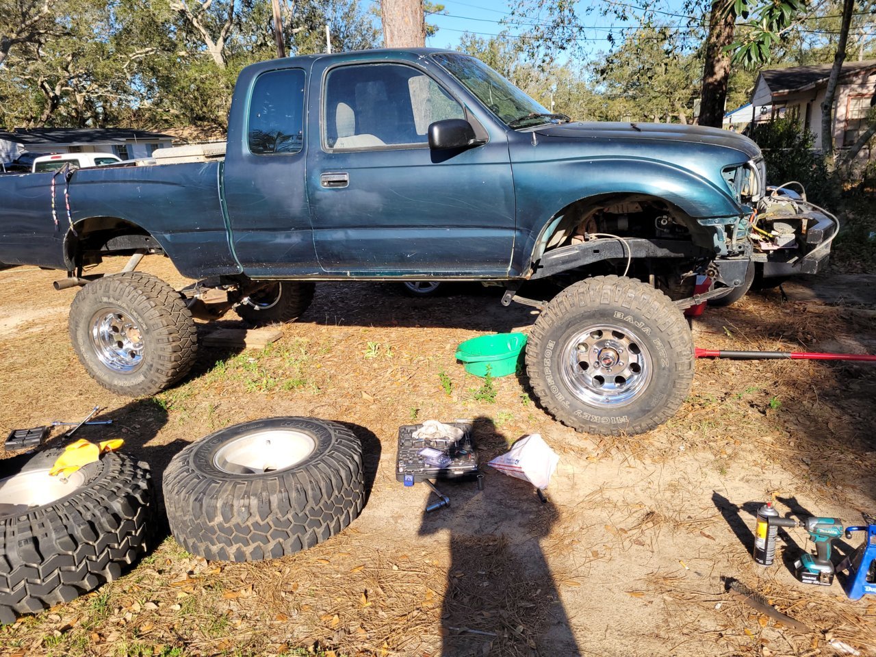

    How would I go about measuring the lift on it and the springs so I can order new leafsprings

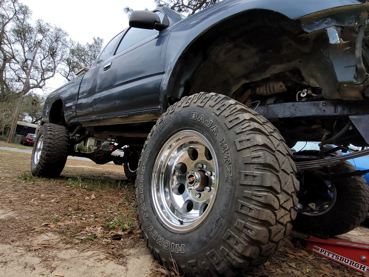

    Got any actual side shot of the truck on 4 wheel?
  19. Mar 25, 2021 at 10:37 PM

    97 Tacoma SAS
    Can take more

    As others have mention, start by removing leaf from the pack. I would start by removing 2-3 lowest leaf and go from there. Unless you have money to burn, you can order new leaf but I don't see any reason not to unpack those first. I notice for the front, there's a ~1" spacer between the perch and leaf, trash that along with the 2-3 leaf and I think you'll be golden. As for the rear, trash the 3" block and go from there.
