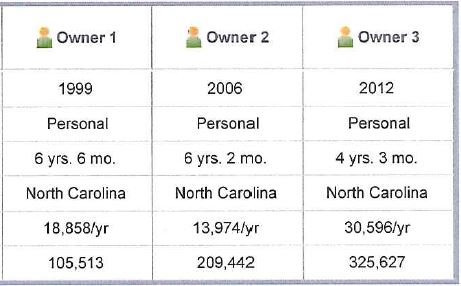

    Yeah, Im the fourth owner now but unfortunately this is about the most info I've got on it. I've got a couple cans of PB Blaster on standby for those stuck bolts.
