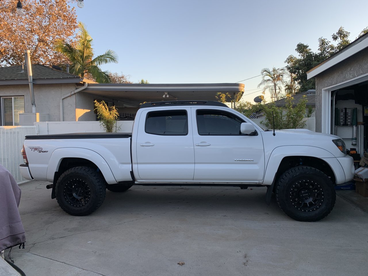

    Just bought my first Tacoma - 2010 DCLB TRD Sport - which the previous owner modded and I'm hoping to change his mods to better suit me. According to the previous owner it has a 3"/1.5" leveling lift. It also doesn't drive as well as I think it should. The front end seems to have some bump steer or a bit of a shimmy. Rear end seems unstable over bumps at speed in sweeping turns. It tracks straight and I don't see any uneven tire wear. I'm assuming that the lift, and/or the wheels/tires, is causing these two issues but wanted to hear what others thought. For all I know it could be in need of a bushing or something. I'm new to trucks in general but not new to wrenching on cars.
    I've gone over the truck and done a lot of researching here and here's what I've come up with so far in terms of what's on the truck now:

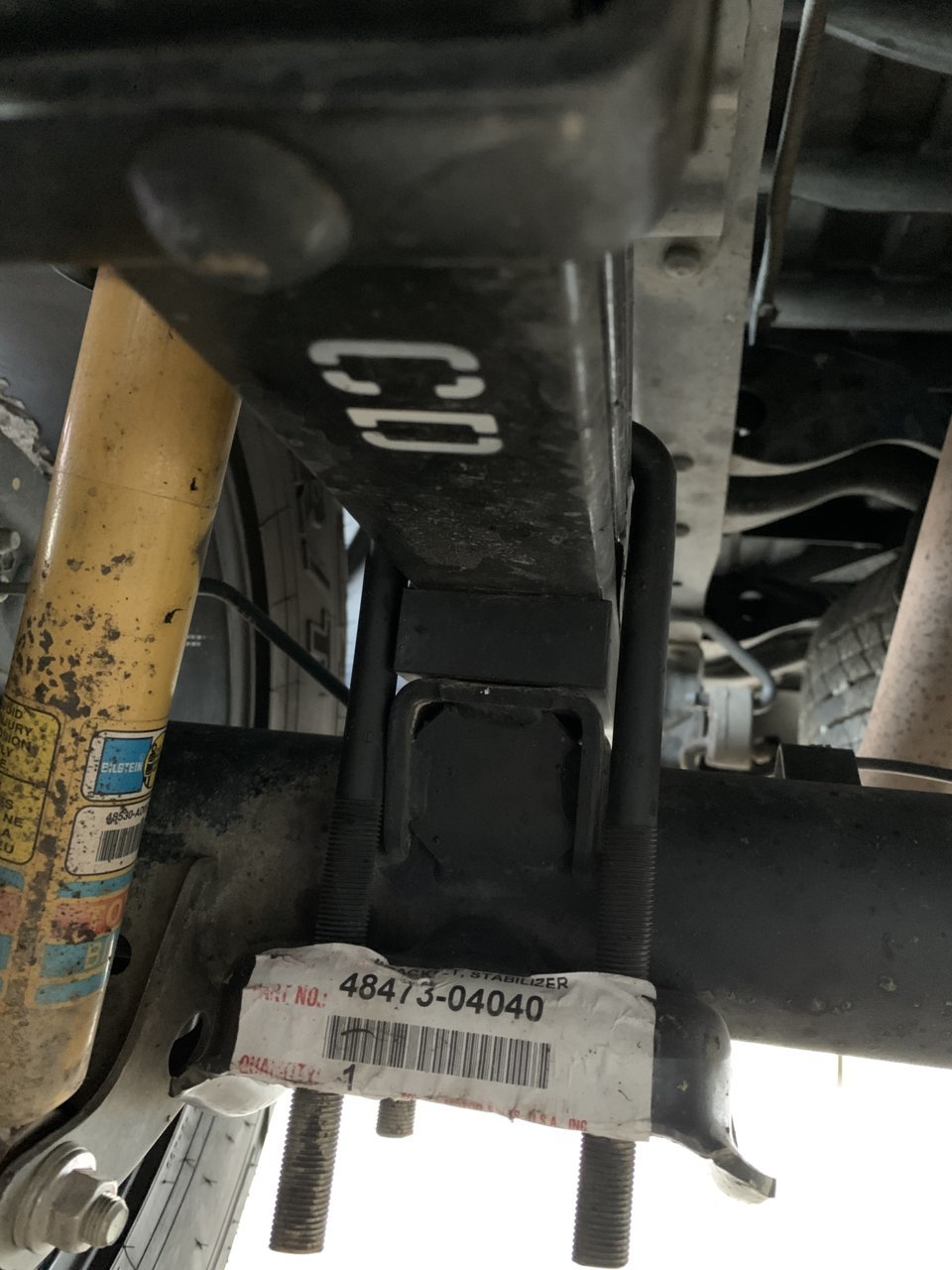

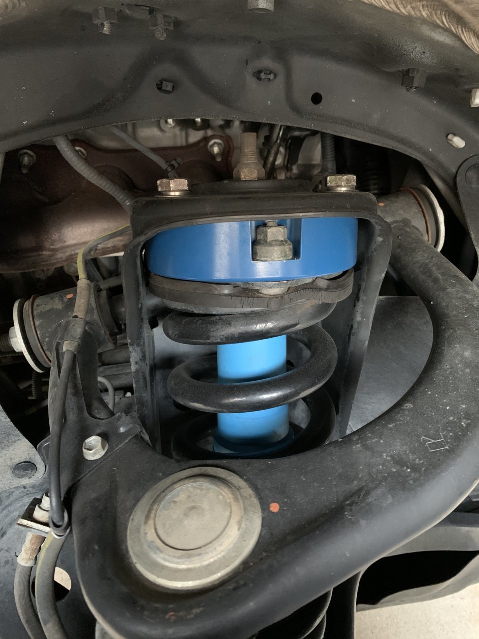

    • Front: 2nd Gen TRD Off-Road shocks/springs + ~1.5" spacer (22.75" axle to fender)
    • Rear: TSB leaf springs + ~1" lift block (22.75" axle to fender)
    • Wheels/Tires: LT285/70r17 Toyo Open Country RT on 17x8 Pro Comp wheels. At 90lbs/corner I'm hoping these are the cause of my poor mileage (15mpg on the 350mi freeway drive home from picking it up).
    • Currently it looks about level or if anything a tad higher in the front.
    What I'm looking to achieve: First and foremost I want to fix the handling issues mentioned above. Second, I want a mild lift, primarily for a lil extra ground clearance. I'd like it fairly level but would err on the side of higher in the rear than the front if anything. This truck will be used for hauling (think construction materials like wood, gravel, sand, dirt...etc) as well as camping trips. I don't foresee any towing in the immediate future. I really like the look of the TRD Baja / Pro, so I'm thinking somewhere around that amount of lift would be perfect. In general I would prefer softer, more compliant suspension rather than something stiff. Most of the off road conditions the truck will see will be in the Sierra Nevada mountains for camping and definitely lots of washboard roads. I'm not looking to spend a lot of money and want to just do something entry level now to get my feet wet.
    What I'm thinking: My guess is that the lift on here now is too big not to be combined with additional parts that correct suspension geometry and possibly driveshaft angle. So, I'm assuming I want to lower it a little. I have read that 3rd gen suspension provides a little lift and is cheap so I was thinking of replacing the current front suspension with lightly used 3rd gen springs/shocks. Possibly with a small spacer? For the rear I'm not sure if I should ditch the lift block altogether or use a slightly smaller one? Maybe a mild AAL?
    I'll also just bought the TRD beadlock wheels and plan on getting some LT265/75/r16 tires (likely Pirelli Scorpion AT+). Hoping to sell the current wheels/tires to fund the new ones.
    Any insights on the handling issues and recommended suspension for my needs is greatly appreciated.

    How much lift do you need before you need upgraded UCA's? Best I can tell from my searches it's about 3" (where the truck is now) but I'm looking to lower it from where it is. Assuming I go with a lift that's about half as much as is currently on the truck do I still need UCA's? With the high cost of UCA's I'm hoping for a setup that does not require them. And, if even a very minor lift requires them then I'll probably just bring it back to stock height and call it a day (at least for now).

    SPC upper control arms, set them at 2.5-3 degrees of caster.. would drive awesome!

    Make sure you aren't riding on your bump stops in the back. I was riding around for a while with maybe 1/4 inch before the bumps hit on level ground, and on curves the rear axle got really squirrelly probably because I was fully on the bump stops on one side of the truck. Stiffer springs really made a huge difference, on pavement and off.
