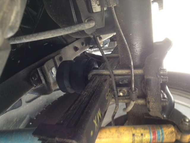

    Well I put the camper in and it sagged pretty damn good in the back. About 2 inches of sag at the rear hitch. The ride quality was actually terrific though and it handled highway speeds +10 up and over mountain passes with ease; cornered well too.
    I picked up a set of Timbren SES heavy duty bump stops (rubber springs) so they would help carry a load when loaded, but not affect the ride quality when not loaded. Based on my research and figurin' I decided these would ride much more smoothly than airbags. I installed them today in about 20 minutes and the ride is even smoother than before (with only my standard Canadian 4-leaf pack), and it levelled the truck out completely. I'm really happy with them. They absolutely eliminated the sag, improved ride comfort and handling, and installed in the time it takes to drink a cup of coffee.
    The picture shows it parked in my driveway on an up-slope so you can't really tell but on level ground it has a little bit of rake in the back end.
