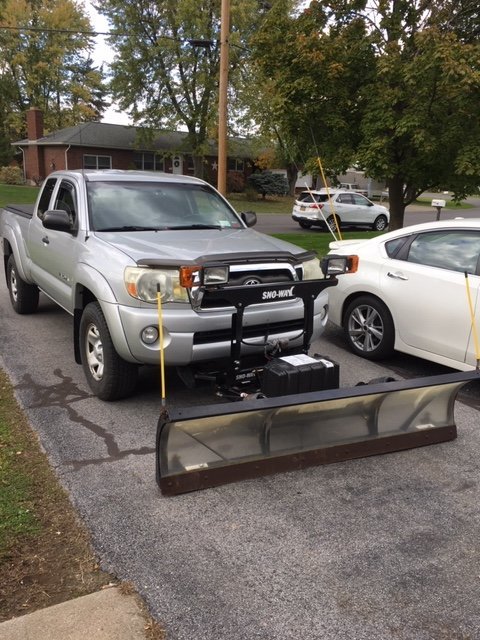

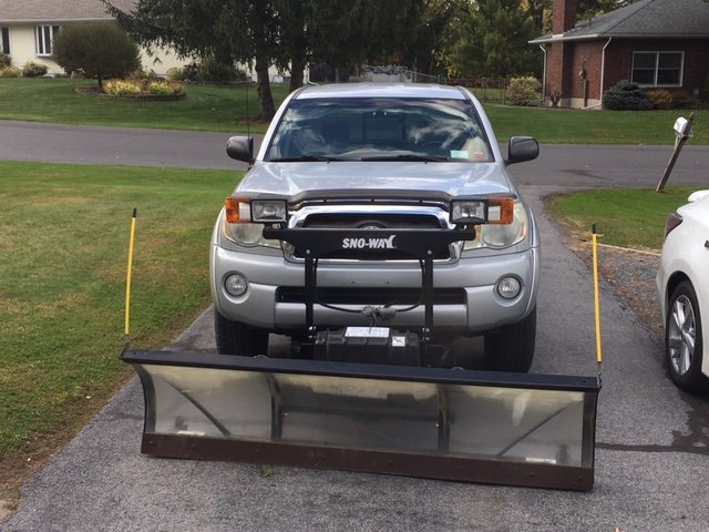

    906
    2008 Taco SR5 Access Cab 4.0 4x4
    Hmm . . . none as yet, that's why i'm here . . .
    Love my sno-way, that and the taco are a great combination.

    keith
    upstate ny
    2015 base crew cab tacoma
    camera source backup, camera seat covers,intermittent wiper arm
    I get about 60 inches of snow/year- 125 ft driveway 20 ft wide- fisher homesteader poly plow. 280lbs (4- 70 lb sandbags in back) 2015 xcab 4x4 4cyl works great I dont rush it - I dont bang the banks. plow is easy on/off (keep it in garage) but little squat with it on -just easier to park
