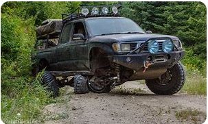

    nitemare pictures!!
    2002Tacoma4x4 likes this.

    Just a quick image search away. Easier than digging through the "My front wheel fell off" posts here (roughly 1-2 a month).

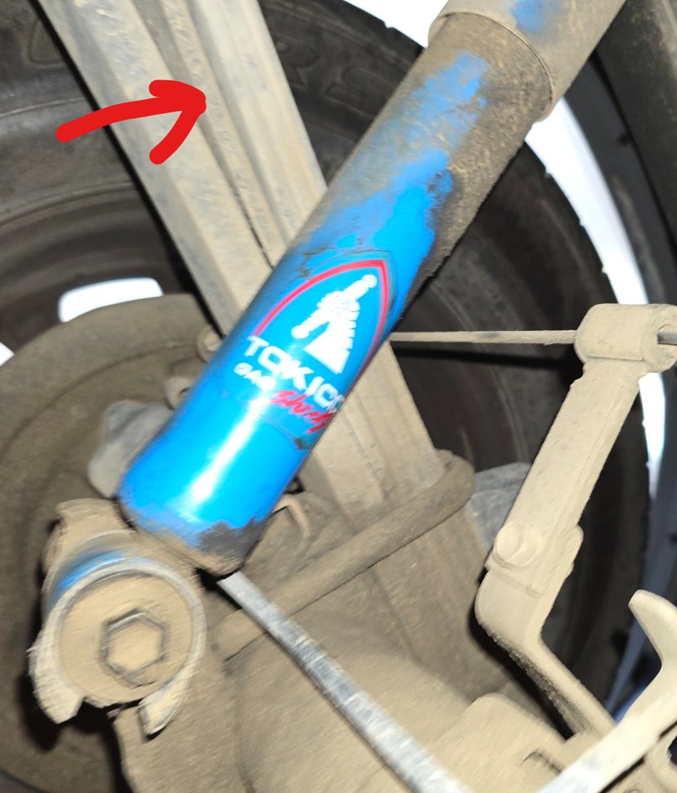

    The rear has a single leaf Add A Leaf already installed into your leaf pack.
    The stock pack is 3 leaf + overload- you can see that you have 4 + overload.
    Shocks themselves do not alter suspension height.
    I would bet that the previous owner ran the fabtech shocks until they failed, and rather than replace them with the right shocks, just put the OEM ones back in. Or they never installed the fabtech ones to begin with.
    Either way, the back is already lifted. you just need to replace the shocks. Also make sure it's got an extended rear brake line. If not you need one with the lift and shocks. The current shocks would limit down travel and to some extent prevent the brake line from being stretched to break.
