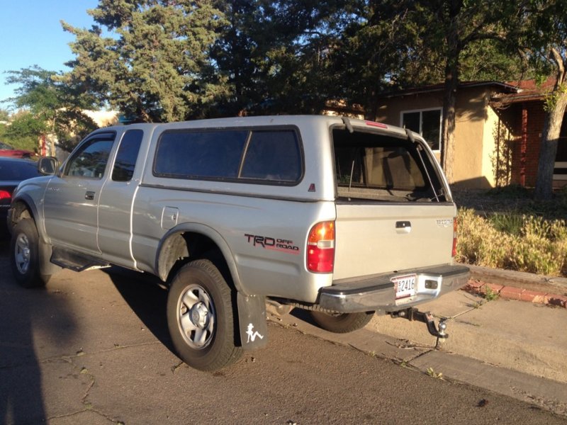

    I know your pain. Bought one of craigslist for $80 all color matched and everything but no rear door. Mine sucked especially because the model I bought was just a curved piece of glass instead of a door so I couldn't just get a glass shop to cut a piece
    Here is when I bought it.
    After $350 later for a piece of glass here it is
    I would say get a quote from a glass shop or even plexi glass it as that is a cheap alternative

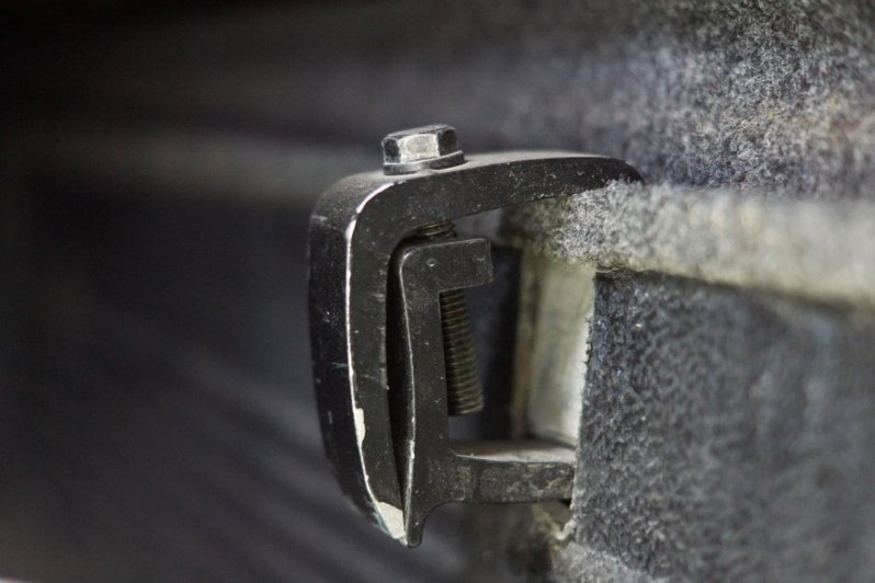

    Yeah I would plexi glass the front too.
    I have a bedliner that covers the rails. I just cut some holes in the bedliner up to where the rail is, just enough to get the clamp in kinda like this picture

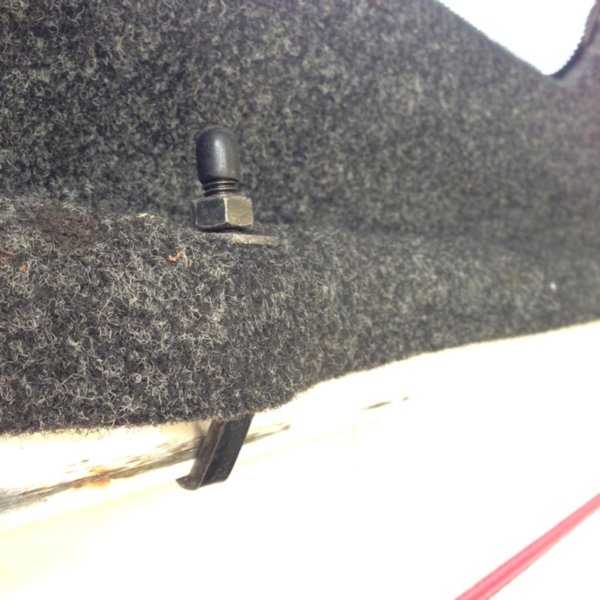

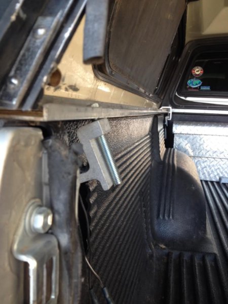

    Haha it really does depend on the topper. My first topper I bought the wrong clamps and this happened

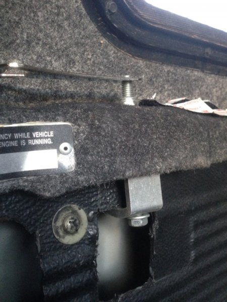

    I can go get a pick of what mine are now. Mine are a simple J hook but the topper was made for it. Kinda like this
  9. Sep 13, 2015 at 5:59 PM
    WildLand
    WildLand Does Ursus arctos defecate in deciduous forest?
    Dec 16, 2012
    #93212
    10,487
    Josh
    NM
    16T4RSR54WD
    Dont mind the bottle opener on top of it
