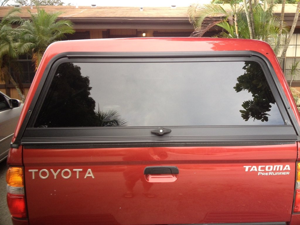

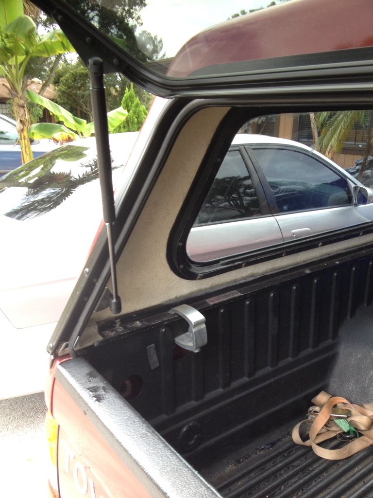

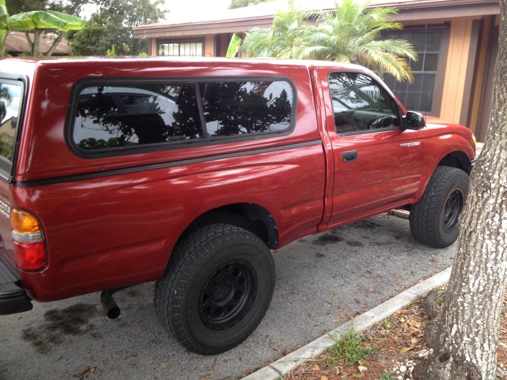

    Well I mounted it on Sunday after I glued the plexiglass to the front opening and removed the old purple torn up tint. What a pain in the ass that was cutting the right size.
    Then I got the exact fit clamps part no ac1043 .
    Then used the 1 1/4" topper tape . I got off Amazon for $6.
    After $422 , I had the rear door installed. Included the frame, struts, new lock , handle, keys . Everything.
    Well worth the money.
    Here's some pics.

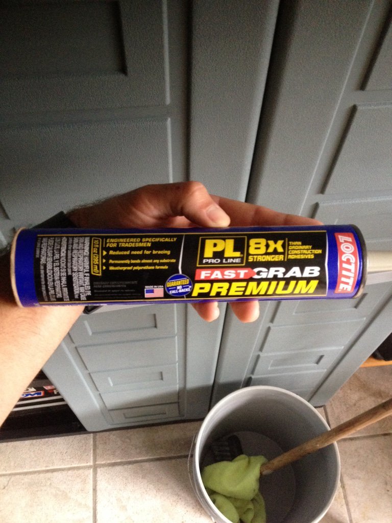

    Used this to glue the plexiglass
