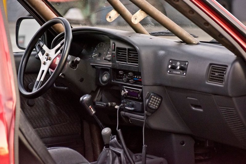

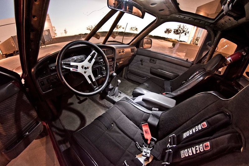

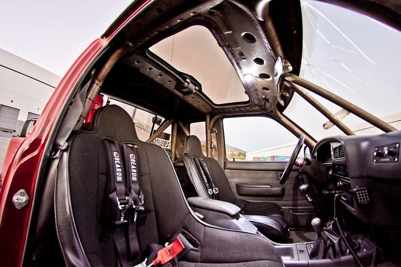

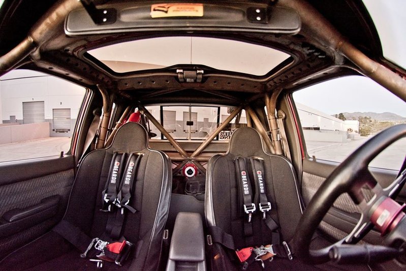

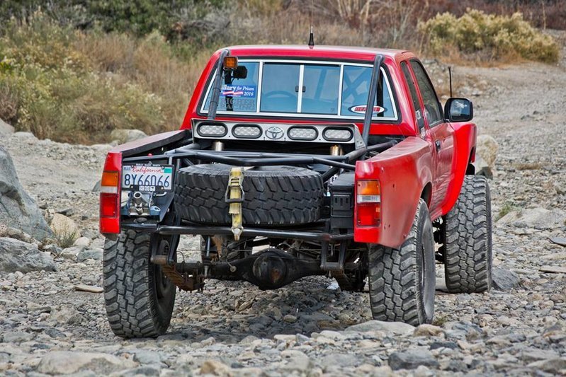

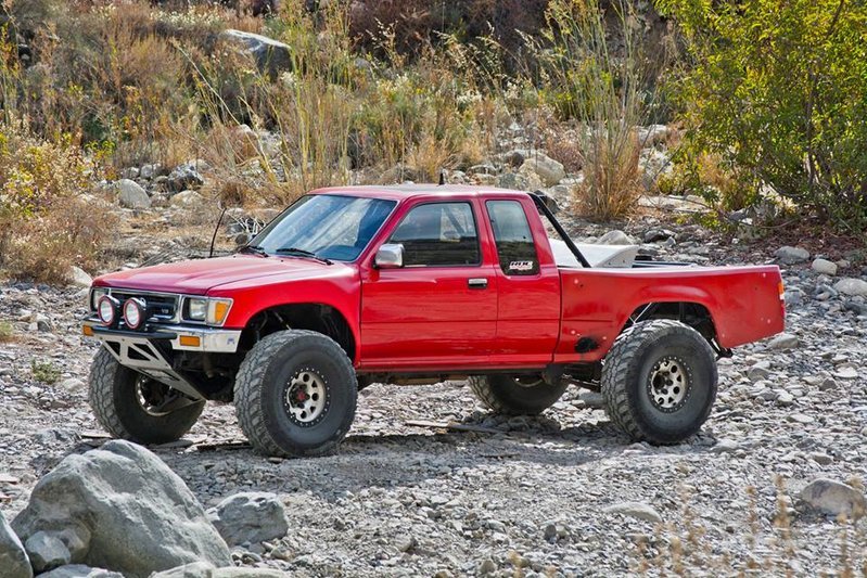

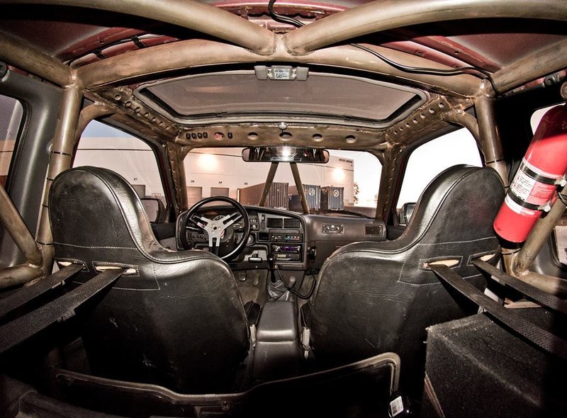

    Yes, I traded my 05 single cab Prerunner for this truck, and of course, people demanded a new build thread. No, not a Tacoma. But it'll fit in just fine around here I think. Truck was a single owner vehicle, owned by an old lady and was 100% bone stock when the last owner got it. He is a fabricator at Richer Racing here in Oceanside, CA. The truck was built over the last 6 years or so.
    1991 Toyota Pickup Ext. Cab Short Bed SR5 4x4
    "Scarlett"
    3.0 V6 - 5 speed manual
    222k miles on original heads, has had ever recall known to Toyota

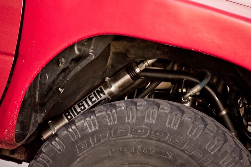

    Suspension:
    Total Chaos Caddy kit w/ Sway Away Torsions
    Bilstein 9100 Reservoir shocks with finned reservoirs
    Deaver F67 leaf pack
    Bilstein 4-tube bypass rear shocks
    Wheels/Tires:
    KMC Beadlocks with matching spare
    BF Goodrich Baja T/A DT with matching spare
    Body/Chassis:
    Full cab cage 2" 4130 Chromoly main tubes, 1.75" DOM .120 wall gussets and supports
    Bed cage and spare mount 1.75" DOM .120 wall tube
    5 Gallon fuel can mount
    Floor jack mount
    Ammo can for fluids/small tools
    Custom front prerunner bumper
    Interior:
    PRP race seats
    Beard 5 point harnesses
    10" Subwoofer/amp
    Kenwood head unit
    Grant Racing steering wheel
    Communications:
    PCI Race Radios Kenwood 110W race radio
    PCI Race Radios driver/passenger intercom with headset pigtails
    Push to talk wired for driver/passenger
    Lighting:
    7" HID Red Ring lights
    Amber LED pod dust light
    Aluminum LED Light box for tail lights and brake lights
    I've also acquired a 2004 Tacoma 5VZ-FE 3.4L motor, and almost all the parts needed to perform the swap. Surprisingly, this is one of the easiest swaps I've ever seen. Motor mounts, transmission, and many other parts bolt directly to the 3.4L, I need to fabricate the exhaust crossover pipe and a pass. side tab for the solid motor mount.
    After the new motor is dropped in, I plan to buy a Magnuson Supercharger and 7th injector kit for the 3.4L to push it over the edge. This will give me great power on the road, and in the dunes.
    Well that's all for now! I'll try to update as the motor swap process comes along. I plan to begin the swap shortly after New Years.

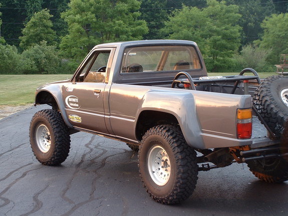

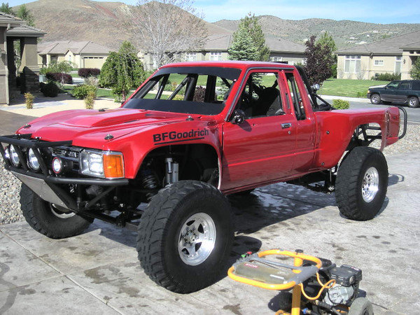

    That is a beautiful truck. It looks like something you'd see in the LCE Performance catalog. It also makes me think it's time for polished aluminum wheels to make a comeback.

    nice, IDK what you paid for it but i can guarantee you paid less then the cost to build it. I like these style trucks

    I love the wheels, a great classic look by far. My goal is to keep the truck looking period-correct, yet have all the performance aspects of a modern desert truck. Thanks for the kind words!
    Definitely less haha, I actually got it on a trade deal for a 2005 single cab prerunner that had an LT kit on it. My old truck was worth about $12,000.
